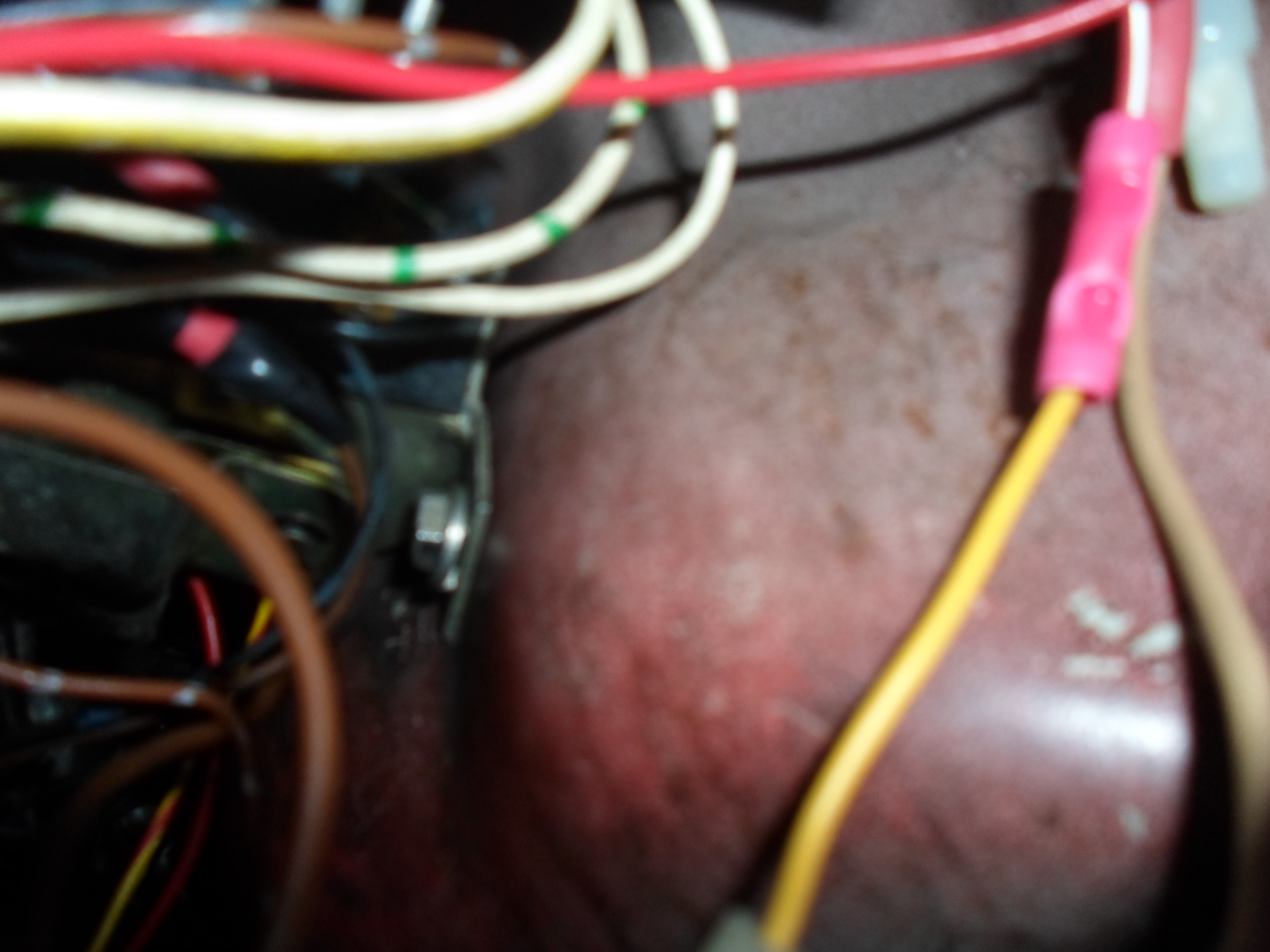

Gotta get your head really in there!!! Here's a pic:

QUOTE(AvalonFal @ Oct 13 2014, 05:19 PM) *
Thanks Paul! I finally see the SOB! I was looking in the wrong spot. I figured it would be on the dash sheet metal, but it's hooked up to the far wall (but you knew that already (IMG:style_emoticons/default/smile.gif) ).
