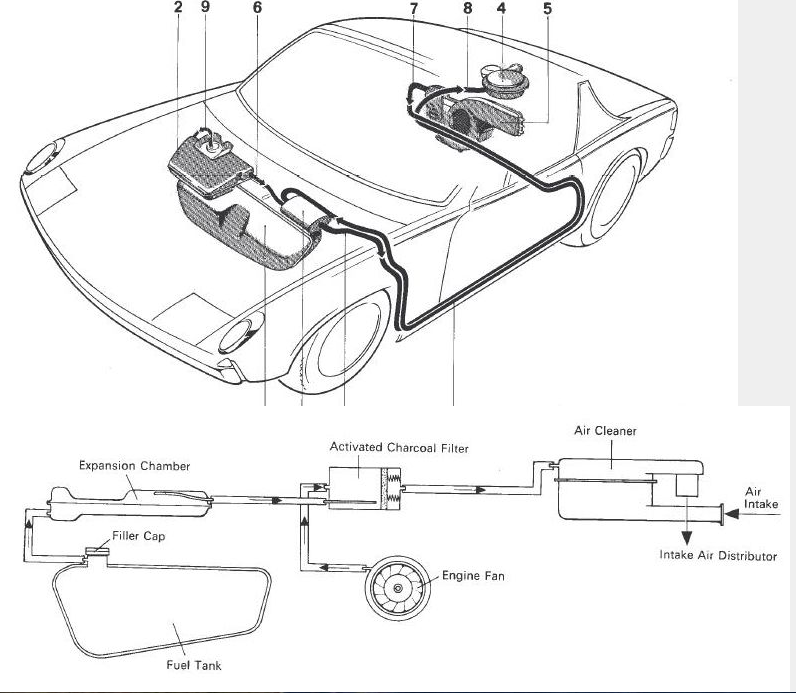

So, using the diagram below, I have no fan (Blow) power so to speak. I have a radiator with electric fans on them for cooling (Remember I have a renegade). I could easily create an inlet into my air cleaner for the final run but what would I use for that fan power?

Wondering how important flow from the fan (Stock 914) is? Do you think the system would run/ be efficient with suction from the air cleaner drawing that final leg? In addition I could run a hose up to the air inlet area (Front of the 914) near the radiator and air would be forced into the hose at speed.

Later 75s & 76s have a more modern setup. That 1/8" hose goes to a big black plastic box that surrounds the filler. Then a 1/8" hose goes from that, to a tube with the fuel lines, to the intake. It's all vacuum.
Modern cars have a switch so it only flows during idle.
The point is to capture the gas vapor so it doesn't enter the atmosphere. Run it to the carb, unless the manifold has a vacuum inlet.
There should be no fluid, just vapor.
I would think 40yo charcoal would no longer be activated, thus making it pointless to install.
The 70s and 80s were a horrible time for emissions solutions.
EDIT: 5v blower?

Run the little small vent line down the back and out the hole that the large spill line went through. Leave it hanging down an inch or so below the car to crest a Venturi effect.
It's old school and was like that up till the 70,s on lots of cars.
The way you have it now, the fumes are captive inside the front trunk and seeping into the cabin.

Yeah 5V...... small, quiet, low CFM and it has a 100,000 hour failure rating at 20 degree's celsius. Shipped to the house it's $15.00 and would supply a nice moderate amount of air into the canister. Everything else I looked at would blow like a son of a gun.
Hey thanks everyone. I got all my parts in from Parts Heaven and just need to attach the line going to the air cleaner and of course mount the small blower up front. I'm convinced that this "Stock" setup (less the small blower) will work just fine.
Dave

I was questioning the 5 volts part. Nothing in the car makes 5v so you would have to add a regulator gizmo to not kill it.
I would think you could find a 12v tiny blower on Mouser or Digikey.

Not sure that little guy will move enough air for you. It's spec'd for .57 CFM at .18" H20. Might be enough for a microchip in a laptop, but it's just gonna make noise in your car. Not sure exactly what kind of CFM you're going to need, but I'd shoot for something in the 2-5 CFM range. And 12 volts for sure.

I know..... .57 was exactly (or near) what I was wanting because I don't think the original fan push was much either. I bet I don't even hear it. Yes, getting from 12V to 5V is super simple and yes I checked my favorite place (Digi-key) and no I did not like the 12V blowers I saw. To much flow, larger and I would bet noiser.
For the record, with everything in place except the tiny blower, I filled her up. Ran it through the tests... (Left turn sharp, left turn sweeper and hard aceleration and stops and guess what? Not one wiff of gasoline.
Man I don't get this 12V thing. taking a device that runs 4-5 volts from 12V is nothing more than a tiny voltage regulator. There's a zillion sizes, types and brands. Oh well, to each their own.
Dave
