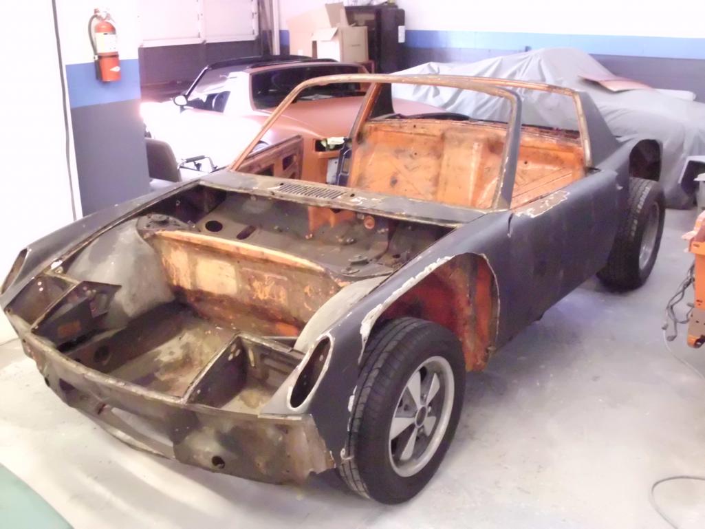

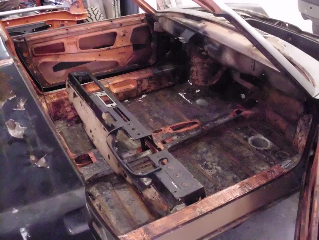

Hi all, I’m still a newbie here on world, I’ve made a few posts but have not yet formally introduced myself. My name is Kent and I have been restoring cars for over 20 years now. I did the reconstruction, body and paint on Andy’s (socalandy) 914-6. I immediately became hooked on 914,s and bought and built a 914 V8 conversion. I am starting a new restoration on another 914-6 so I will be posting pics of the progress as I go. The owner of this cars name is Jim and he has done a nice job of rounding up and restoring many of the parts thus far so this will no doubt be a nice car in the end. Andy (socalandy) posted a thread on this car a few months back and now it is in my shop and I’m ready to begin.

More pics

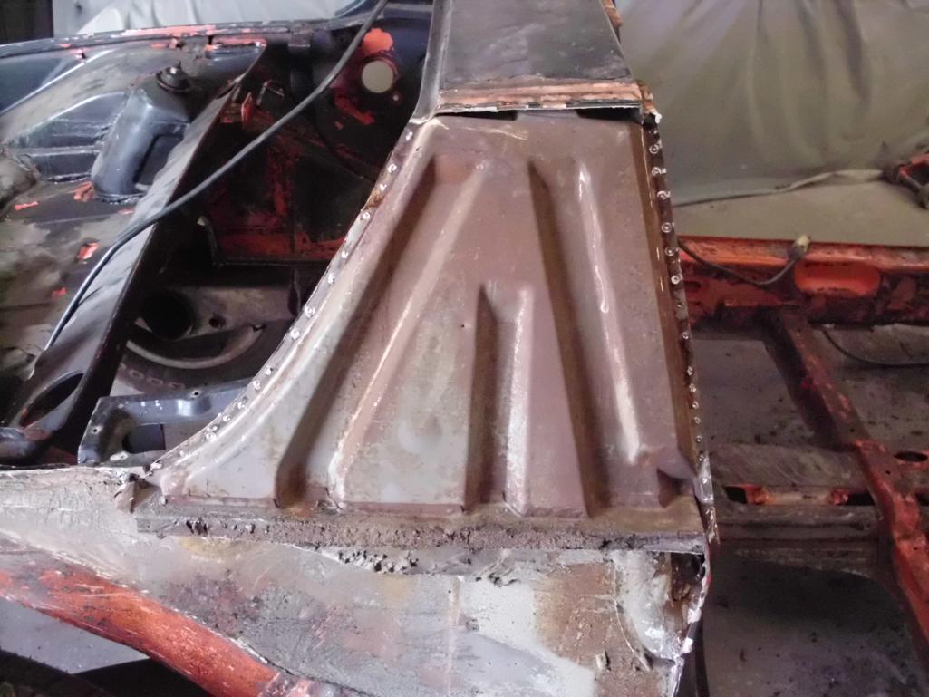

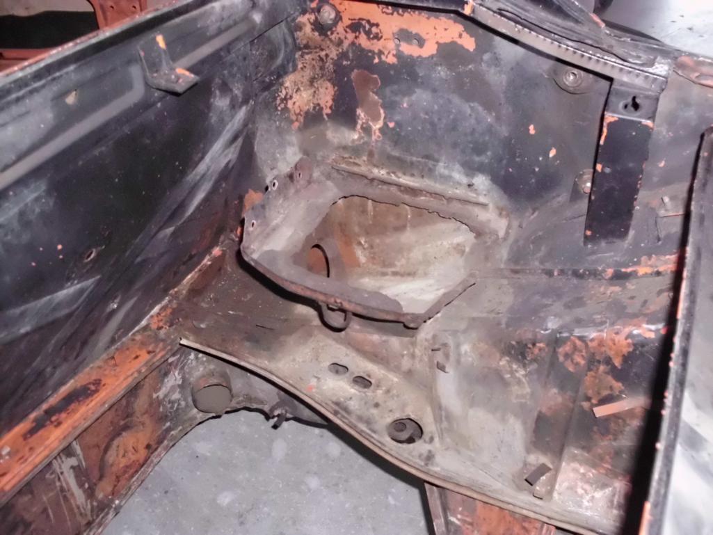

Member No.: 17,275
More pics.

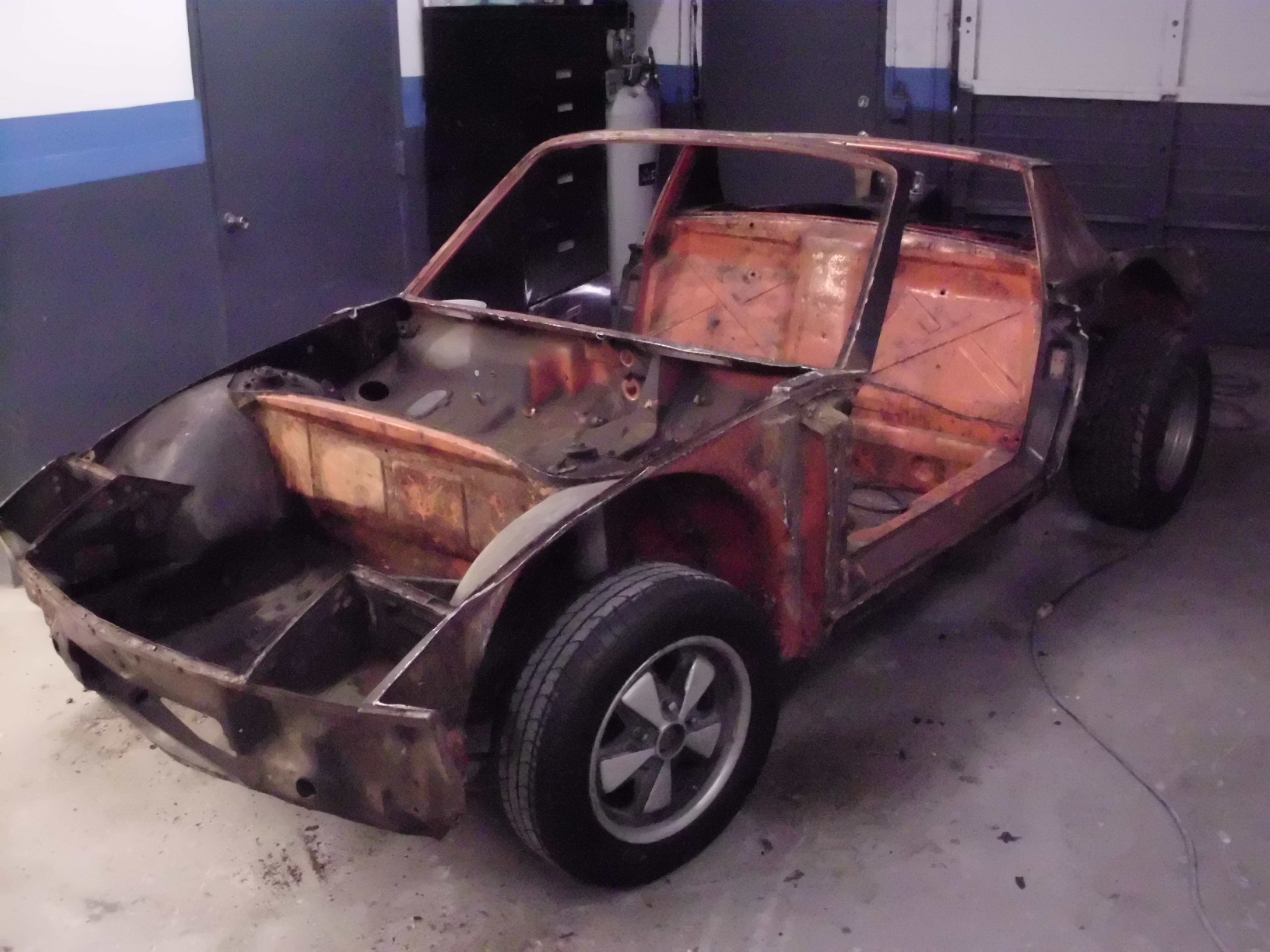

914350
post Oct 24 2014, 12:44 PM
Posts: 548
Joined: 21-April 14
From: Torrance Ca.
Member No.: 17,275

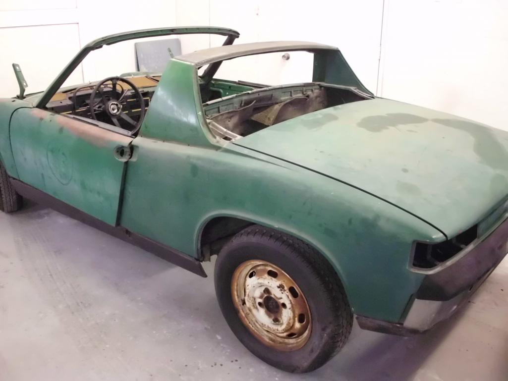

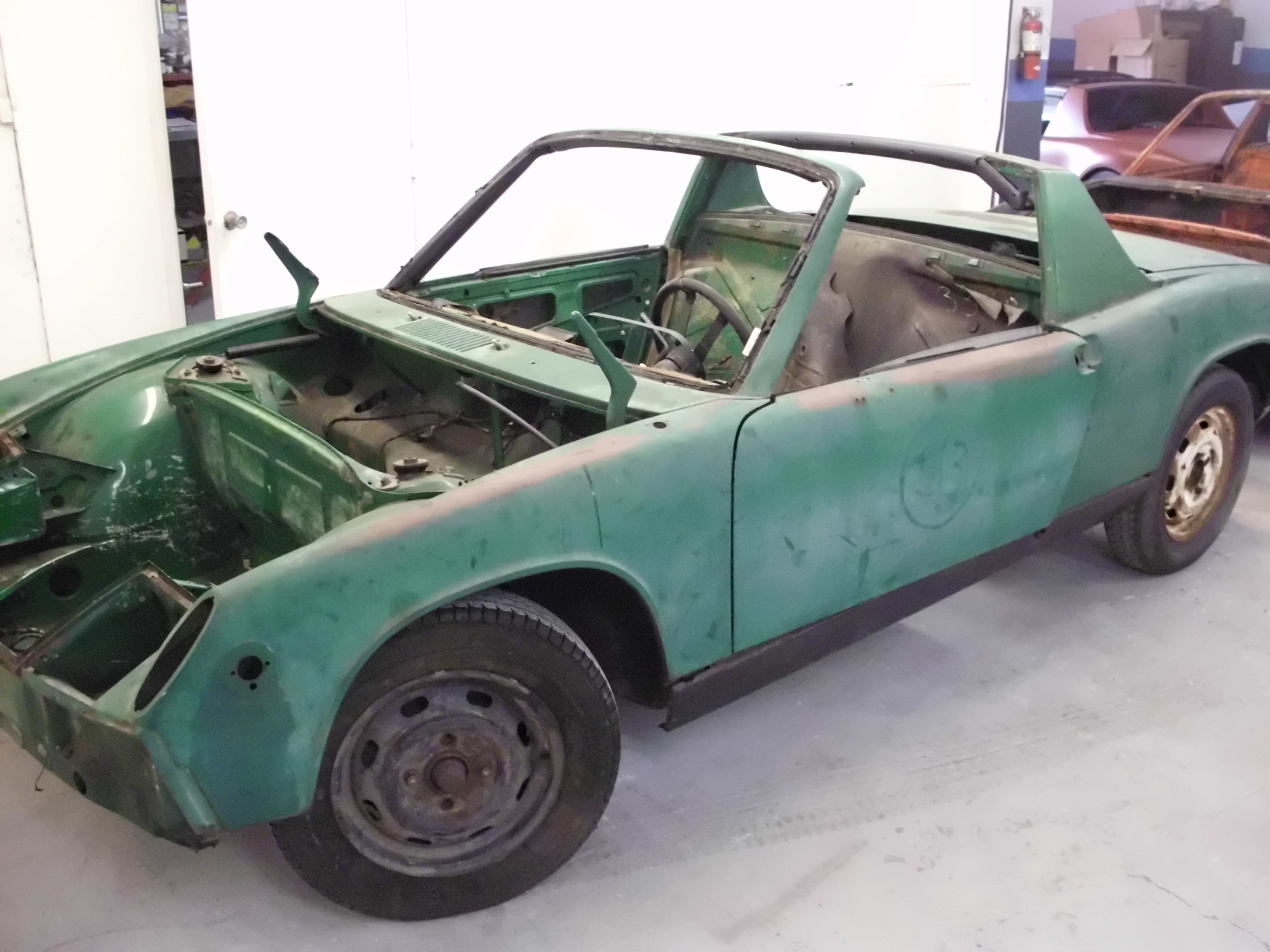

The Donor Car. R.I.P. I will be using the fenders and Quarter Panels from this car as well as some other areas/sections.

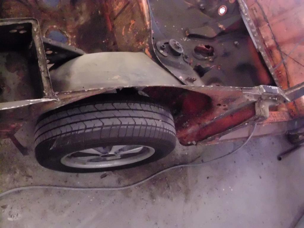

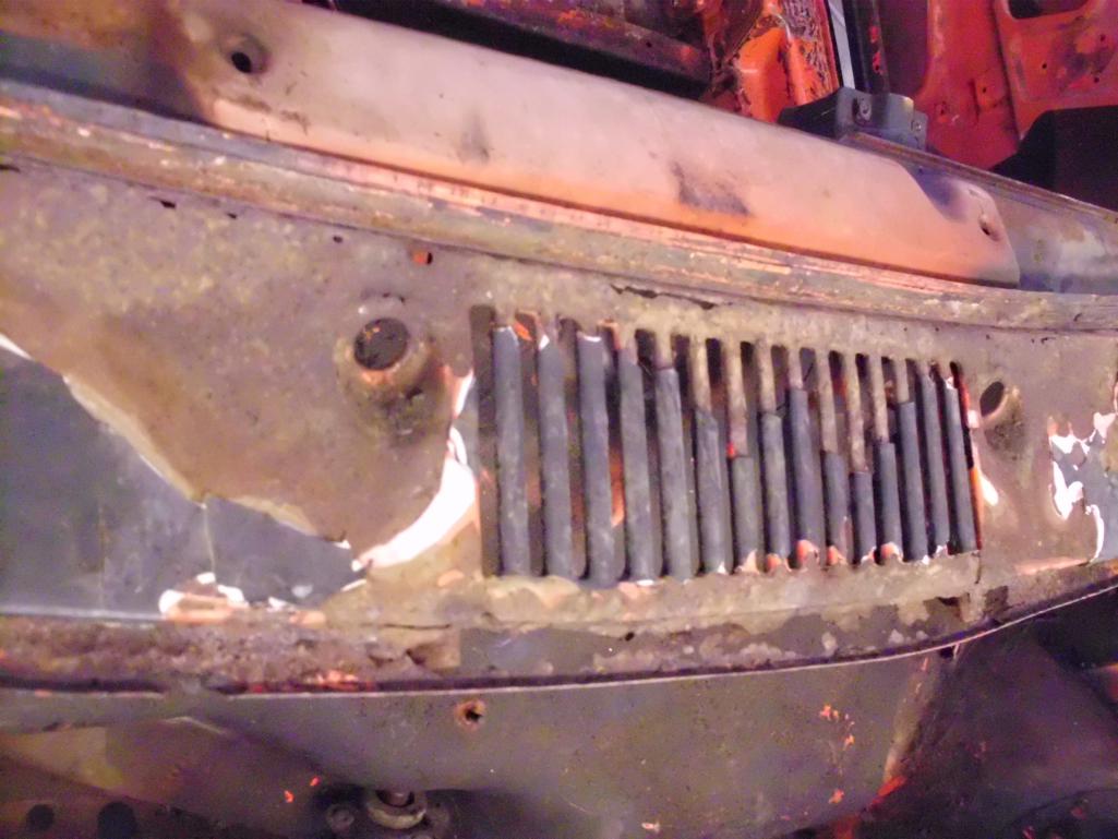

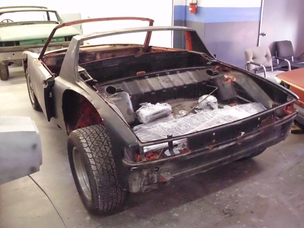

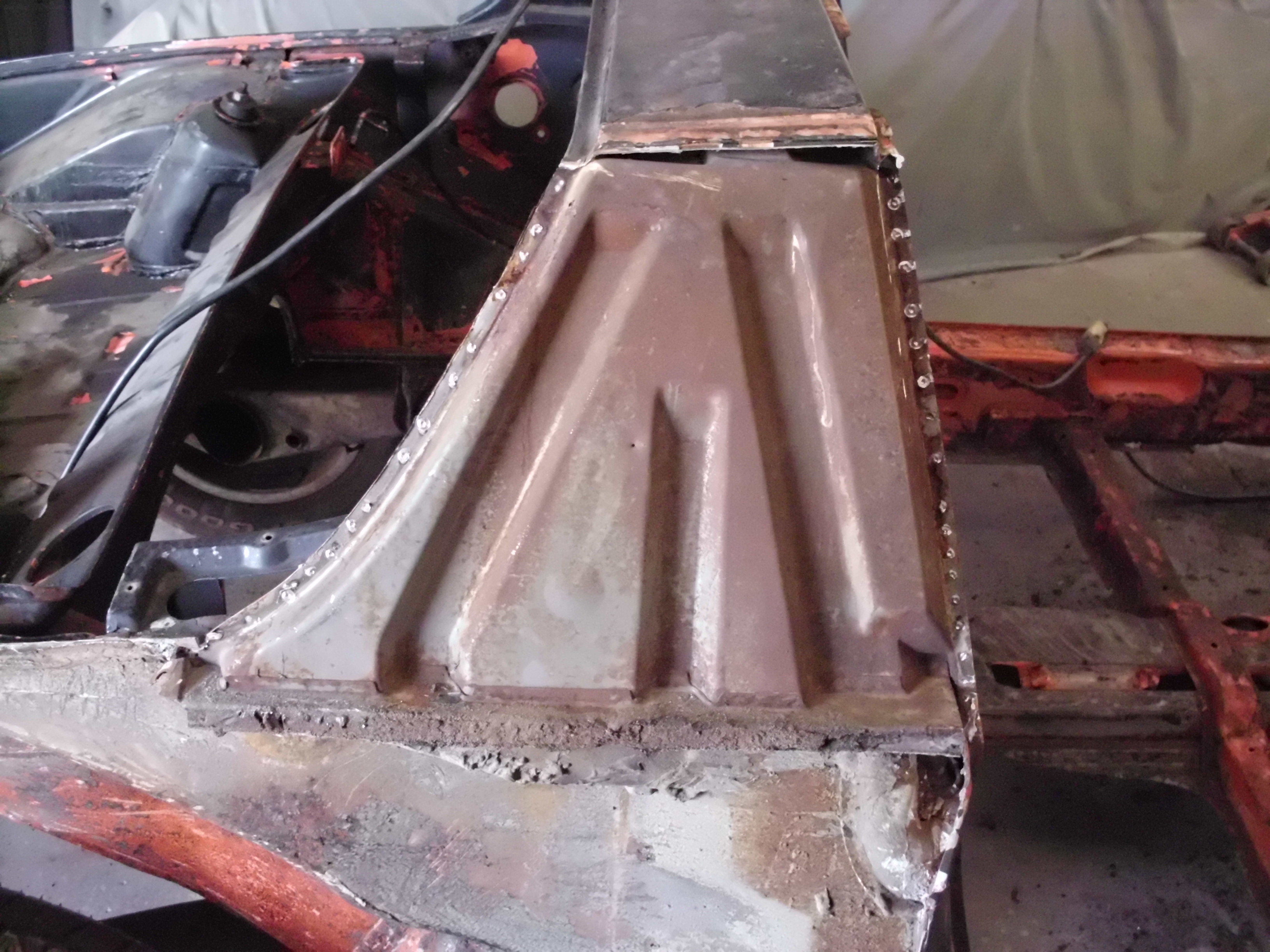

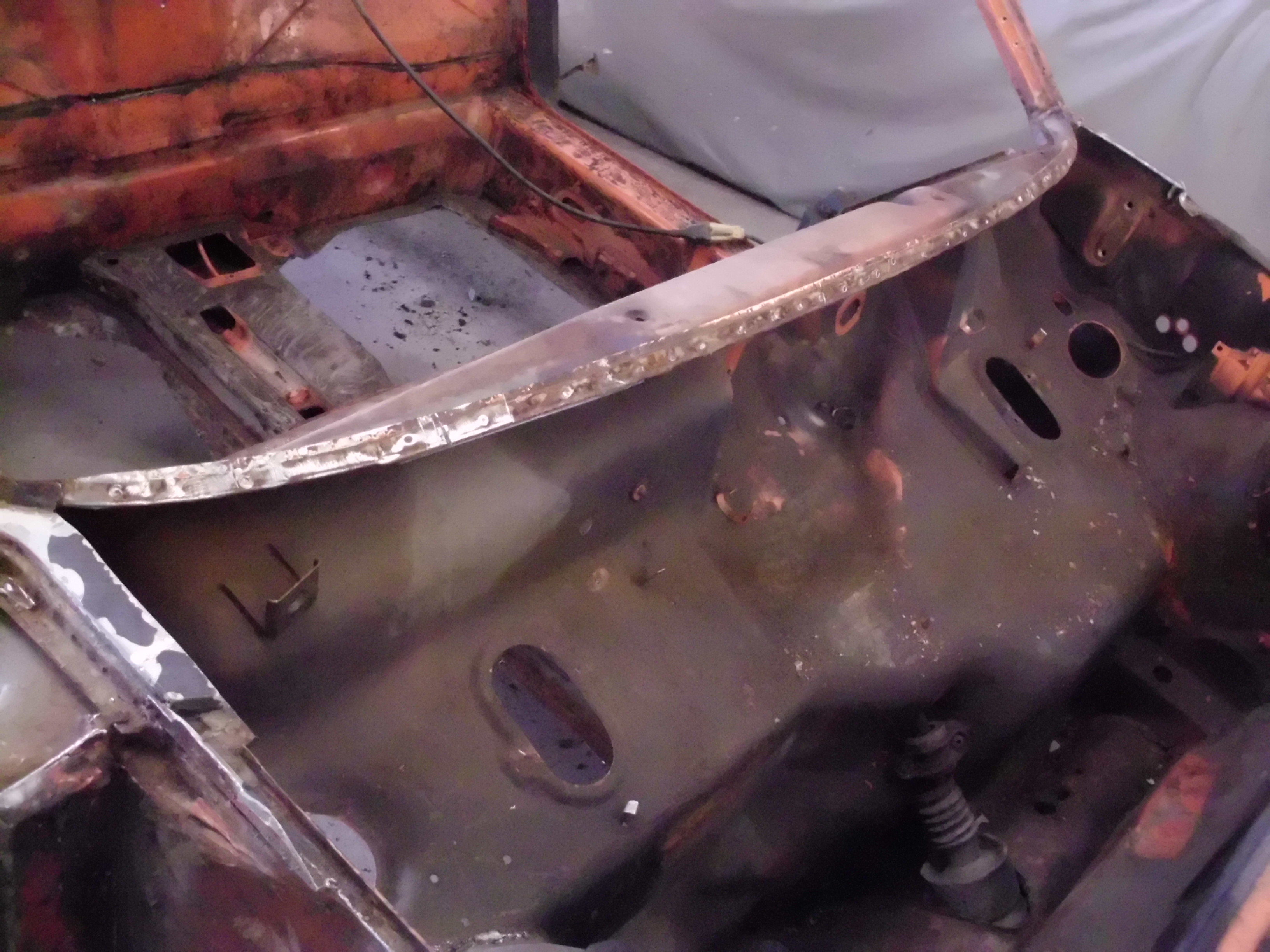

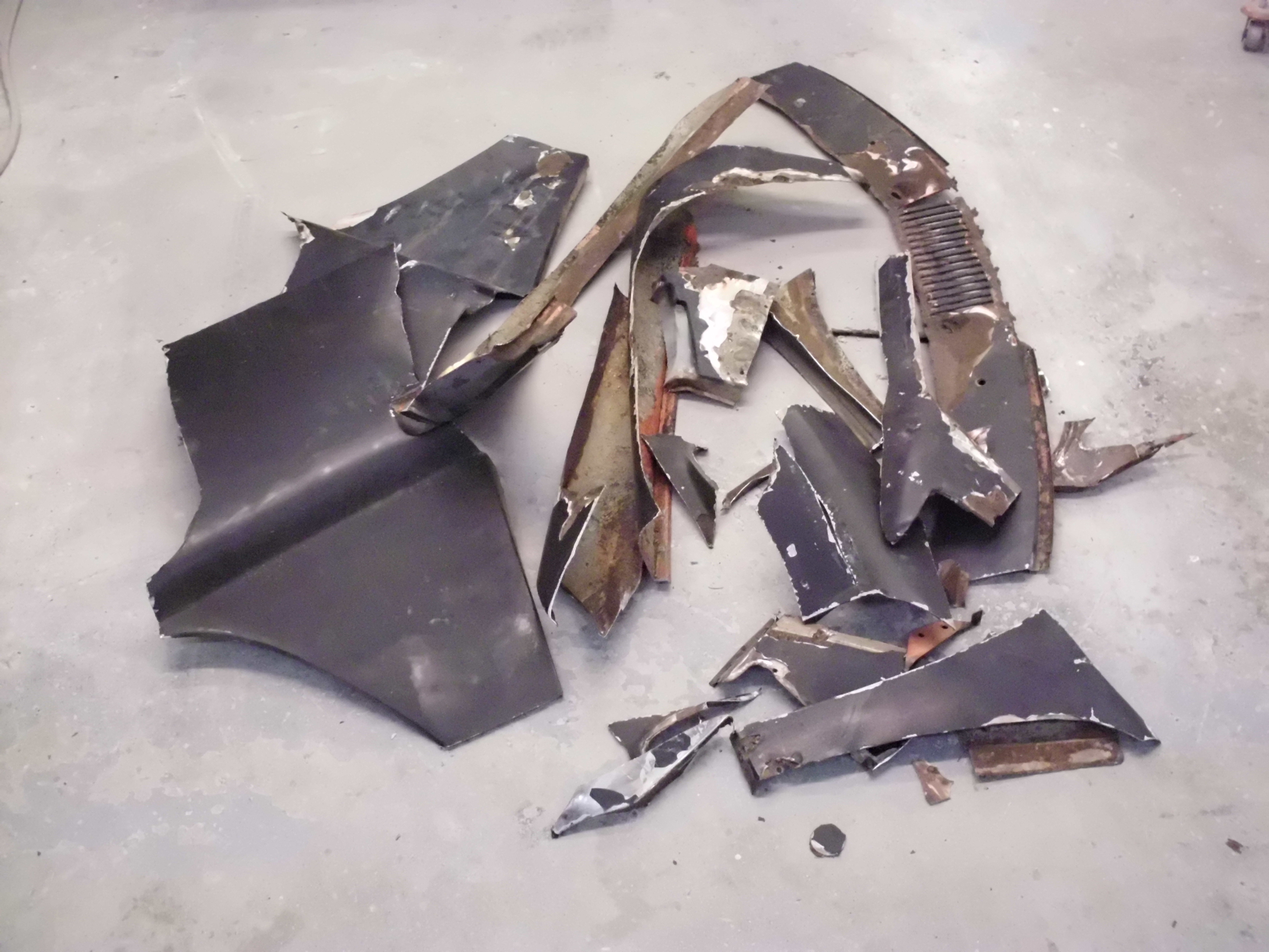

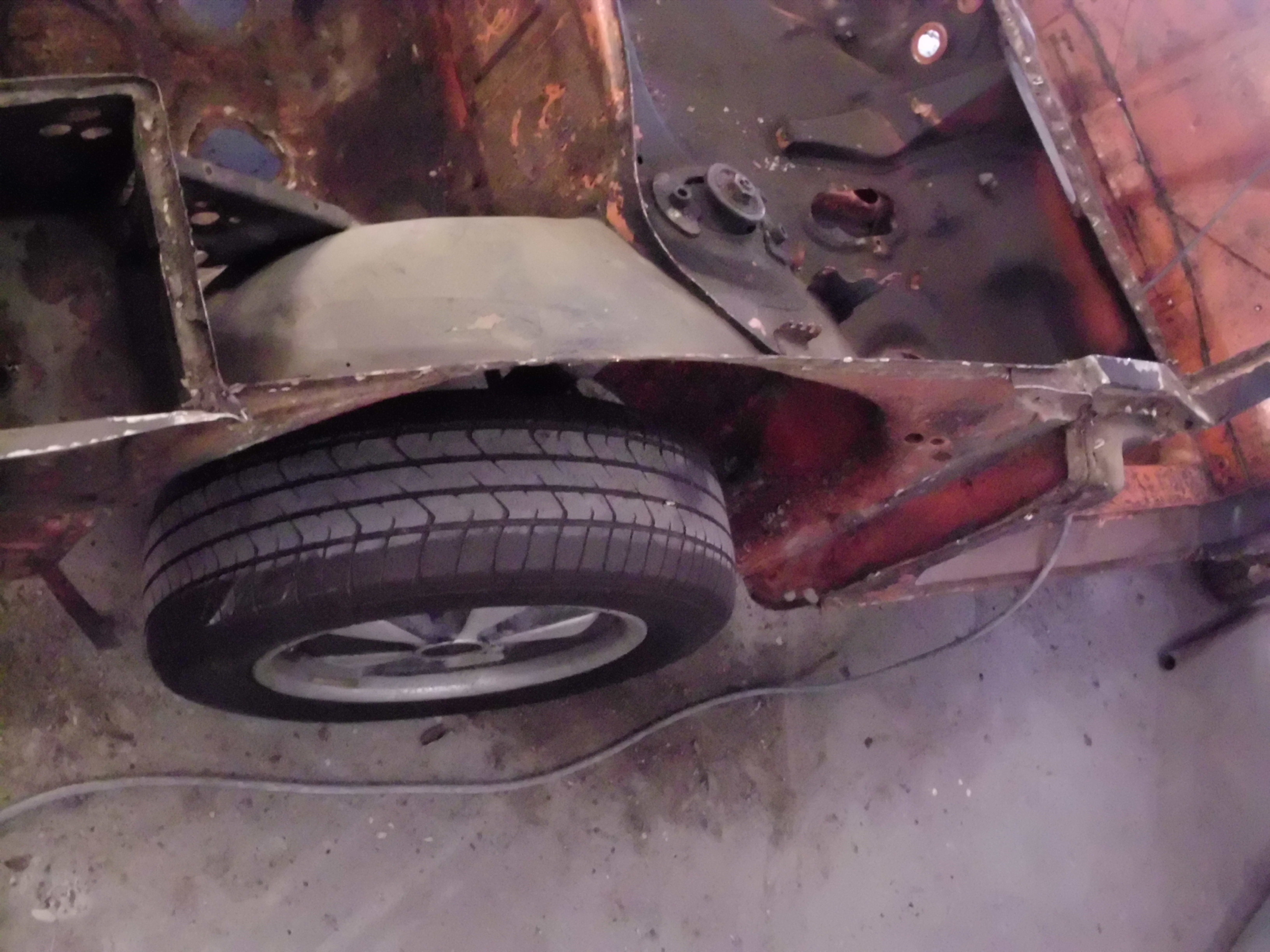

Spent today trimming the panels off of the car and getting it ready for media blasting.

post Oct 25 2014, 07:38 PM
Posts: 548
Joined: 21-April 14
From: Torrance Ca.
Member No.: 17,275
The inner Roll Bar structure is in great condition. Not rotted out on the lower area like they can be.

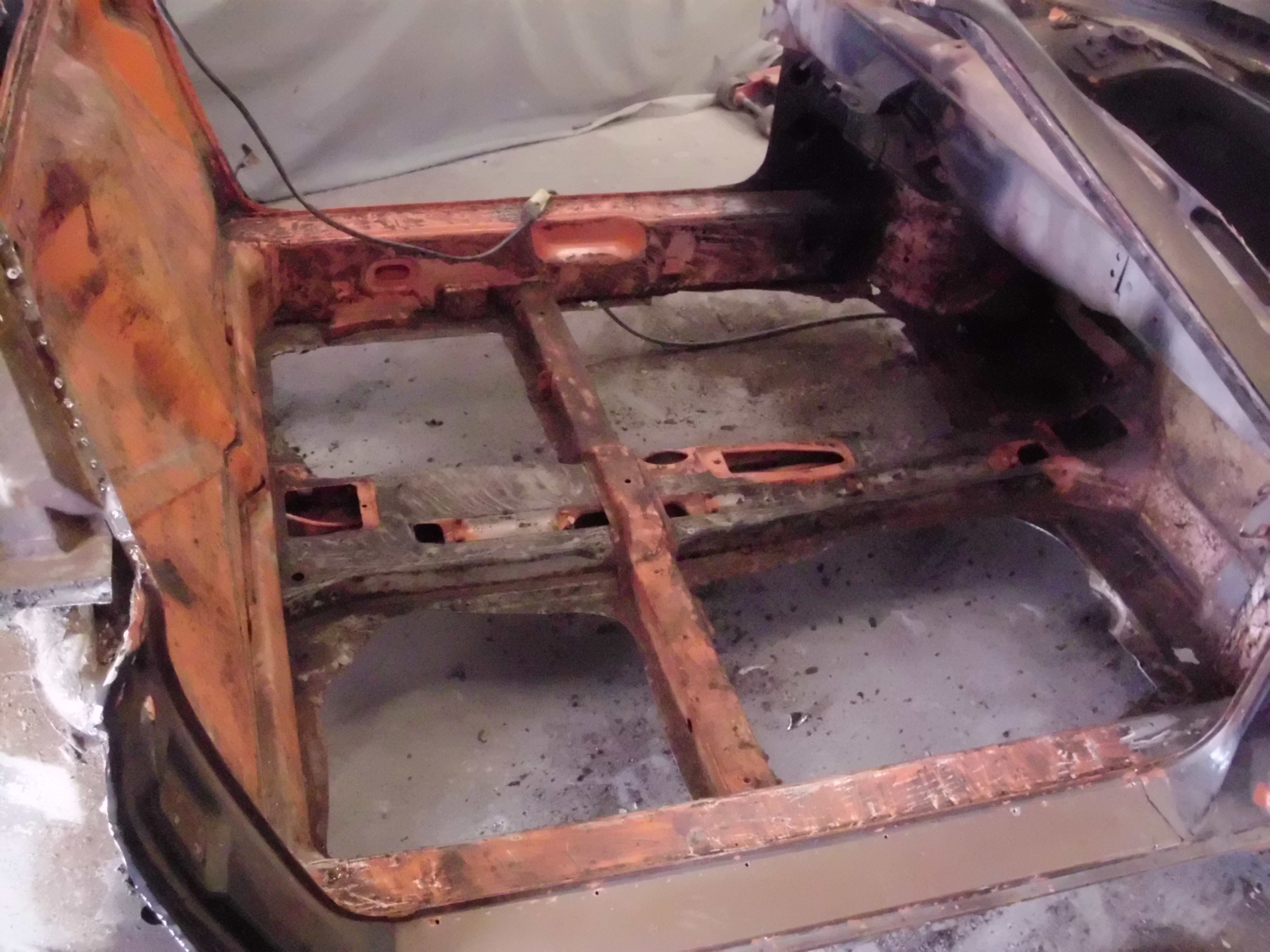

post Oct 25 2014, 07:44 PM
Posts: 548
Joined: 21-April 14
From: Torrance Ca.
Member No.: 17,275
More pics.

trojanhorsepower
post Oct 26 2014, 06:09 AM
Posts: 1,054
Joined: 21-September 03
From: Marion, NC
Member No.: 1,179

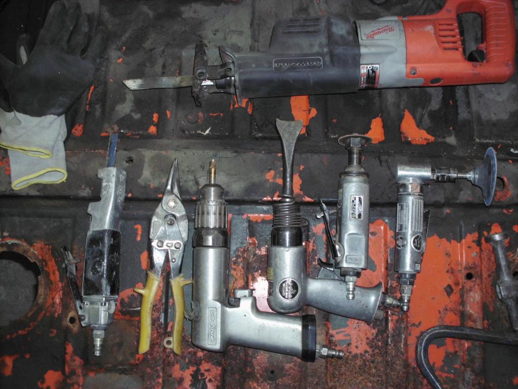

What did you use to remove the panels? What ever it was it seemed to go well.
914350
post Oct 29 2014, 08:09 PM
Posts: 548
Joined: 21-April 14
From: Torrance Ca.
Member No.: 17,275
QUOTE(trojanhorsepower @ Oct 26 2014, 05:09 AM) *
There's many different tools that are used, I use a sawzall/Reciprocating saw (large and small) and a cut off wheel to cut the panel back to the edges then a spot weld drill bit to help with separating the spot welds and even a air chisel at some points but being carful not to damage the lip/edge that the new panel will attach to. there's lots of different ways to go about it, sometimes the welds just snap loose as you twist the metal away.
