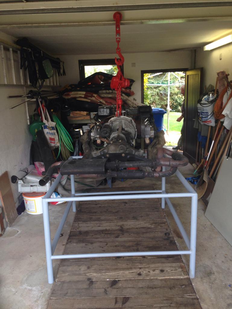

Hate to say it, but now that I have a lift I have a permanent strap wrapped around it and I lift up all sorts of stuff with it, including a wood stove to get it out of my truck and onto a dolly.

Hand crank winch and a pulley hanging off a rafter in my garage.
I'd not lift anything super heavy with it, but a T4? No problem.
Beats the hell out of ruining your back.

I got the cheap chain hoist at HF and use one of the exposed trusses in the roof of my garage. Also a cloth strap on either side of the engine, tied together into the hoist hook in the middle. Lifts it like it's nothing, and allows some freedom of adjustment to get it in my stand.
http://www.harborfreight.com/1-ton-chain-hoist-996.html
Wait for the 20% coupon in the mail and it's 40 bucks. Cheaper than a shop crane, and takes up way less space.
