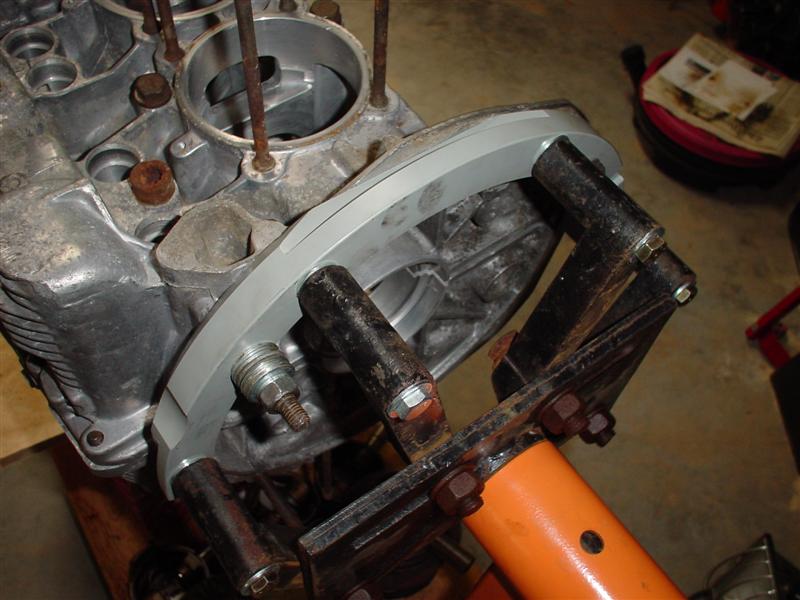

This may have already been covered, but I haven't had any luck figuring my problem out. I've got my engine pulled, tranny separated and the engine is on my ATV jack. I just bought an engine stand and now I can't figure out how to mount the engine to it headbang.gif The ATV jack won't raise high enough to get all 4 mounting points to line up. And, the base of the stand won't allow the stand to get close enough to the engine, due to the base of the jack.

You could take the yoke off the stand and over to the engine and bolt it to the engine and with a strong friend, put it in the stand.
or
You could buy the engine adapter offered by MainelyCustomByDesign (no affiliation) that will allow the use of your engine stand and mount a VW or Porsche engine. One good thing about using the adapter is that it will allow mounting the flywheel while the engine is mounted.

First off you need a porsche/VW head for the engine stand.
That head you have with the four arms will not fit and will rub against the flywheel....
It will also not mount flush unless you notch the ends of the tubes around the case.
For an answer to your question, remove the head from the stand and mount it to the motor.
Either get a helper, or some rope from above to balance things and tip the engine stand over until you can slide the large tube into the engine stand.

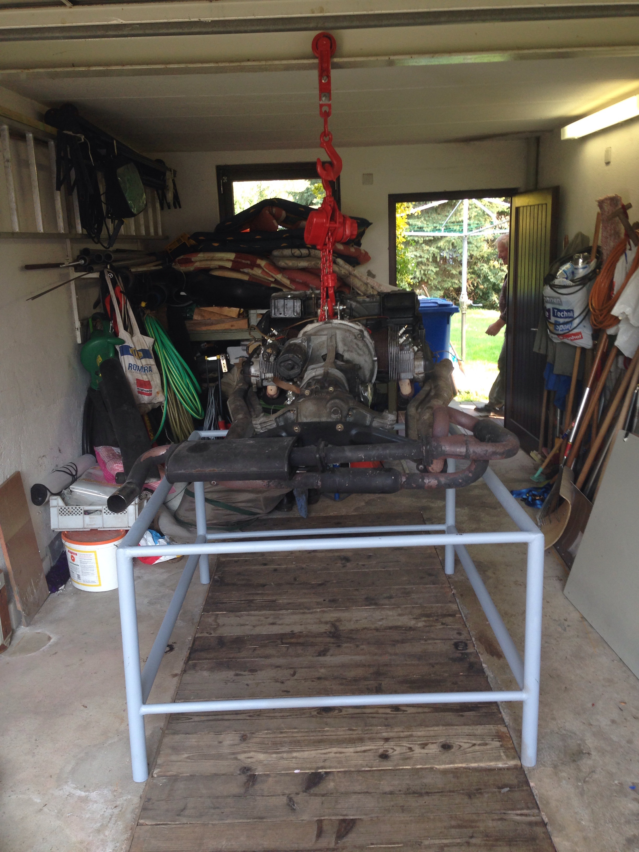

I use a chain hoist and an attachement to handle the load.

Hand crank winch and a pulley hanging off a rafter in my garage.
I'd not lift anything super heavy with it, but a T4? No problem.

I got the cheap chain hoist at HF and use one of the exposed trusses in the roof of my garage. Also a cloth strap on either side of the engine, tied together into the hoist hook in the middle. Lifts it like it's nothing, and allows some freedom of adjustment to get it in my stand.
http://www.harborfreight.com/1-ton-chain-hoist-996.html
Wait for the 20% coupon in the mail and it's 40 bucks. Cheaper than a shop crane, and takes up way less space.
