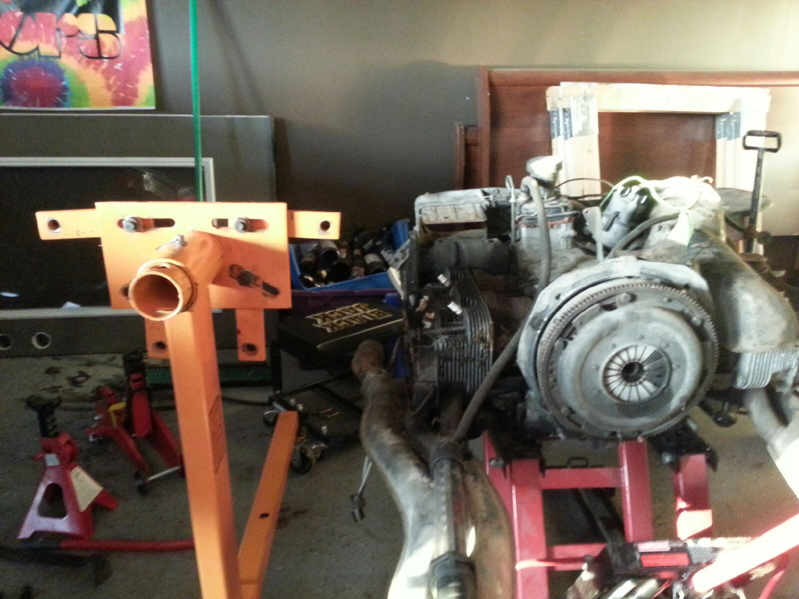

This may have already been covered, but I haven't had any luck figuring my problem out. I've got my engine pulled, tranny separated and the engine is on my ATV jack. I just bought an engine stand and now I can't figure out how to mount the engine to it (IMG:style_emoticons/default/headbang.gif) The ATV jack won't raise high enough to get all 4 mounting points to line up. And, the base of the stand won't allow the stand to get close enough to the engine, due to the base of the jack.
Anyone have any tricks they could share?

First off you need a porsche/VW head for the engine stand.
That head you have with the four arms will not fit and will rub against the flywheel....
It will also not mount flush unless you notch the ends of the tubes around the case.
For an answer to your question, remove the head from the stand and mount it to the motor.
Either get a helper, or some rope from above to balance things and tip the engine stand over until you can slide the large tube into the engine stand.
Then slowly tip it upright.

Seeing as you have a three wheel engine stand, you could raise and block the motor, then raise and block the jack, leaving a hole in the middle for the engine stand leg.
Keep doing that until it's at the right height to allow you to slide the engine stand under the jack, right up the the motor.
Remove the heat exchangers
Turn the motor sideways on that lift to avoid the handle.

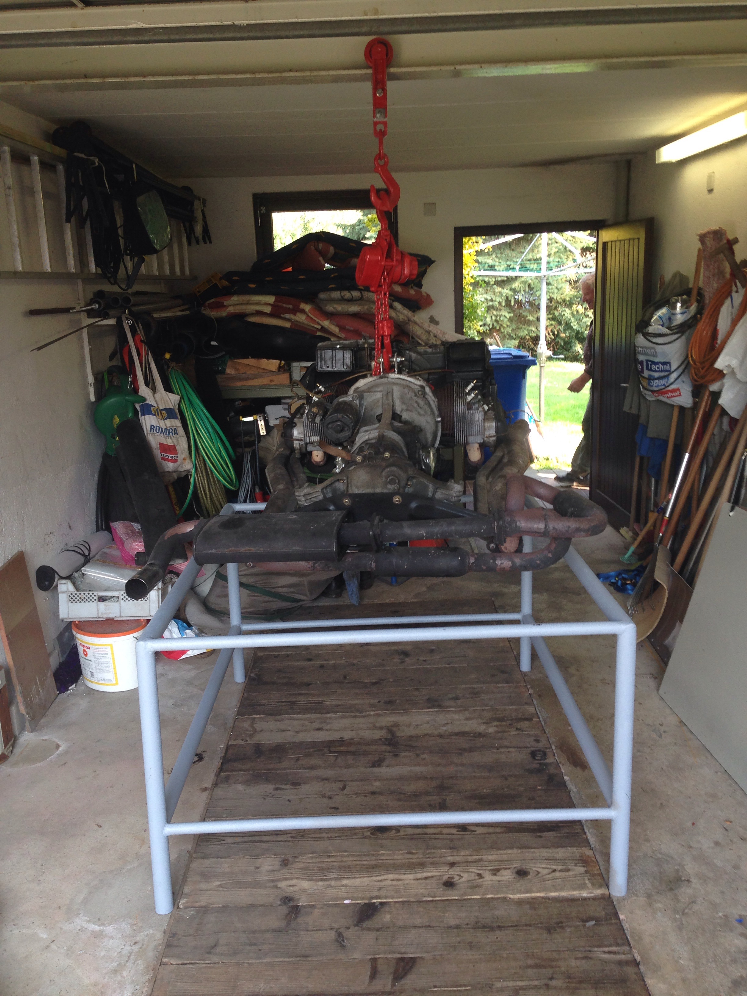

I put a sling around the engine. Install engine holder. Throw a chain around tree limb, attach wench, and jack it up to the right height. Slide engine holder into stand. Remove all the hardware and roll it in to garage. True backyard mechanic style! (IMG:style_emoticons/default/biggrin.gif)

I use a chain hoist and an attachement to handle the load.

I got the cheap chain hoist at HF and use one of the exposed trusses in the roof of my garage. Also a cloth strap on either side of the engine, tied together into the hoist hook in the middle. Lifts it like it's nothing, and allows some freedom of adjustment to get it in my stand.
http://www.harborfreight.com/1-ton-chain-hoist-996.html
Wait for the 20% coupon in the mail and it's 40 bucks. Cheaper than a shop crane, and takes up way less space.
