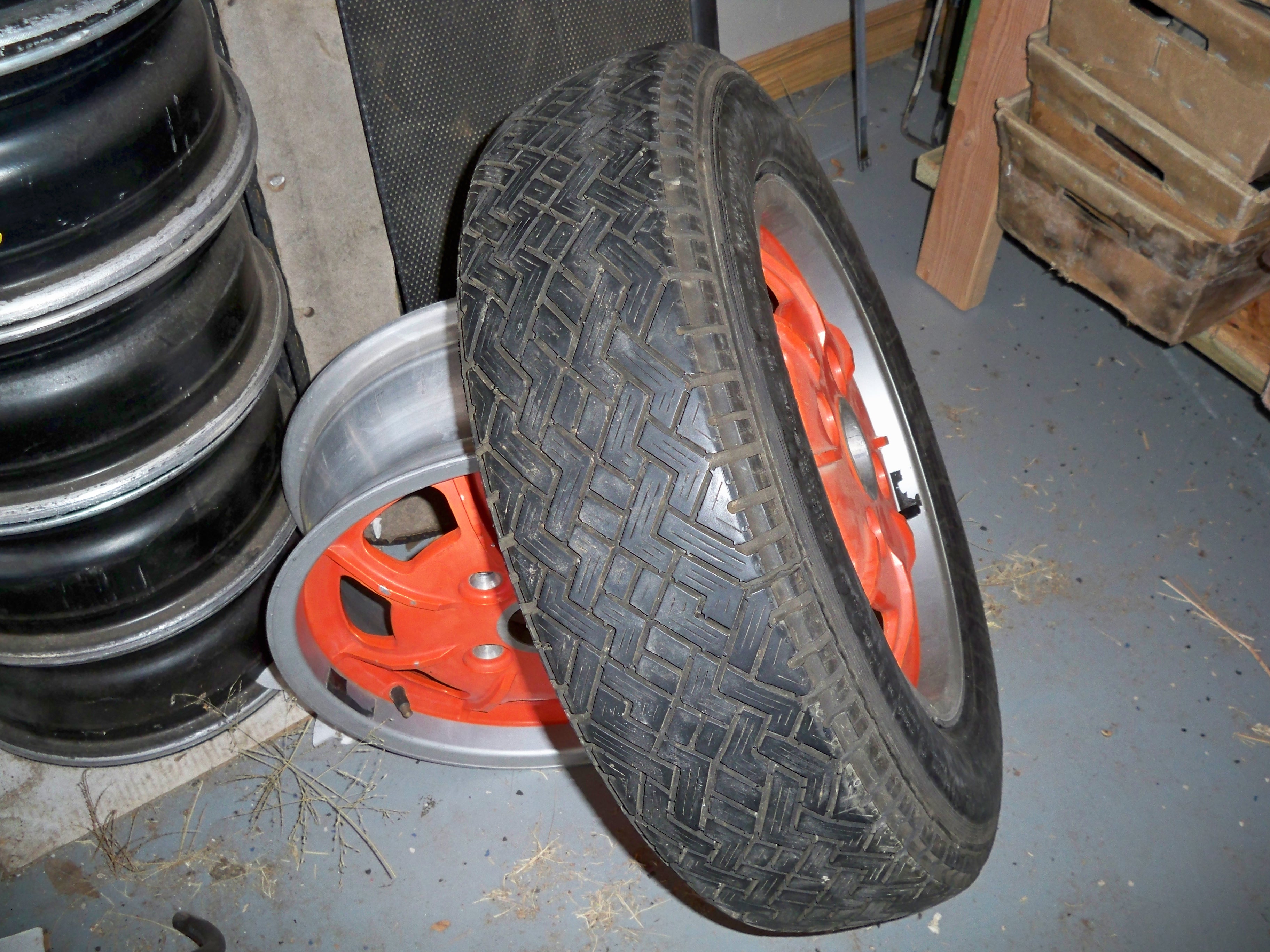

I remember seeing these (Continental) on 914's tho I can't tell you which year.
I got the wheel from a junk yard. I don't remember where I got the tire but it looks brand new so I had to mount it. They were the coolest looking tread and I sure wish they were still around.
