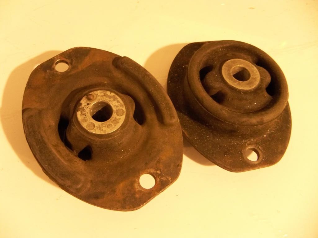

I have a late bar. The transmission and side shift set up are new to the car and have never been installed/run. That's part of the issue. Seems like going with a 100% late set up is the way to go.
With that said, sounds like I'm in the market for a set of mounts to attach the bar to the body. Engine to bar is all squared away.

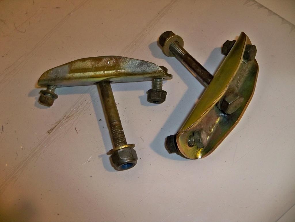

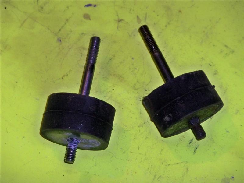

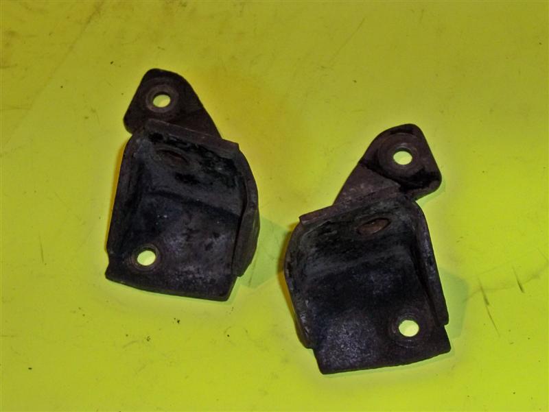

This is what I have.
This is what I need?

Mike
You have what you need to mount the bar to the body. There are no mounts used at the end of the bar. If you need the rubber mounts that attach to the engine mounts and bar buy them new. Used ones get wedge shaped.
