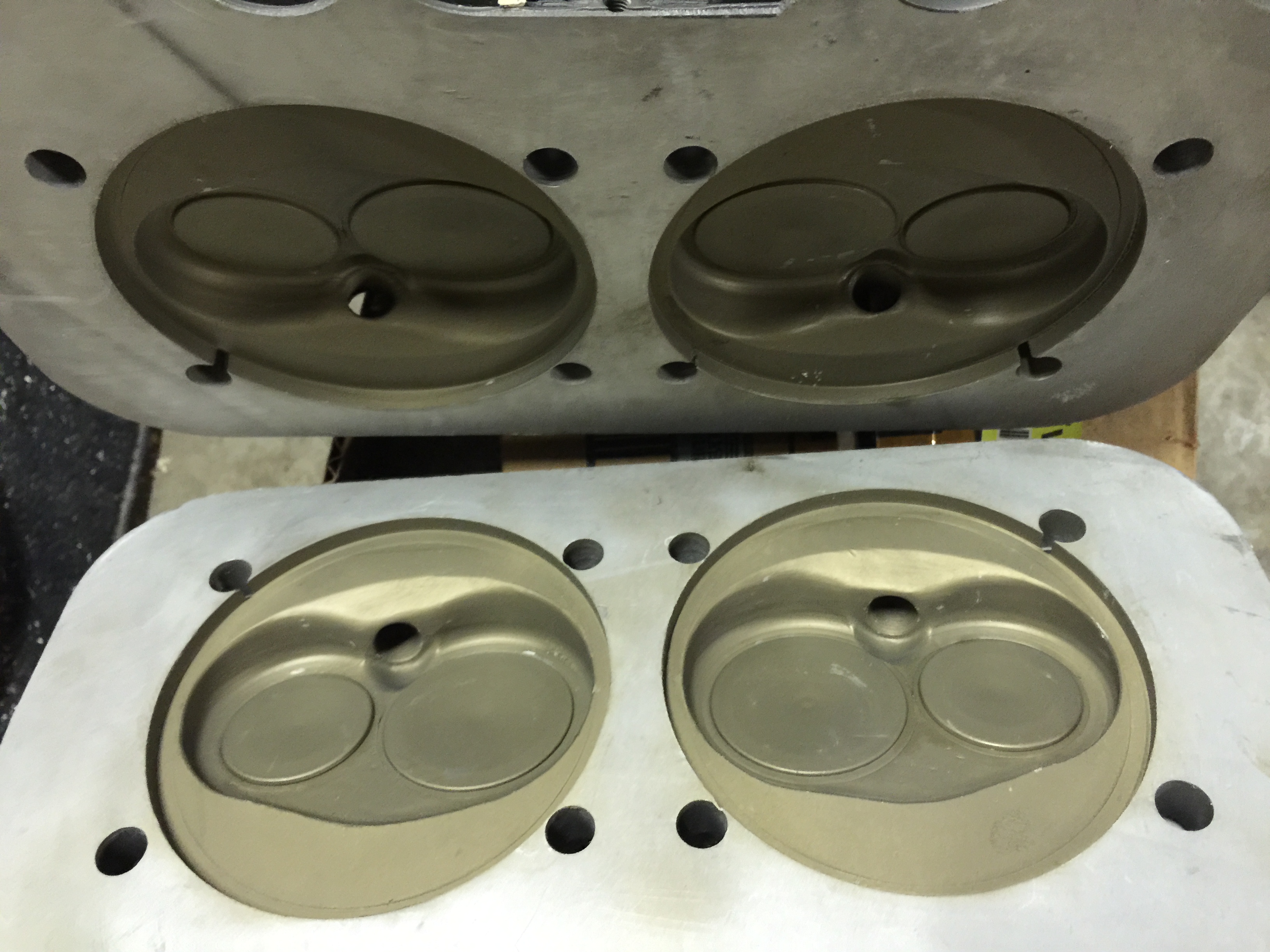

This is the information I found on the internet...Is this correct? What are they worth?
021 101 371S ... 39.3mm Intake X 34mm Exhaust. FI head ('74 1.8L)

another view

914 1.8 "S" heads, the best 1.8 head.
Those heads have been flycut, if I was buying I'd want to know the chamber size.

Ceramic coated combustion chambers?

To my untrained eye they look like they were glass beaded and no other work was done.
IC a ridge where the cylinder meets the head, and it down not appear to be even.
I see stains where the washers hold down the hyped nuts.
Don't appera to be new, nor reworked to me.

I do not like the look of the chambers being cut through the stud holes.
Is that common? I have never seen that before.

It is if they are oversized.

The register bumps are gone, the head has been milled flat, you do that for fly-cutting the head.
If you fly-cut it too deep you have to cut the bumps off so the head won't hit the top fin of the cylinder.
QUOTE(wndsnd @ Dec 6 2014, 10:40 PM) *
John
Good catch I missed that, they are cut for 103mm.
That's why the heads are fly-cut.

If the heads are fly cut for 103mm, what size engine were they intended for?

71 X 103 = 2366
QUOTE(SLITS @ Dec 7 2014, 08:07 AM) *
71 X 103 = 2366
Guessing a bit but IIRC 78X103mm was about 2650 and I know 80X103mm is a 2.7L
