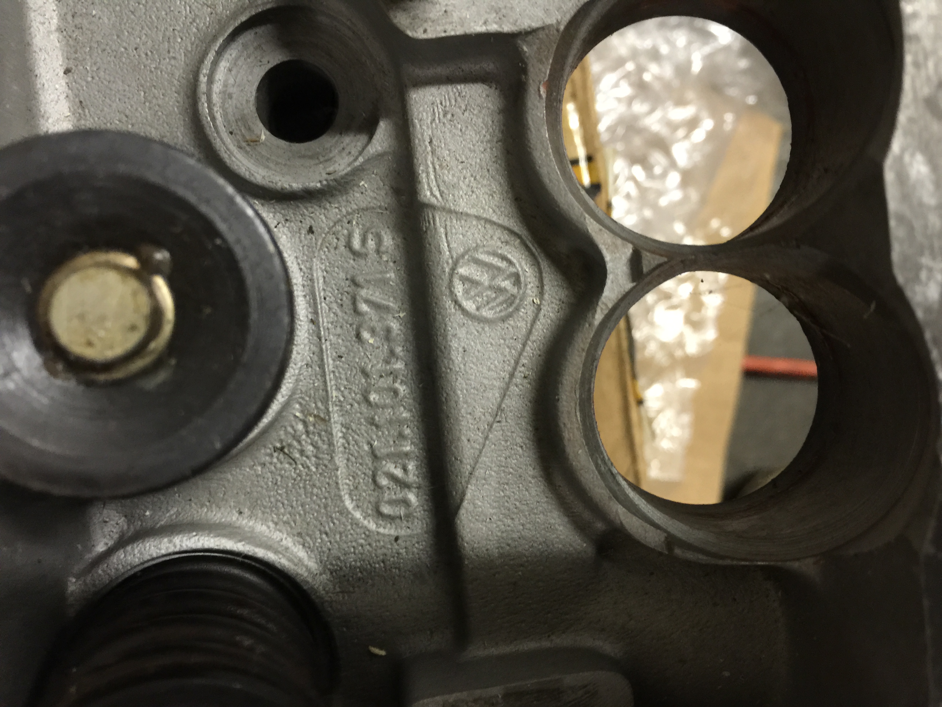

This is the information I found on the internet...Is this correct? What are they worth?
021 101 371S ... 39.3mm Intake X 34mm Exhaust. FI head ('74 1.8L)

914 1.8 "S" heads, the best 1.8 head.
Those heads have been flycut, if I was buying I'd want to know the chamber size.

Ceramic coated combustion chambers?
r_towle
To my untrained eye they look like they were glass beaded and no other work was done.
IC a ridge where the cylinder meets the head, and it down not appear to be even.
I see stains where the washers hold down the hyped nuts.
Don't appera to be new, nor reworked to me.

I do not like the look of the chambers being cut through the stud holes.
Is that common? I have never seen that before.

It is if they are oversized.

The register bumps are gone, the head has been milled flat, you do that for fly-cutting the head.
If you fly-cut it too deep you have to cut the bumps off so the head won't hit the top fin of the cylinder.

Good catch I missed that, they are cut for 103mm.
That's why the heads are fly-cut.

If the heads are fly cut for 103mm, what size engine were they intended for?
SLITS
71 X 103 = 2366

Guessing a bit but IIRC 78X103mm was about 2650 and I know 80X103mm is a 2.7L
