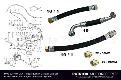

On a Factory 6 there is 3 rubber hoses and one steel return pipe.
You have two hoses that go from the bottom (feed) of the tank to the oil cooler on the engine. On the return side it's steel from the engine to the left engine shelf then the rubber hose connects it to the return side of the oil tank. Only other lines on the tank are for the breather and over flow.
PMS sells a new 3 rubber line set for $270.00

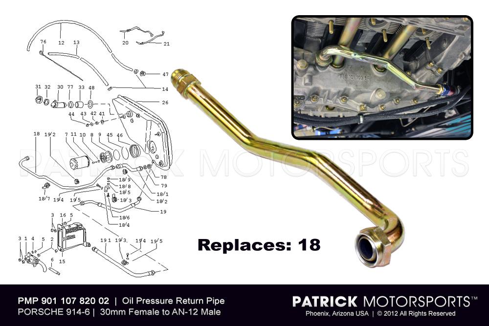

Unless you already have the 914-6 steel return line then yes you will need one.
You have two options here. You can go with a factory 6 line or a PMS modified line.
Only thing with the PMS steel line is you would need a longer rubber return line back to tank. I've seen people run a rubber return line straight from the engine to tank but I don't like that. The steel return line is meant to help with the heat from the headers.

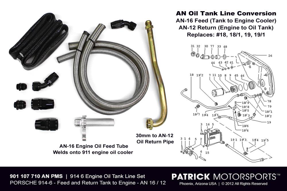

PMS also sells a AN oil line conversion kit.

I debating which way to go, stock or a bit cheaper (hopefully) custom using adapters to AN fittings and hose.

It's not that difficult to make your own AN lines. The adapters and fittings will get expensive though.

I'd use the Patrick Motorsport steel line as it gives you options on adding a future cooler if needed by easily swapping out some small AN hoses. If it's going to be a track car, AN-16 lines would be better, but $$$ and harder to run to the front. AN-12 lines can be made up at home.

I don't have the part number, but there is a 911 flexible line that replaces the hard line (18). It goes all the way from the engine to the oil tank with no other connections. I have one and used it for years.

Yes, but you would still need the 914/6 hardline around $400
Also the OE hardline may have issues with some aftermarket engine mounts.
