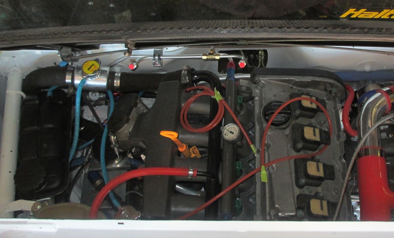

I went with a SPA unit i purchased from Pegusas Racing. Very easy install with push on connectors. I have nozzels placed above and below engine.

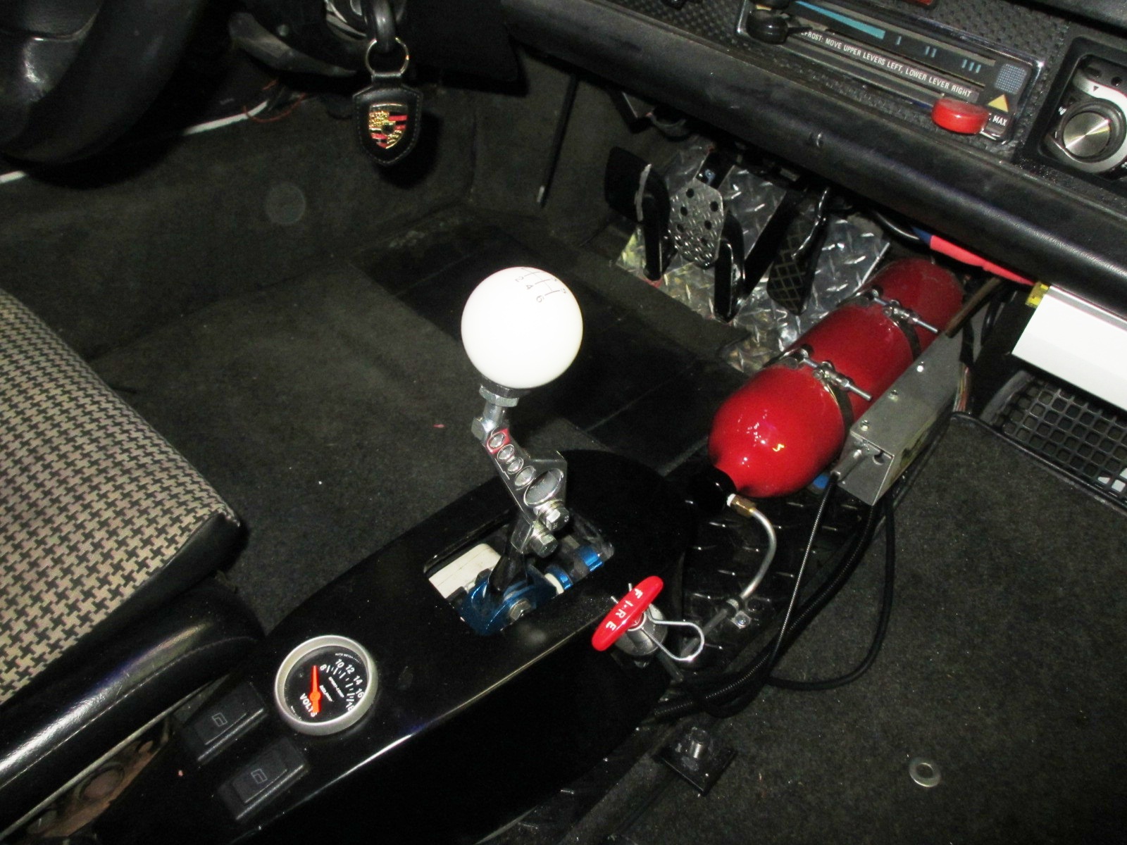

Here's my installation:
(IMG:http://www.914world.com/bbs2/uploads_offsite/i366.photobucket.com-10819-1421425437.1.jpg)

I run an AFFF sire foam system. It's refillable by me and runs off a gas cartridge, CO2 or something. It is not allowed by all racing bodies so I keep a fire extinguisher too. It dumps fire foam on the engine, I aimed the nozzles at the fuel rail and intake manifold.
This is the system I run.
https://www.pegasusautoracing.com/productde....asp?RecID=3431
