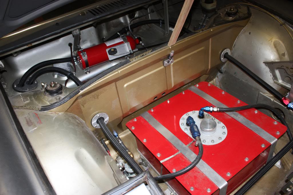

Here's my installation:
IPB Image

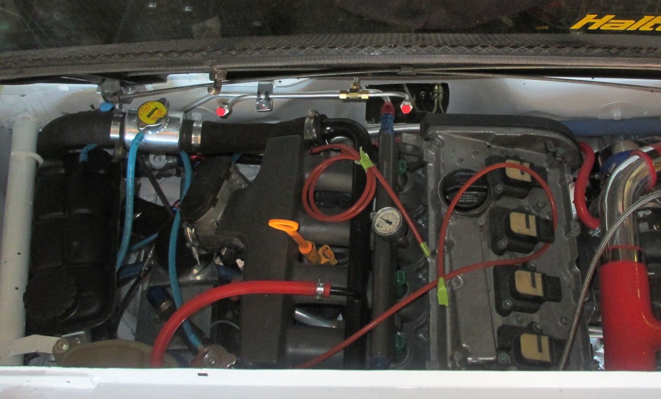

I run an AFFF sire foam system. It's refillable by me and runs off a gas cartridge, CO2 or something. It is not allowed by all racing bodies so I keep a fire extinguisher too. It dumps fire foam on the engine, I aimed the nozzles at the fuel rail and intake manifold.
