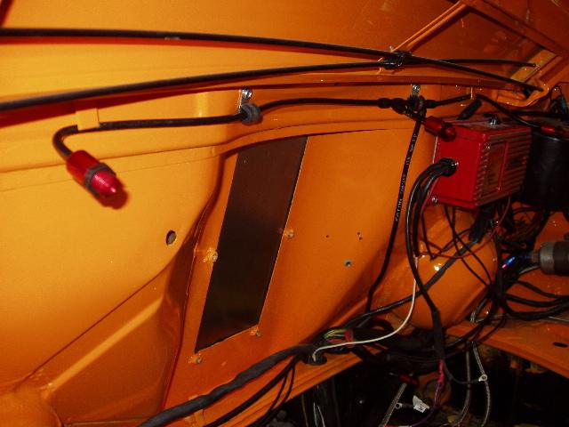

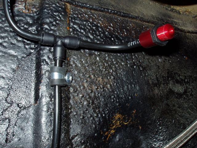

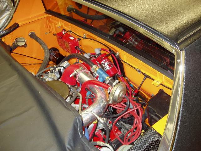

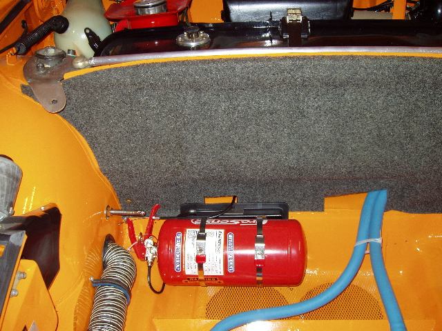

I used this:
https://www.pegasusautoracing.com/productde....asp?RecID=3431
There are different models. One supports 2 nozzles and one supports 3 nozzles.
Here's my installation:
(IMG:http://www.914world.com/bbs2/uploads_offsite/i366.photobucket.com-10819-1421425437.1.jpg)

One thing I forgot to mention about my system: It uses water as part of the supressant, so it cannot be stored outside in freezing weather.
That's probably a show-stopper for a street car.
I never checked to see if you could put some anti-freeze in with the mix.

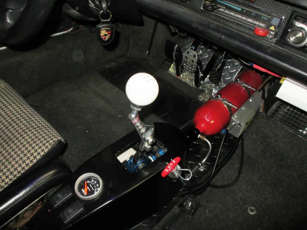

I run an AFFF sire foam system. It's refillable by me and runs off a gas cartridge, CO2 or something. It is not allowed by all racing bodies so I keep a fire extinguisher too. It dumps fire foam on the engine, I aimed the nozzles at the fuel rail and intake manifold.
This is the system I run.

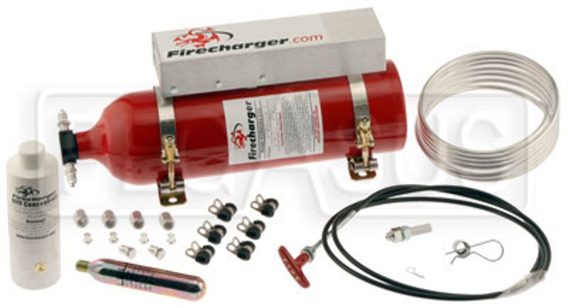

OK- after considering all of the options I went with this system, AFFF, because I appreciate that the foam will not only extinguish a fire but hopefully keep it from reigniting. Of course water clean up is a bonus too.
I am sure I will sleep better knowing if I am crushing around and a fire starts, this will extinguish it immediately - absent operator error (IMG:style_emoticons/default/wacko.gif)
Thanks for all of the input, links and opinions - this site is terrific and I could not be building this car w/o the help and wisdom of all here.
Link: https://www.pegasusautoracing.com/productde....asp?RecID=3431
