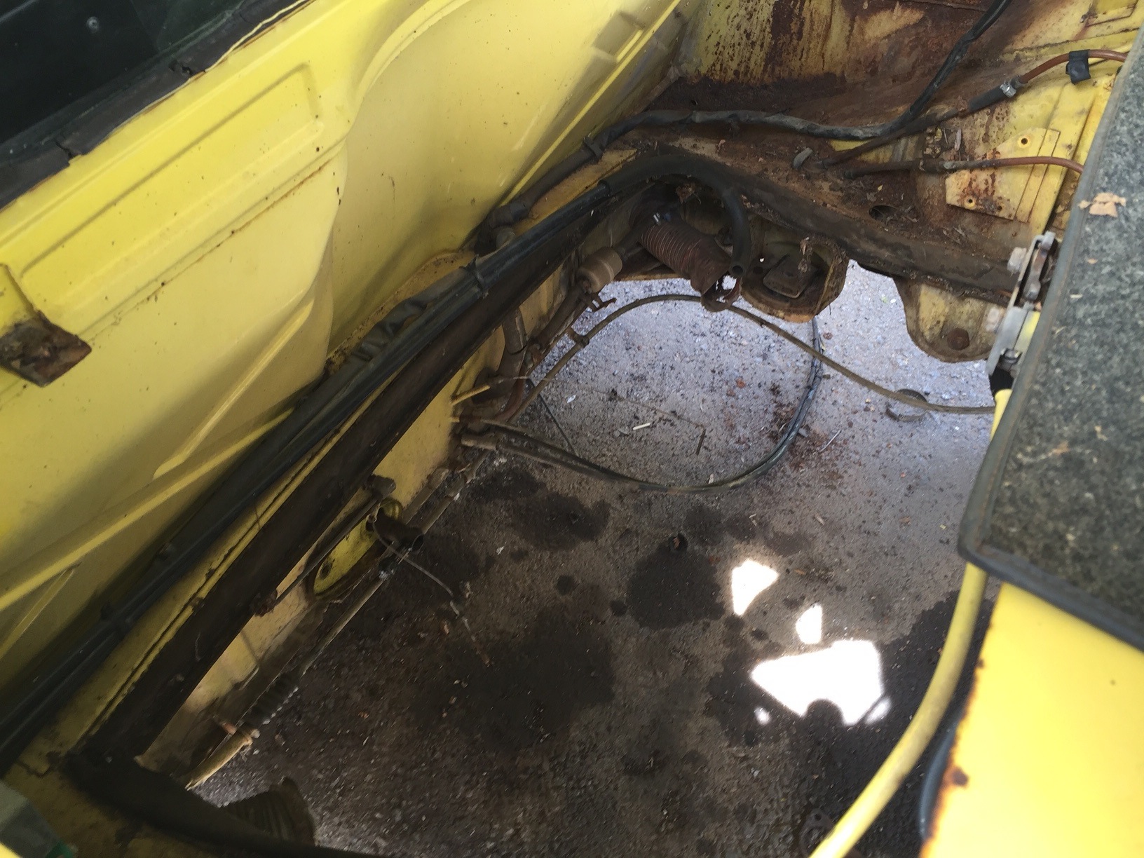

Today I pulled off the rockers to see what was hiding.
Lots of debris trapped on both sides. Driver side looks great though. Jackpoint will still need to be replaced but that was expected.
dlee6204
post Jan 31 2015, 08:03 PM
Howdy
Posts: 2,162
Joined: 30-April 06
From: Burnsville, NC
Member No.: 5,956
The driver side will needs a little more work. What was left of the old tube was being held together by dirt. I already have some new metal from RestorationDesign on order.
