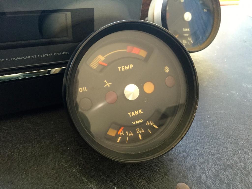

Here is the the stock Six combo gauge:

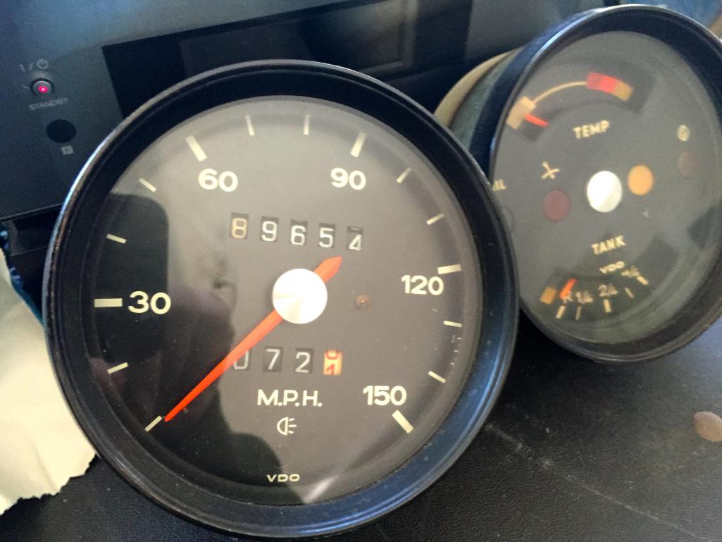

And finally, my original speedo:
Cairo94507
post Feb 14 2015, 06:53 PM
Michael
Posts: 10,794
Joined: 1-November 08
From: Auburn, CA
Member No.: 9,712
I was also thinking about asking Palo Alto Speedo to change out the odometer to the newer 911 style that adds one more digit so when the car turns 100K it does not go back to zero. Thoughts? OH and you may have noticed the extra combo gauge in the background of the second picture. That is likely the one we will be using to make the new combo gauge so I can retain the original Six combo gauge in storage with the other original Six parts we will be replacing with newer stuff - thanks Scotty for that gauge (IMG:style_emoticons/default/smile.gif).

WTF are you guys talking about? The speedo is stock at 150. I will concede it is a volt gauge I want, not amps.

So, I know what I think I want but this is one of those things where I believe it never hurts to ask questions first so I don't have one of those "I could've had a V-8" moments later.
Case on point, "914forme" brought up Speedhut for gauges. That is intriguing as it could give me new electronics possibly. I have contacted them and am awaiting their reply to see if they can take my gauges and install all new electronics in them or if they actually have a gauge that replicates the stock gauges from our cars. Granted that may be a reach.
In evaluating the gauges I want, I agree it is oil pressure, oil temperature, volts, tach with 3.2 redline, speedo and fuel. So given that, it would appear I could do a triple gauge with gas, volts and temperature and then add the oil pressure into the tach (hopefully). I would then not need any additional gauges.
I really do want to change the speedometer to have a new odometer that will not roll back to zero when the car hits 100K as my car is only 10K away from that give or take. Not sure how others feel about that but my mileage is documented and I want it to remain accurate. The new odometer, if that is possible, would be set to my existing mileage.
Thanks for your patience and assistance. I always respect (intelligent (IMG:style_emoticons/default/w00t.gif) ) opinions and appreciate your experience.
