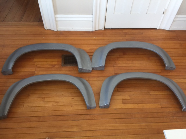

post Mar 11 2015, 04:50 PM
The Governor is watching me
Posts: 1,115
Joined: 10-April 10
From: Philadelphia New York
Member No.: 11,595
So like many things this has now turned into a since I am doing this anyway project. The car will be stripped down to its chassis and be redone. The final color is not determined yet, however it will be in the red family. So these showed up this morning at my door step. The guy left them there as I was getting ready to open the garage door to say something. Funny the tag says inspect before accepting (IMG:style_emoticons/default/dry.gif)
Best part is my wife wanted me to get those flares. And so the saga begins. I have no deadlines for this car so its going to be a while.
post Mar 11 2015, 04:58 PM
914-6 GT in waiting
Posts: 20,959
Joined: 19-September 09
Member No.: 10,825
What car is getting the work done? Pics?
