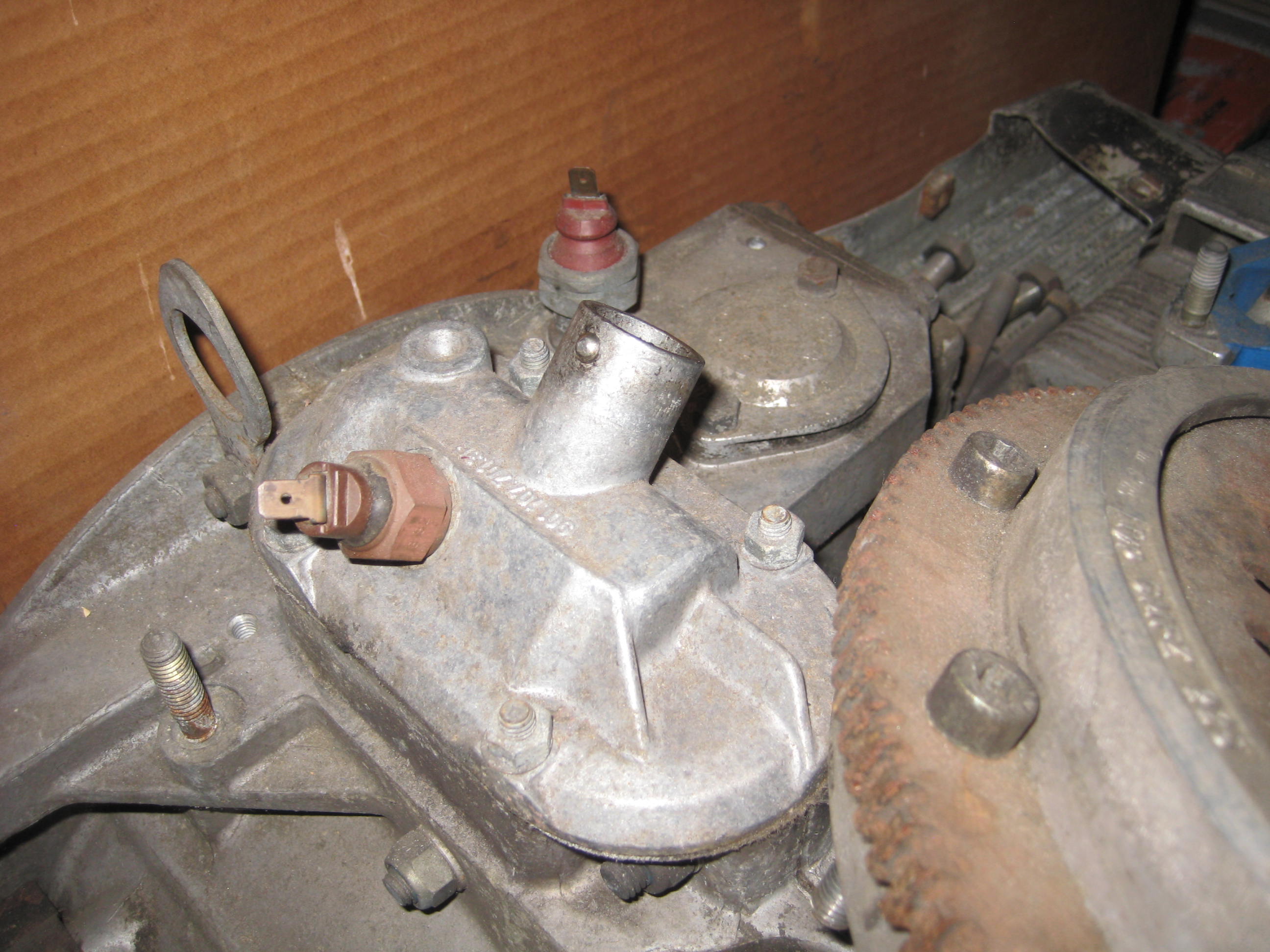

post Mar 4 2015, 09:18 PM
Posts: 4,950
Joined: 23-November 05
From: Paramus NJ
Member No.: 5,176
Leakage at the breather nipple on the engine should not be a problem.
Start with a new hose. And a narrow hose clamp, not a big beefy thing from a radiator hose. Push the hose fully onto the nipple till it bottoms.
Install the hose clamp at the end of the hose, but..... fully on the hose.
The clamp must be below the steel ball that is cast into the nipple.
See attached photo.
Leakage comes from old hard hose that has had the clamp incorrectly tightened on top of the ball.
The nipple should have had a conventional rim rather than the troublesome ball.
