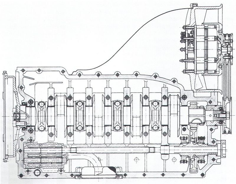

"908 firing orders (taken from a Bill Oursler article).
1--1,8,2,6,4,5,3,7; bad vibrations with 135 or 225 degrees between opposite pistons
2--1,5,2,7,4,8,3,6; better, but still had vibrations
3--1,7,2,8,5,3,6,4; final version that eliminated vibrations; a true boxer with 180 degrees between opposite pistons."
The first one, above, cracked frames and screwed-up electronics.
I don't habla, so does anyone know what the firing order was, or did they even say?

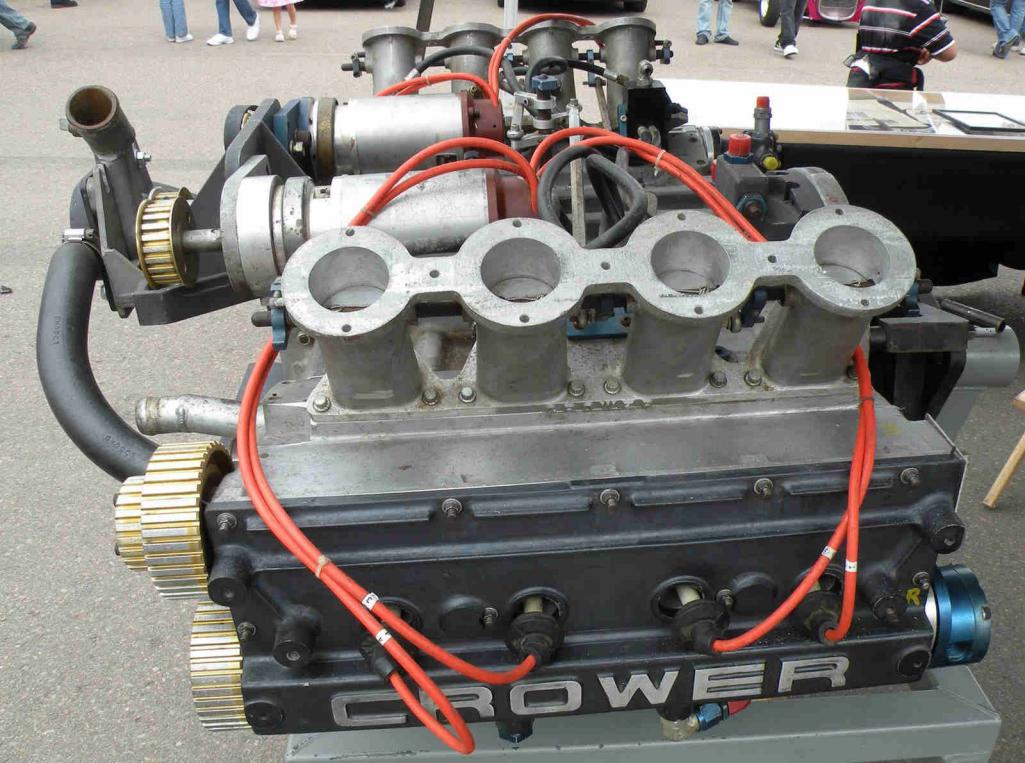

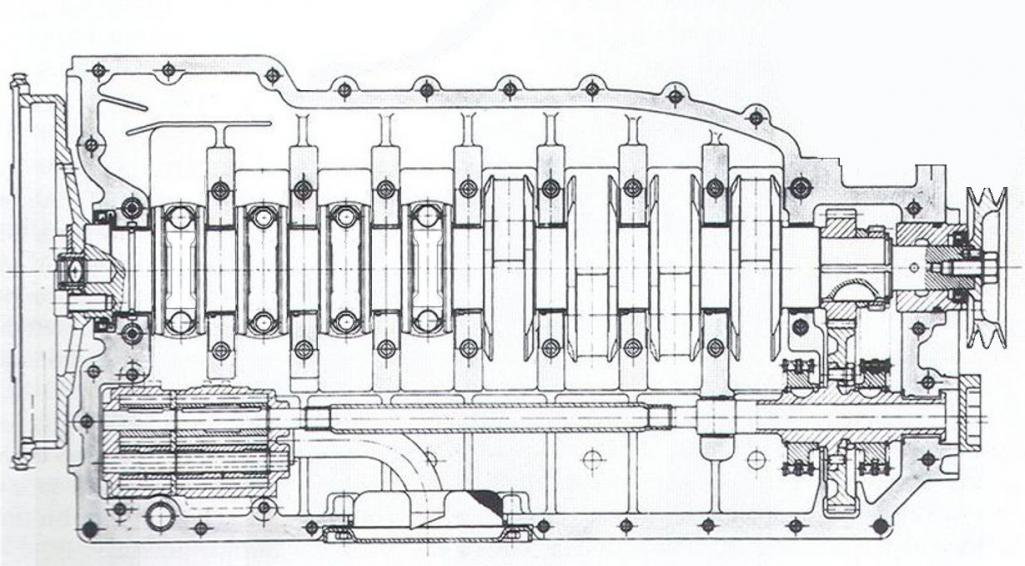

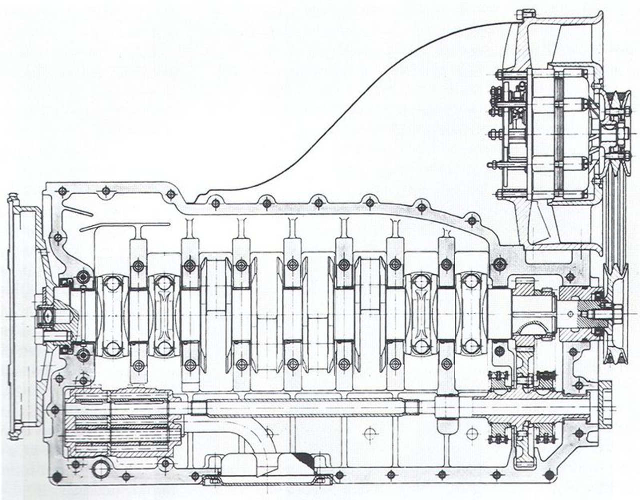

This is drawn as an an interlaced crank.10 main bearings
This is drawn as an inserted crank,1 4cyl crank in the middle,the other split and joined at each end.
This is drawn as 2 4cyl cranks joined end to end 90* apart,the successful orientation.
This engine ran the Indy 500.Cosworth Vega heads,probably AlSi bores.2 x 4cyl Vertex magnetos.(Edit:03/08/15:Nope,Not Indy.Pocono 500 1977)
F8 recalled
http://www.914world.com/bbs2/index.php?sho...amp;hl=beck+gt1
http://www.914world.com/bbs2/index.php?sho...2522&st=100
Simple.More displacement needed.
Desired a less expensive way than buying a production engine.
This engine is very nice,like what Emerson Fittipaldi raced as a 3.2L. (IMG:style_emoticons/default/biggrin.gif)

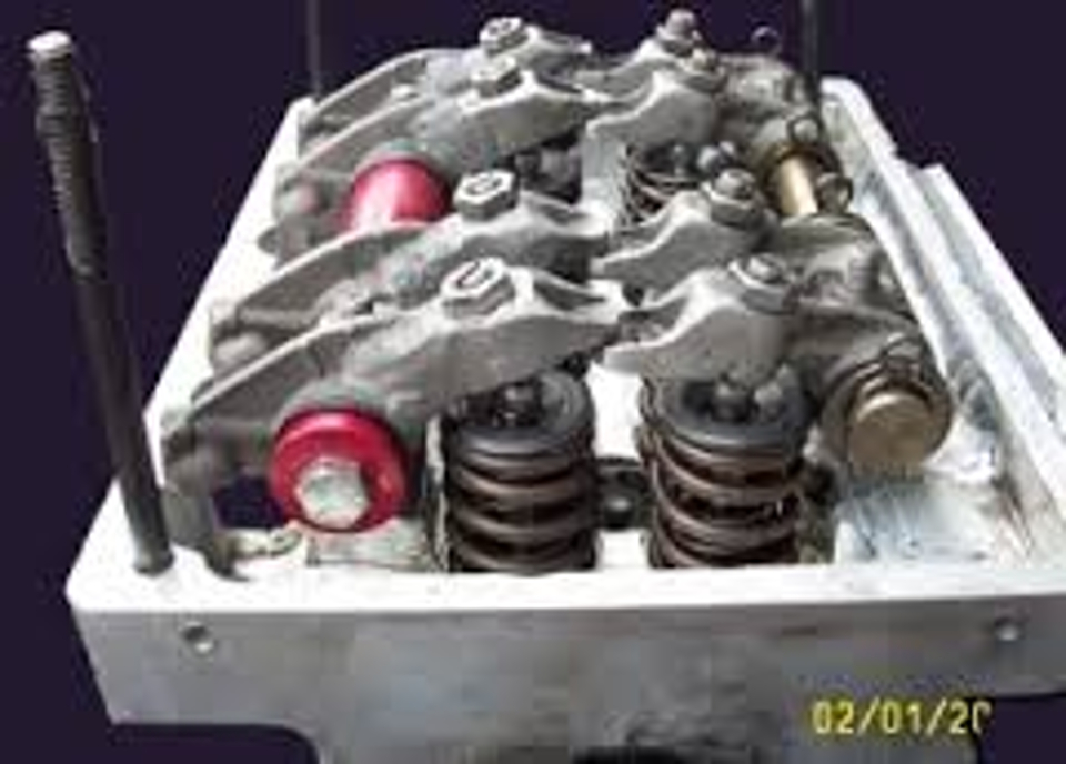

Found the pix,'70-80s experimental,by Arao/Scat,pushrod 4V T1,
You can see the rocker arrangement and twin rockershafts.
The rod pushes the primary rocker,which simultaneously acts upon the secondary rocker.
The spring loads are lighter as the valves are smaller and lighter too.
Titanium valves and retainers and roller rockers may allow a higher rev band.
That was ,as I recall,was their failing in the '70s.As well as the price.

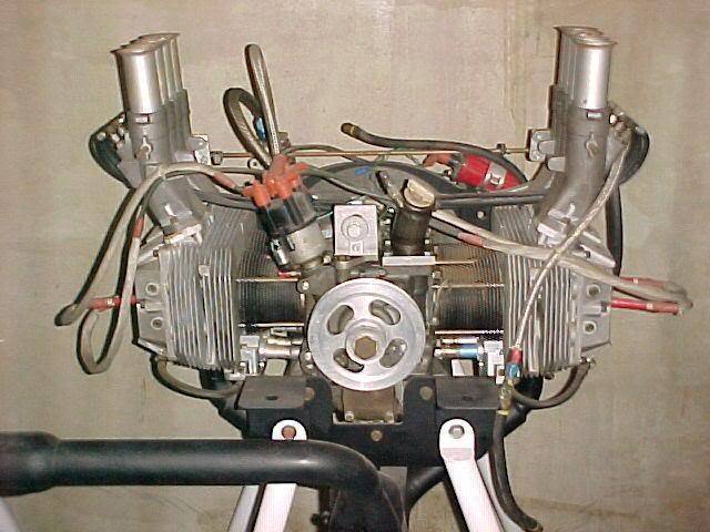

This is a custom flat 8 built in Brazil. The prototype was two VW engines (each 1500cc) built together to form one fire breathing monster known as the the 'Jamaro'.
Have a close look at those parts.Floating wrist pins.Gas or TIG welded heads.
Yes,this is it,the 'Jamaro of Brazil'.
Marco has a battery and pump,checking oil flow(trans fluid).
low-res photo,note cut and shut welds on case.How they dunnit,a few years ago.
Resize the welded crank and rod journals to fit the remachined cases post welding.
Main journals and bearings larger than stock.Means facing and line-boring the cases.
Any tig-man could do this in 2015.Weld a set of cases to 0.005"?Sure.Build a set of jigs and oven weld in steps,checking all the way.

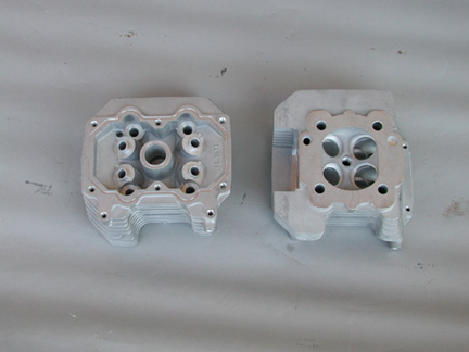

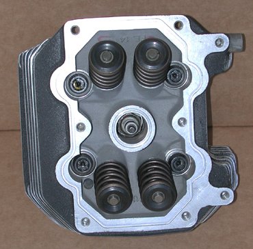

Why the hell would you go to all that trouble and then use single port heads (IMG:style_emoticons/default/confused24.gif)
ldsgeek
post Mar 5 2015, 07:46 AM
Posts: 155
Joined: 27-June 10
From: New Hampshire
Member No.: 11,885
QUOTE(Mark Henry @ Mar 5 2015, 04:19 AM) *
Because that's what they had on hand? It doesn't look like they bought a lot of stuff for this project, keeping with the CSOB theme.

QUOTE(Mark Henry @ Mar 5 2015, 06:19 AM) *
I was thinking the same thing as soon as I saw the heads. Even if you don't have any on hand, with the price of used dual port heads, you could buy 4 and still keep it in the CSOB price range.

X-ray quality welds,like for pressure vessels,it's a 2"bar of steel that's highly stressed by the torsional loads.
The Brazilian said the builder had cast a crank for the engine in malleable iron,a nodular pour was possible then,in Brazil,in '68.
I've done some aluminum castings at home, I built a propane fueled furnace years ago. The added heat of cast iron scares me a little!

Pouring ferrous calls for different techniques in moulding and attention to the charge's metallurgy.
Iron cranks are just fine for a trial and experimental engine,pretty cheap too.

QUOTE(veekry9 @ Mar 4 2015, 10:13 PM) *
Brazil,Sweden,places it's been done.
Part:
Weld or machine
(1) a crank,2 flat 4s 90* apart
(2) crankcases,T1,T4,Corvair,or custom.(Custom Corvair lost foam casting)
(3) cylinder heads,pushrod or ohc,air or water cooled.(kiss,vvt twincam,pushrod)
(4) Nickies to 8 x 96mm x 76mm =4.4L(Big bore,short stroke and deck height)
yeah,4v pushrod.
a 4 cylinder.
Actually ran.
There is no easier way to build the F8 than the Brazilian's method.kiss.

Anymore pictures of the 4 valve setup? I don't see how the valves are actuated?
I see the tubes on the bottom of the complete motor, but after that I am lost.

I found more pictures of the Lind Type IV flat 8 motor and it appears he stuck one into a 914!
Notice "8" on the rear of the car and the rear trunk modified for clearance for the air cleaners.
