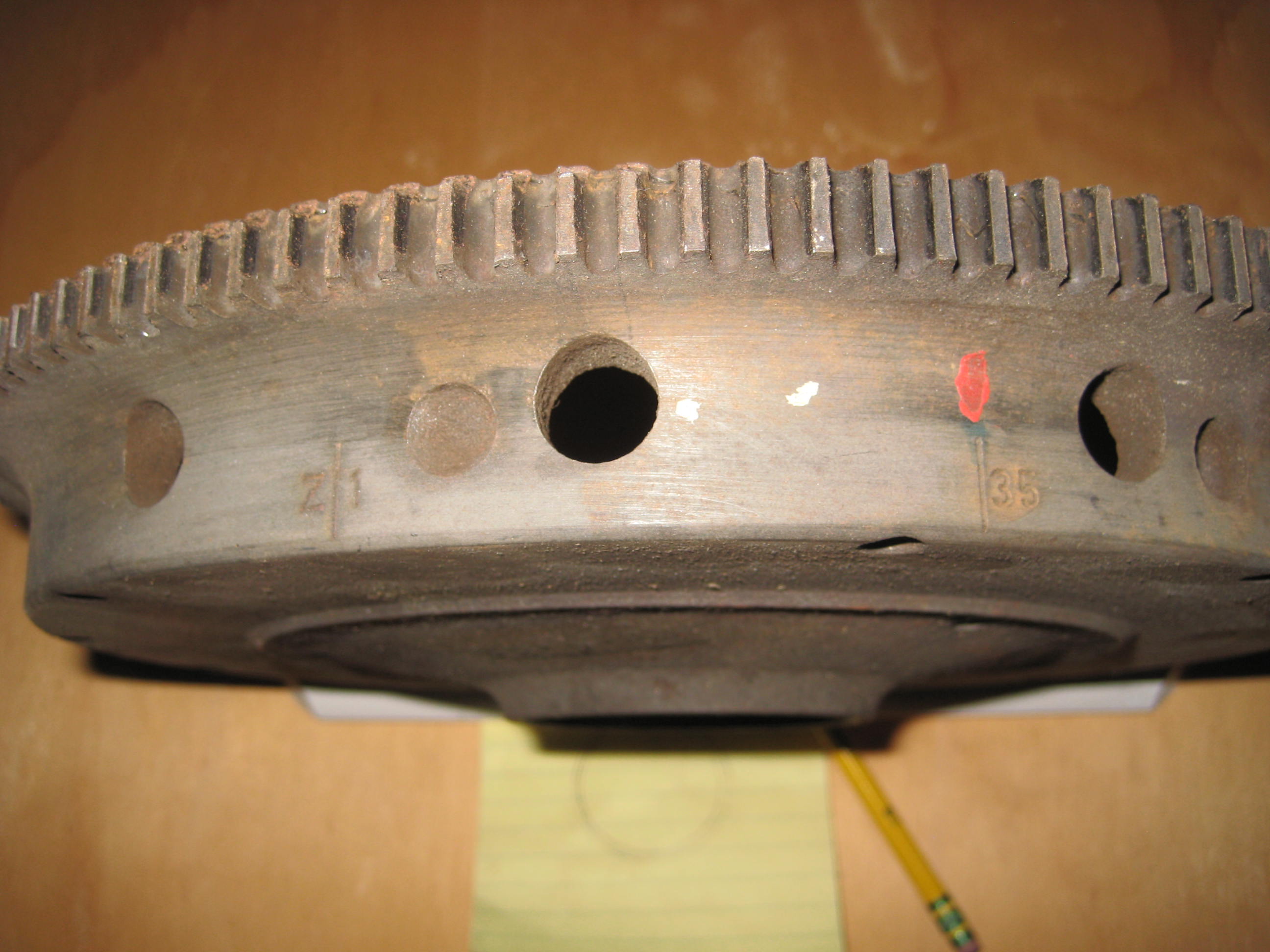

Check the timing at the flywheel. There should be a cutout on the transmission,and there are timing marks that can be used. loosen the distributor,and rotate to advance/retard timing.

AFAIK, and how I've done it, there is an access hole on the top of the case above the flywheel. There are TDC and full advance marks on said flywheel. The hole is large enough to get a finger in there to scrape/sand away rust and put paint on the marks.
The daunting part is that you set the running timing for full advance at 6000 rpm, leaning over the carb stacks. One hand on a timing light, and one to adjust/turn the distributor. Helps to have someone in the cockpit holding the throttle at 6000 also.
X2
- that's all correct so long as you still have an oem 914/6 flywheel
aftermarket and replacement 911 flywheels have the timing marks in the "wrong" place for the 914/6 viewing slot
if you have a good "advance type ' timing light you set it to ZERO and dial up the advance reading when it turns 6000
you can also do this with a mirror watching the pulley marks (which you have brightly marked) by using a dial-advance type tool
even better - cut a porthole in the firewall like our GT's have, and just do it thru the front - see picture

Not exactly, you need to have the proper flywheel for the _engine_ you put
in there. IIRC his is not a 914-6 engine. Not sure what markings are on the
flywheel, but even if they are present, it is a good idea to get one of those
appliance-white-paint-touchup bottles with the brush and mark them very
visibly. You will need TDC and whatever is spec for your engine; could be
35 degrees BTDC or 30 degrees BTDC for earlier motors, or 5 BTDC or 5 ATDC
for different later ones.
If there are no marks on the flywheel and the engine is already in the car, I
think it would be impossible to _accurately_ transfer from the pulley to the
flywheel without pulling the engine first.

My engine is a 2.7l with JE 9.5:1 compression pistons and E cams.
I have a flywheel that does not have timing marks. The engine is already installed in the car.
Shouldn't I simply be able to find TDC for Cylinder 1- put a paint mark on the flywheel at TDC. Find the appropriate timing numbers for my engine. Use a timing light that has adjustable advance- set the timing light to the appropriate advance- rev up to 6000 rpm, twist the distributor until the TDC mark lines up. That way it shouldn't really matter if I have any timing marks other than TDC.
Am I correct or am I missing something?
Not exactly...... leave the engine in the car.
You can make or buy a tool to find TDC.
Then use a timing light with advance feature to set the right timing for your application.
The tool you need is an adjustable piston stop that extends through the spark plug hole. It can be made by tapping the center of an empty spark plug and threading a long bolt through so that it can be extended or retracted as needed.
You rotate the engine in one direction until the piston touches the stop. Near TDC.
Then in the other direction until the piston again touches the stop.
Real TDC is the mid-point between those two stops. Exactly
No flywheel but an original 6 (or 906) is marked for timing.
Sorry for assuming you had a stock 6, many have replacement flywheels from 911s.
This method is also useful on any engine to verify true TDC on the pulley.

CORRECT - just do it
even better - first static time it using the pulley notches
TDC is notched on the front pulley
(along with the other 2, so be sure you get #1 TDC by method as above)
also usually is an advance notch close next to the TDC notch -
all you need to know is here - 911 pulley marks
QUOTE(tornik550 @ Mar 16 2015, 09:26 AM) *

Yes, this is correct. Beware that if there are issues with getting all the
pulses and nothing but the pulses to the gun's sensor, then its advance
setting won't work well. I have had problems with both of my guns getting
crosstalk or something. YMMV
