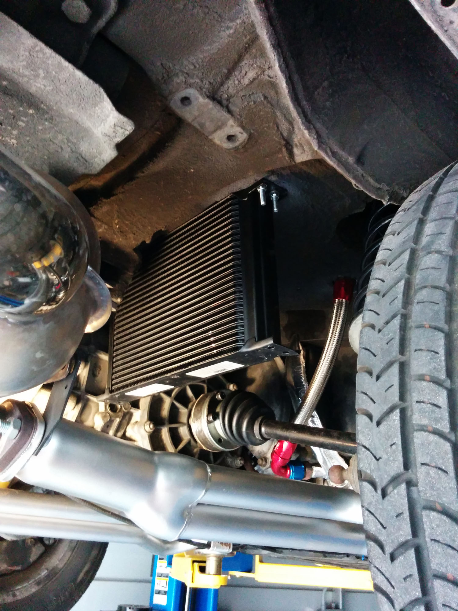

Ordered the smaller setrab unit with fan to replace the oil cooler that was installed when I bought the car (pictures). The new setrab unit is way smaller than I thought it would be. In fact, it's about half the size of what's installed now. I'm pretty sure the bigger setrab unit with the double fans is too big for this space. Anyone see issues if I run two of these smaller units in series? That way I can install them staggered and will fit in that space quite nicely.

rtalich
post Jun 14 2015, 11:51 AM
Posts: 279
Joined: 25-September 06
From: Bellevue, WA
Member No.: 6,913
Just a quick update. I finally installed the setrab cooler but have not driven it yet. Here is a pic of the old cooler. Not sure how it even worked at all. Air can't even get thru it!!
Mike Bellis
post Jun 14 2015, 11:54 AM
Resident Electrician
Posts: 8,348
Joined: 22-June 09
From: Midlothian TX
Member No.: 10,496
That's a cross flow cooler. Supposed to have more surface area and better oil mixing than a standard cooler.
Andyrew
post Jun 14 2015, 12:01 PM
Spooling.... Please wait
Posts: 13,380
Joined: 20-January 03
From: Riverbank, Ca
Member No.: 172
/\ I agree, turn the cooler so you can see it at an angle, You'll see it actually flows fairly well.
