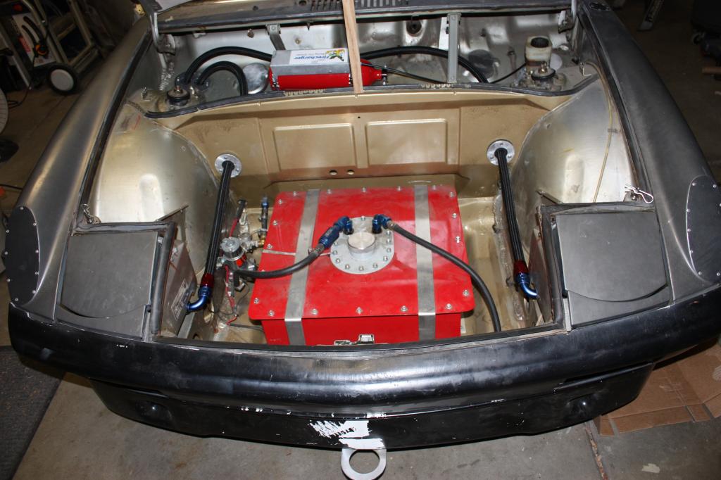

I put two of the smallest setrabs you can buy below the headlight buckets and vented through the foglamp holes.
I put them in series. I considered the parallel idea, but decided that there would be no way to know if you had even flow through both that way.
And I used 12AN for the full run to the front & back.

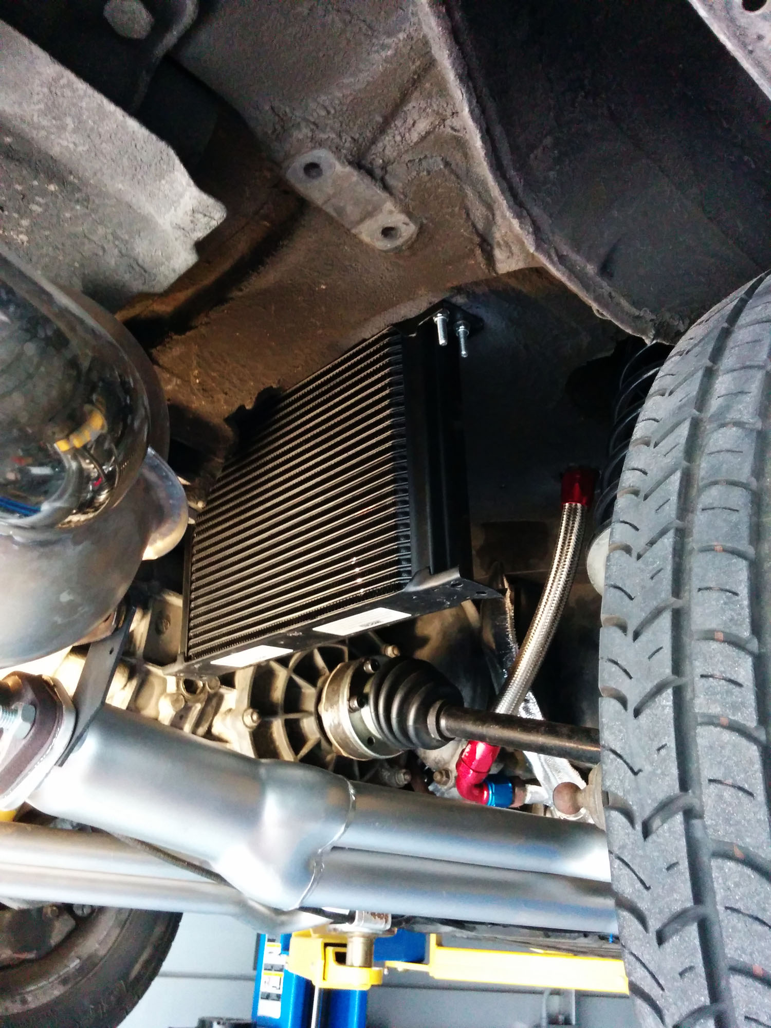

Just a quick update. I finally installed the setrab cooler but have not driven it yet. Here is a pic of the old cooler. Not sure how it even worked at all. Air can't even get thru it!!
Mike Bellis
Jun 14 2015, 11:54 AM
That's a cross flow cooler. Supposed to have more surface area and better oil mixing than a standard cooler.
Andyrew
Jun 14 2015, 12:01 PM
/\ I agree, turn the cooler so you can see it at an angle, You'll see it actually flows fairly well.

Those fans do a good job of restricting the volume of cooling air through the coolers. Take them out or at least snip off the ends of the tie wraps.
bdstone914
Jun 14 2015, 12:08 PM
In referance to posts #18 and #19:
Yes that is a cross flow cooler as are most of the other ones mentioned in this thread. That design is a stacked plate cooler having been sold under Long Mfg, Borg Warner and other manufacturers names. Not really better. They lack fins and are air side limited on heat dissipation.
How many radiators have you seen made after 1930 that did not have fins?
They do not flow air well. Long Mfg used to have the BTU heat rejection listed on their website showing this style cooler clearly removes less heat that a similar plate and fin cooler.
The design dates back to WWII where it was used as an aircraft cooler ( P-38 ?) with very high air speed and fins could get flattened.
They also need to be rubber mounted to prevent vibration damage. Ford used them as power steering coolers on diesel trucks with a high failure rate. Not a good choice for an under body cooler in the hot & poor airflow area under a 914 trunk. Regardless of what cooler you use an oil temp gauge will tell you if you have enough cooler.
Bruce

Jun 15 2015, 06:26 PM
Well... It was pretty warm today... 80 degrees out. Oil temp got up to 270!!! Found out when I got home that I forgot to hook up the gnd wire for the fan!! Pretty sure fans work better when they are hooked up to power correctly.
