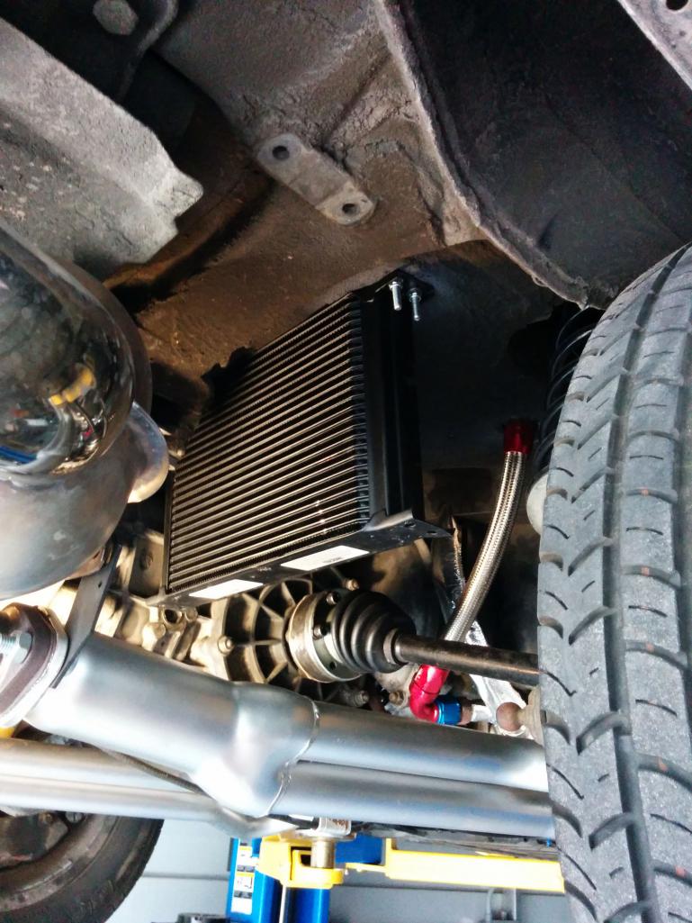

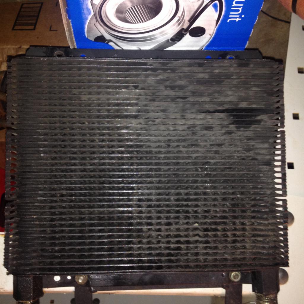

Ordered the smaller setrab unit with fan to replace the oil cooler that was installed when I bought the car (pictures). The new setrab unit is way smaller than I thought it would be. In fact, it's about half the size of what's installed now. I'm pretty sure the bigger setrab unit with the double fans is too big for this space. Anyone see issues if I run two of these smaller units in series? That way I can install them staggered and will fit in that space quite nicely.

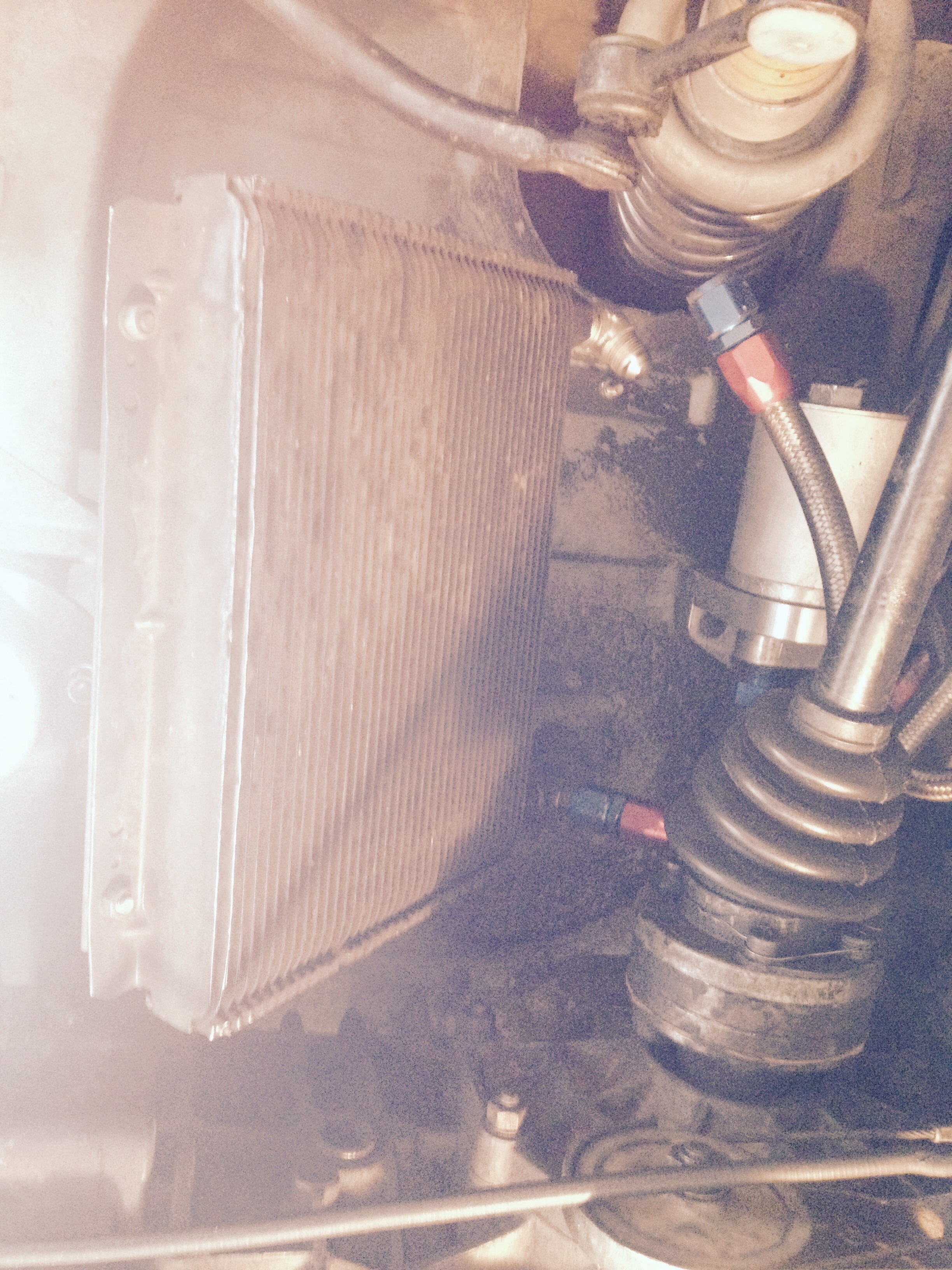

rtalich   Just a quick update. I finally installed the setra...   Jun 14 2015, 11:51 AM
Mike Bellis   That's a cross flow cooler. Supposed to have m...   Jun 14 2015, 11:54 AM
Andyrew   /\ I agree, turn the cooler so you can see it...   Jun 14 2015, 12:01 PM
bdstone914   In referance to posts #18 and #19: Yes that is a ...   Jun 14 2015, 12:08 PM
rtalich   Thanks guys!! I will be driving it this we...   Jun 14 2015, 12:19 PM
