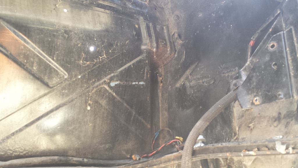

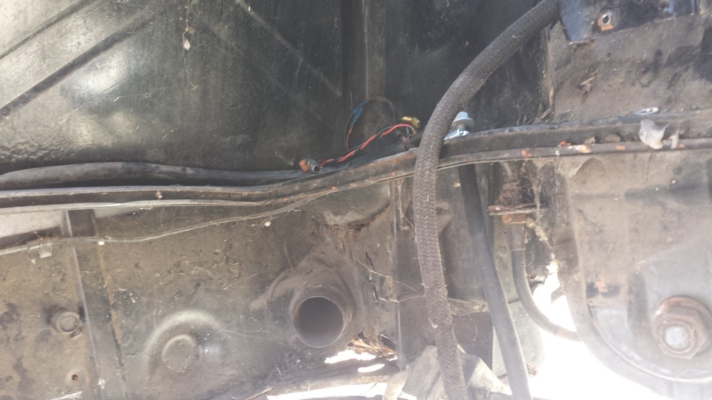

all the interior removed:
(IMG:http://www.914world.com/bbs2/uploads_offsite/i98.photobucket.com-13631-1432590830.1.jpg)
(IMG:http://www.914world.com/bbs2/uploads_offsite/i98.photobucket.com-13631-1432590831.2.jpg)
(IMG:http://www.914world.com/bbs2/uploads_offsite/i98.photobucket.com-13631-1432590831.3.jpg)
(IMG:http://www.914world.com/bbs2/uploads_offsite/i98.photobucket.com-13631-1432590831.4.jpg)

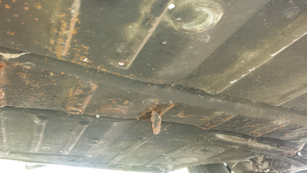

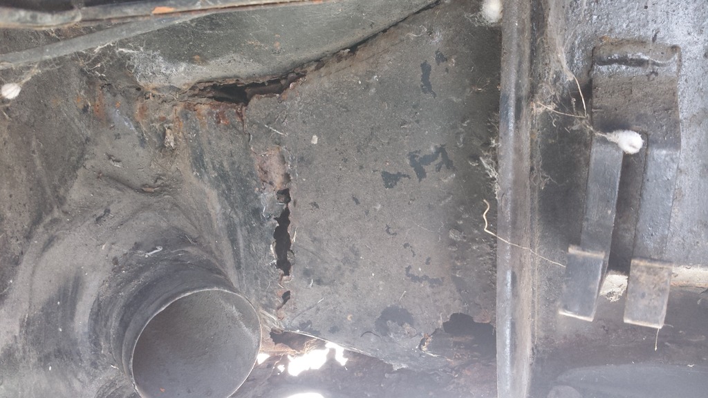

seat mount is completely gone:
(IMG:http://www.914world.com/bbs2/uploads_offsite/i98.photobucket.com-13631-1432590832.5.jpg)

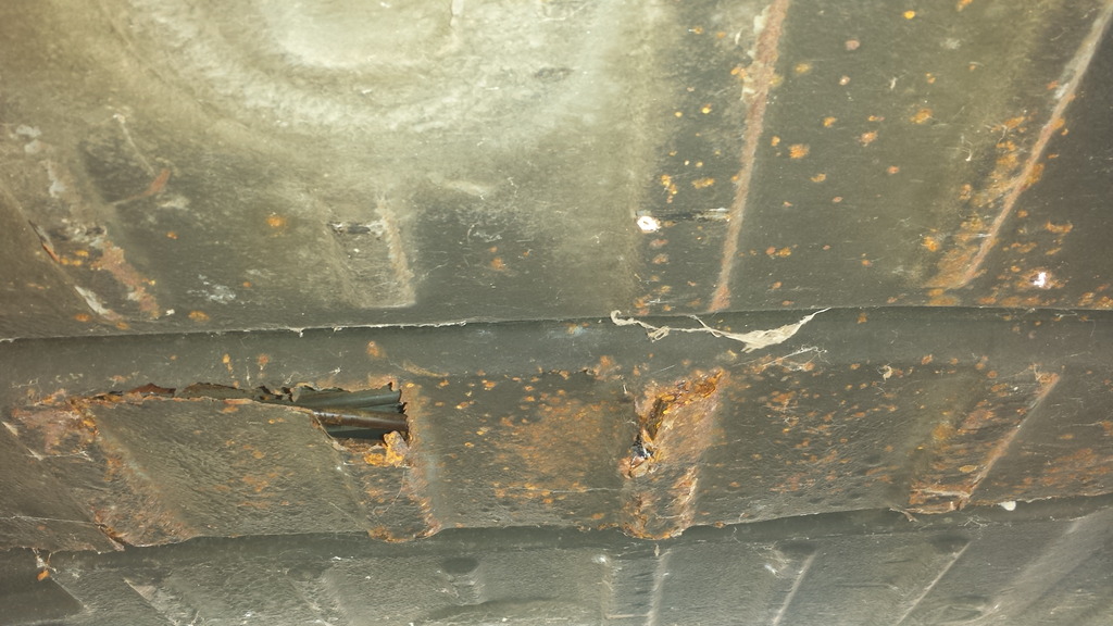

Just behind the passenger seat... directly over the jack mount area:
(IMG:http://www.914world.com/bbs2/uploads_offsite/i98.photobucket.com-13631-1432590832.6.jpg)

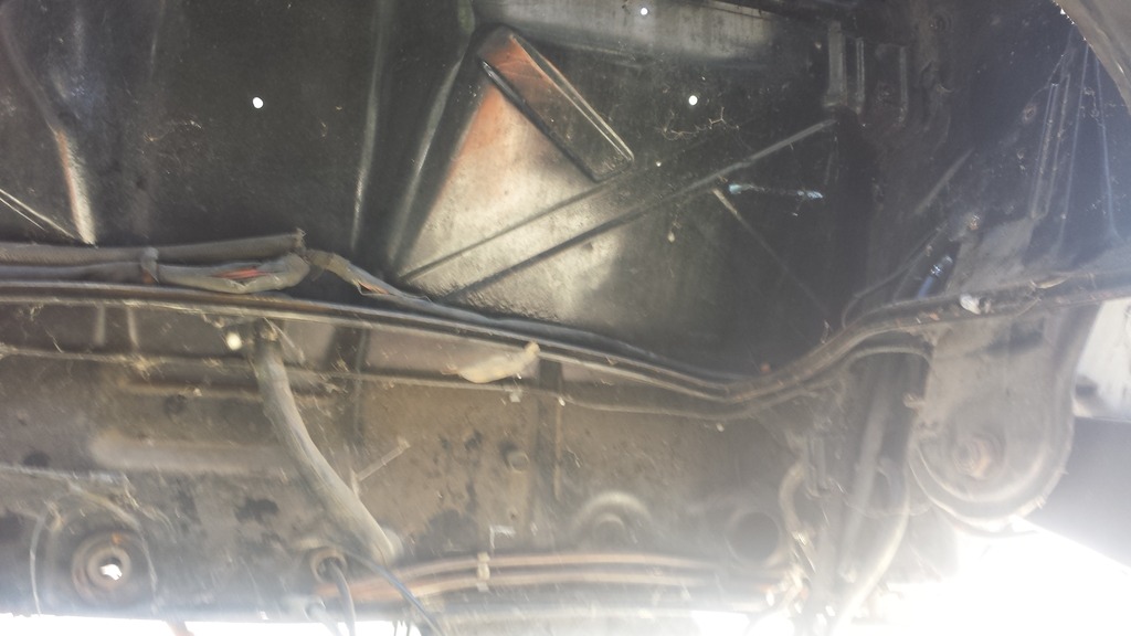

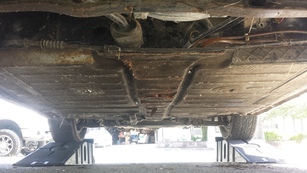

Under the car looking towards the front: Tunnel is in rough shape
(IMG:http://www.914world.com/bbs2/uploads_offsite/i98.photobucket.com-13631-1432590844.1.jpg)
(IMG:http://www.914world.com/bbs2/uploads_offsite/i98.photobucket.com-13631-1432590844.2.jpg)
(IMG:http://www.914world.com/bbs2/uploads_offsite/i98.photobucket.com-13631-1432590845.3.jpg)
This gives a basic of what I'm dealing with.
Oddly, there is No rust in the "hell hole"... at least none that I can clearly see. The battery moved to the rear of the car and that might have saved this area...
Anyhow, this is what I have to work with. Overall not terrible, but certainly more than I had hoped for in wanting a drive-able project.

I don't think your rot will be minimal. Pull the rocker covers and poke around some more. Our cars have spot welded seams that allow moisture to enter into the body cavities. So they literally rust from the inside out. Check out the passenger suspension console, the pedal box reinforcement, the rear trunk, and the area where the bumpers are bolted in. As you remove paint, undercoating and seam sealer, you will find more rust. It can all be fixed.
I would also buy some stainless steel fuel lines from tangerine racing.

Looks like the car was POR-15'd at some point in its life. There's going to be a lot of rust to fix. You can get many of these parts from Restoration Design.
1. Drivers and pasenger floor pans http://www.restoration-design.com/store/product/PP344 and P345
2. Probably both trunks (or at least partial pieces in both trunks).
3. Suspension consoles
You need to get a look at those longs with the rockers off and starting poking with a big screwdriver.
I hope it works out for you. Of course, fixing this car all depends on your wallet and/or your welding skills and/or your personal connection to the car (ie. it belonged to a family member). Best of luck.

That looks pretty bad and be assured, there is more hiding. I hope you're good with a welder!
(IMG:style_emoticons/default/welder.gif)
Most parts you will need are available from RD:
What's the VIN? A black '74 always makes me suspicious ...

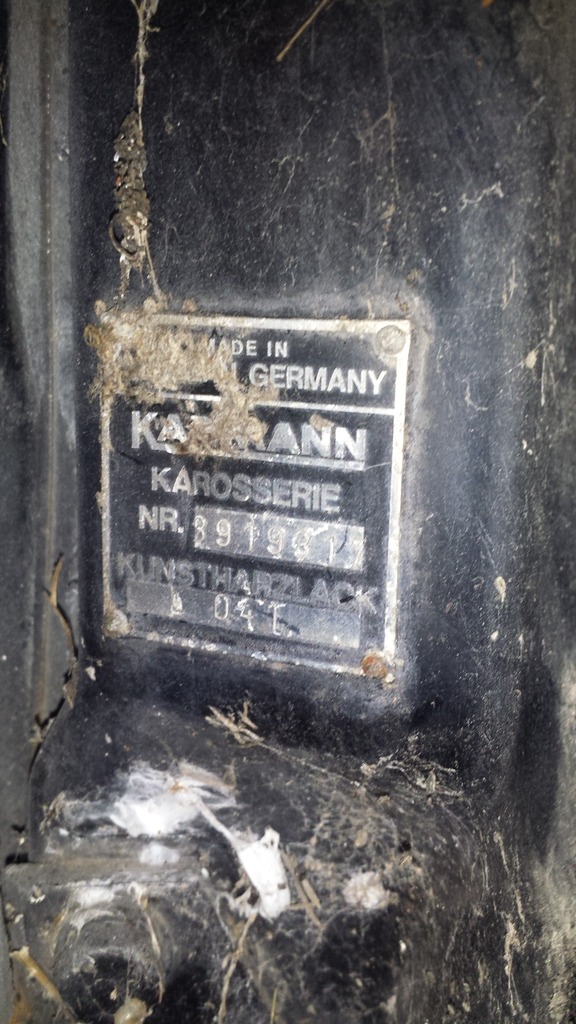

The vin for the car is:
4742903791
and here is the stamp for the color code:
(IMG:http://www.914world.com/bbs2/uploads_offsite/i98.photobucket.com-13631-1432599395.1.jpg)
Unless I am mistaken this is an original black 914.

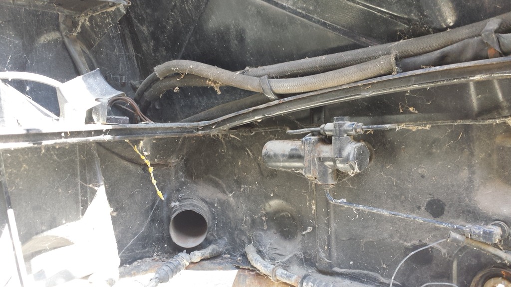

Found out today that there is not rust in the Hell Hole because its already been repaired...
From what I see it was decently done from the engine side, but not so well from the outside...
I came across several black widows while looking around so I wasn't able to get a good look from under the fender side..this thing is crawling with spiders and spider eggs.

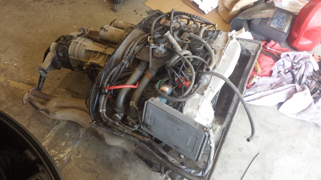

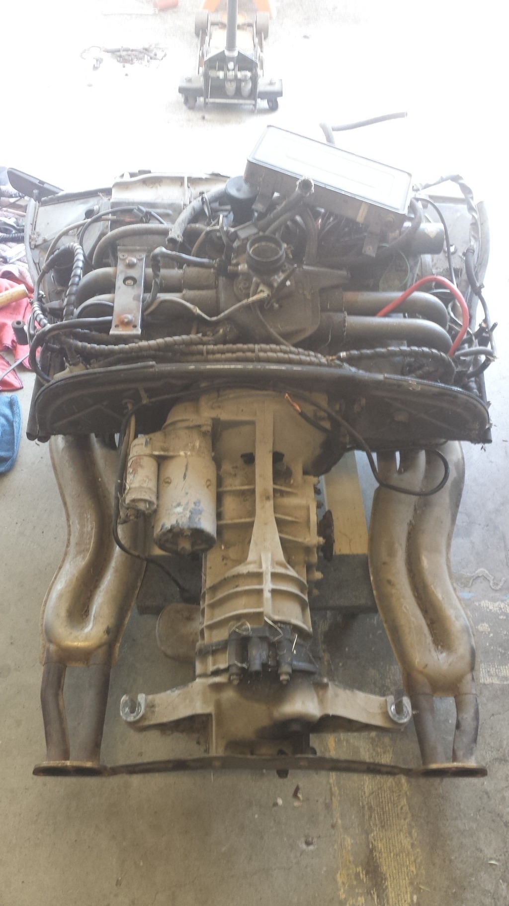

Here is an overdue update of the my 74 2.0 restoration:

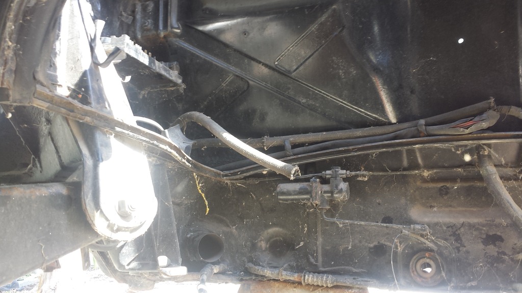

Decided to drop the engine today so I could get a better look at what might be hiding.
I think overall things could have been worse, but I am trying to remain optimistic and could be kidding myself.

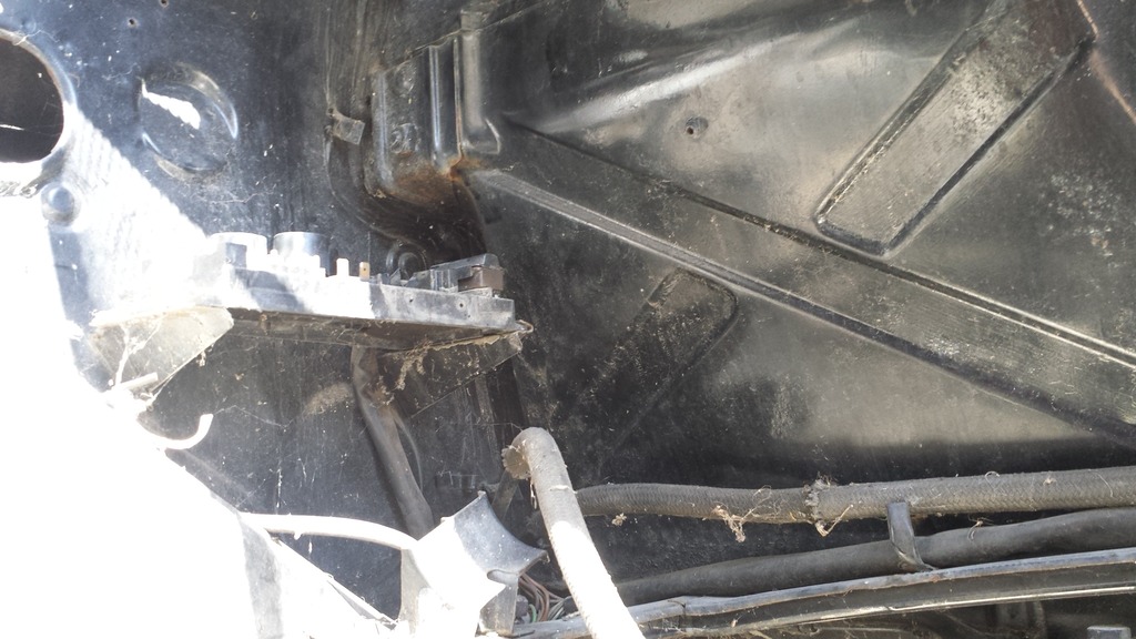

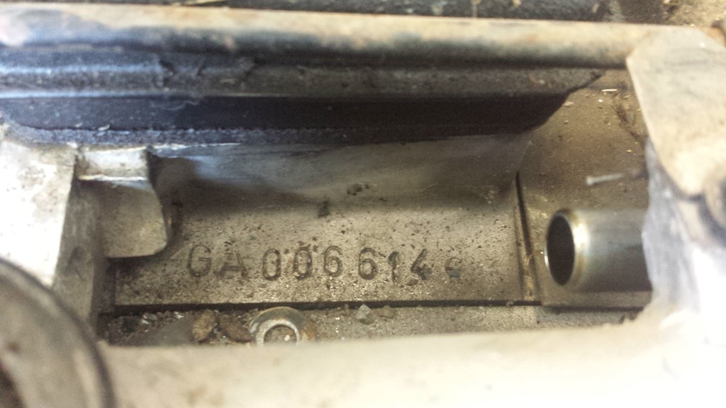

The Hell Hole has definitely seen some repair... Will need more work I think as whoever repaired it only fixed what was visible.
Tomorrow if I have time I plan to clean the car as much as possible. The spider eggs and webs are everywhere.
Enjoy the progress pics!

Just below where the battery tray would be... not sure of the correct term for this area... but its in needs of repair:
(IMG:http://www.914world.com/bbs2/uploads_offsite/i98.photobucket.com-13631-1433643353.6.jpg)
Battery Tray area... hard to tell what was done from this side, however its clear from the outer.. couldn't get a camera inside to truly see. Will have to get to that later.
Looks rusty... little surface rust but otherwise solid.

(IMG:http://www.914world.com/bbs2/uploads_offsite/i98.photobucket.com-13631-1433643354.8.jpg)
This side (driver) is surprisingly solid.
(IMG:http://www.914world.com/bbs2/uploads_offsite/i98.photobucket.com-13631-1433643354.9.jpg)

That about does it for today. I have been making my shopping list and I'm not sure where to shop for parts. Auto Atlanta has a lot of stuff, but so does Restoration Design. Any recommendations?

QUOTE(Cairo94507 @ Jun 6 2015, 07:24 PM) *
Nice progress. Please clean out all of the spiders, nests and anything else with more than 2 legs. (IMG:style_emoticons/default/wacko.gif)
Cairo,
Since getting this 914 Home I have seen some very interesting spiders... colorful is one way to put it.... along with several black widows... (IMG:style_emoticons/default/unsure.gif) I was half considering setting off a few bug bombs... really not a bad idea!
In addition to the creepy crawlers is the ridiculous amount of excrement left by the 914's favorite four legged rodents. Its just everywhere!
QUOTE(mepstein @ Jun 6 2015, 07:37 PM) *
Restoration design is always 1st on my list. AA not so much.
Thanks for the feedback! I will keep that in mind. I've seen many of the RD's videos on the tube and they produce some quality stuff.
