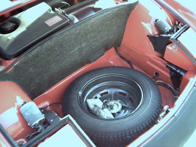

Here are some shots you might use as a comparison to other '76s you might be considering. I would have been extremely happy to have gotten $5000 for this car when I had it up for sale last year.
This was an original car, late production (3947 of 4100), with 87,000 miles.
IMHO, $7000 is unrealistic for that car, based on the pictures. You can, and will, do much better. Keep looking. . . .
Thanks,
type47fan

another. . . .

more. . . .

last. . . .
