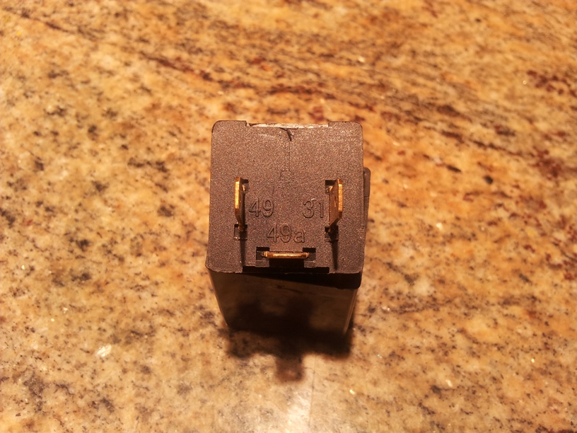

If you ain't returning it, plug it in to see what it does. Is the cover a ground or "the 4th" post?

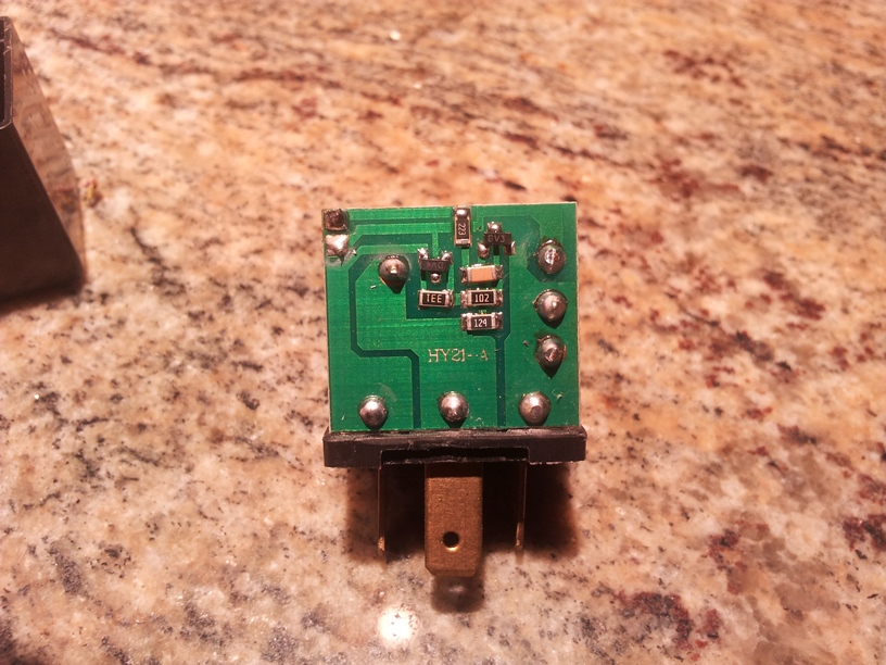

It is possible that the missing post is the K/C2 terminal which drives the dash indicators. You can work around the missing terminal.

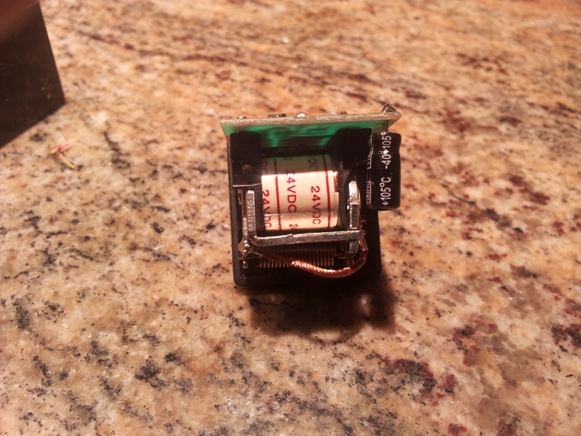

I took it apart to see. BTW the coil is 24VDC:

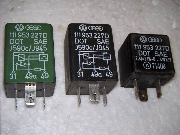

I also found this schematic online:

The range anywhere from a $14 and up depending on where you shop. What they are selling are for VW not 914.

I saw some 4 lug versions for $14 as well. Several sources.

A real flasher relay has 2 coils and 2 sets of contacts inside. One set flashes the exterior lights and the other flashes the dash indicator. That is why they have 4 terminals.

No. double coils, double single pole.
