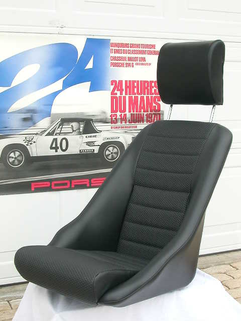

I plan on a nice seat (Lemans from GTS classics) and harness, so I was thinking of simple body mods I can do.
The seat I want (IMG:http://www.914world.com/bbs2/html/emoticons/drooley.gif)

Excellent choice. That is a GREAT seat. I want one too. (IMG:http://www.914world.com/bbs2/html/emoticons/smilie_pokal.gif)
