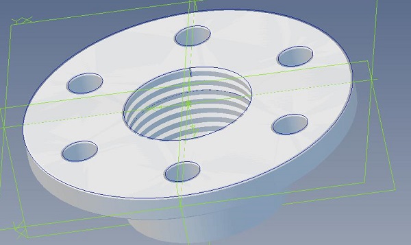

Crazy idea time....
Know any machinist?
Drill out threads will large Silver & DEming drill bit, use new plate that screws into the bottom of the motor. Sorry, not to scale, only had a few minutes to draw this up..time to go bed! I'll read all the negative comments in the AM, hahaha
