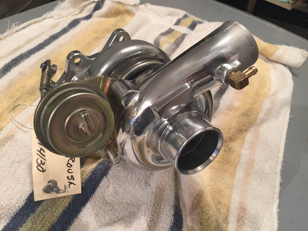

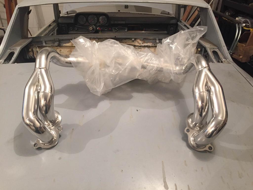

Here is my Outfront coated header and the stock turbo that Outfront polished for me.
