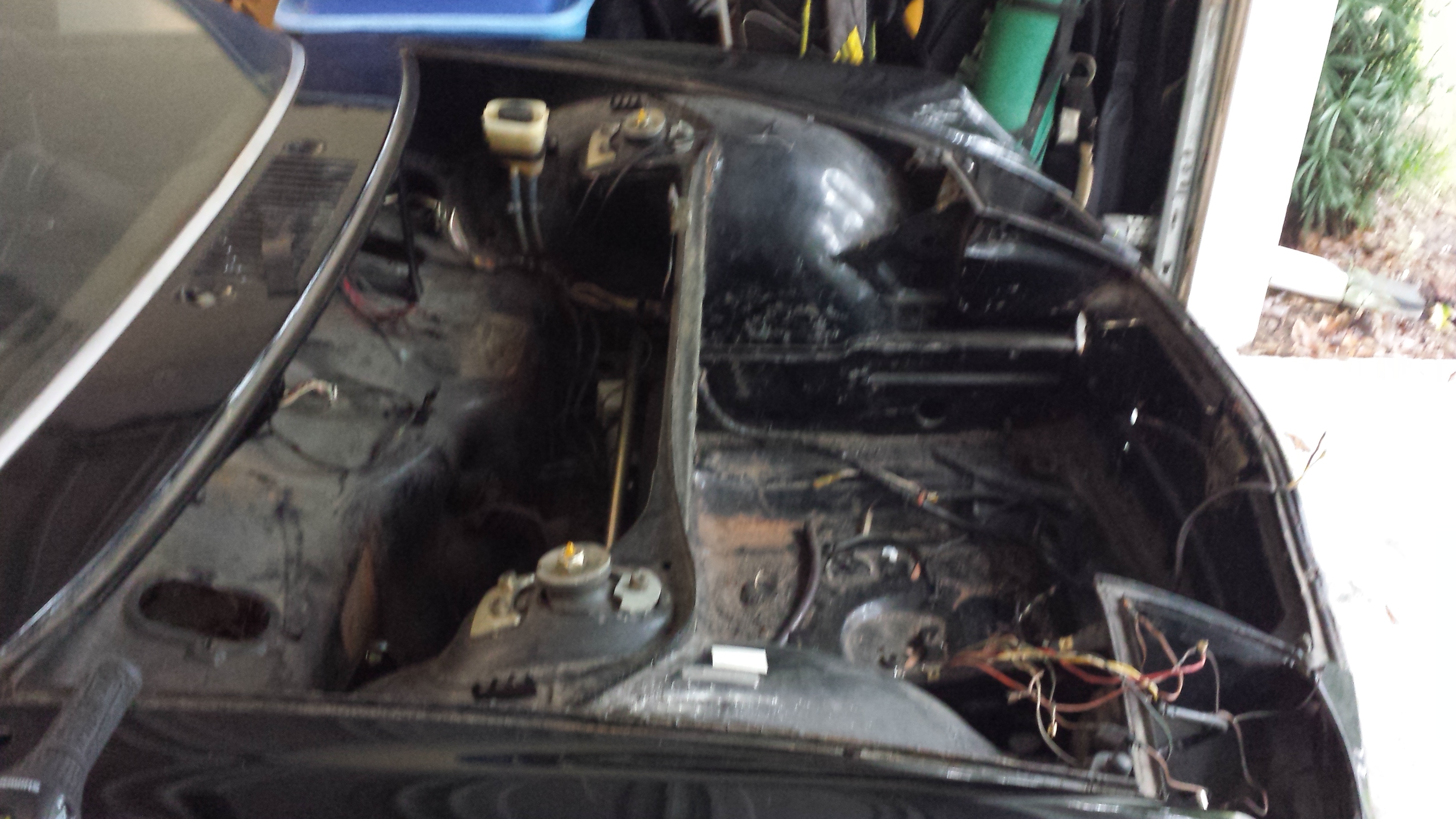

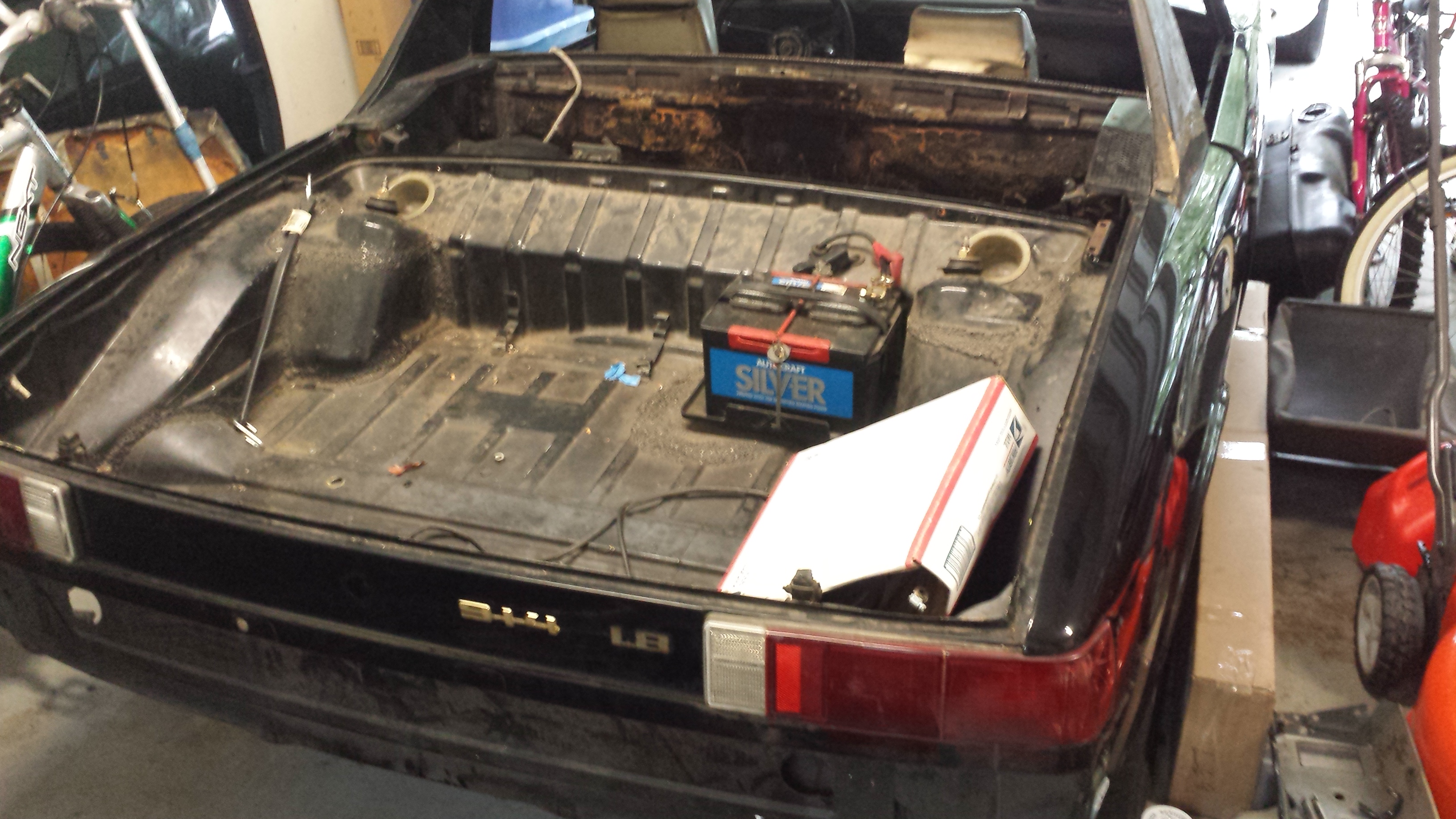

Front trunk. Hood is off,

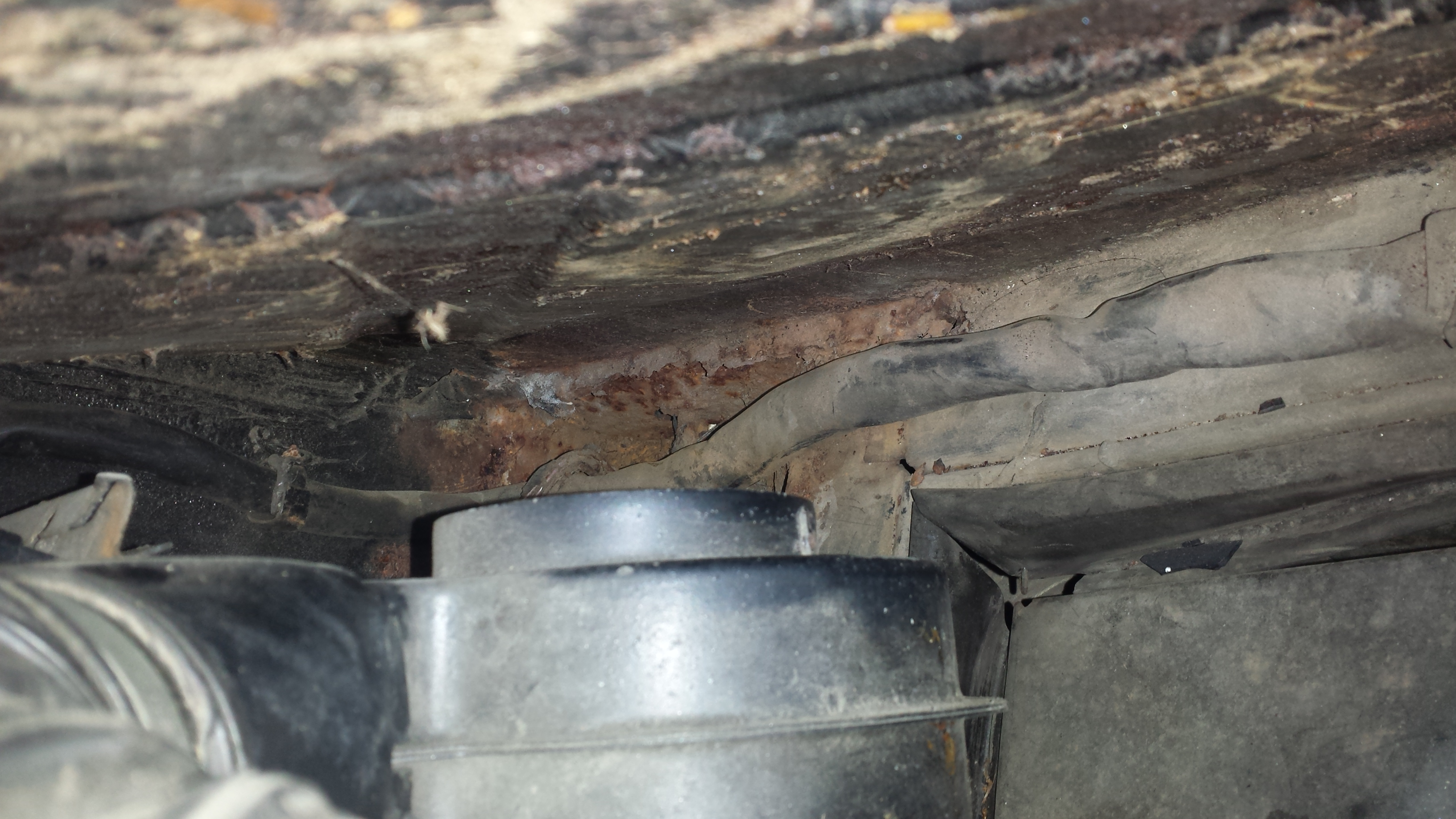

Rust

Rust

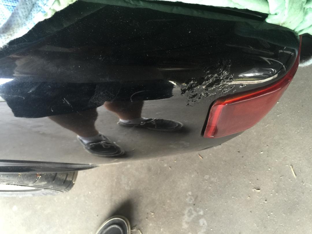

The right front fender clip was replaced and is very straight., but not aligned perfectly so the gap with the cowl and the front edge of door is 1/8" or so too bigh. I need advice on whether I should leave it or remove and reattach it.

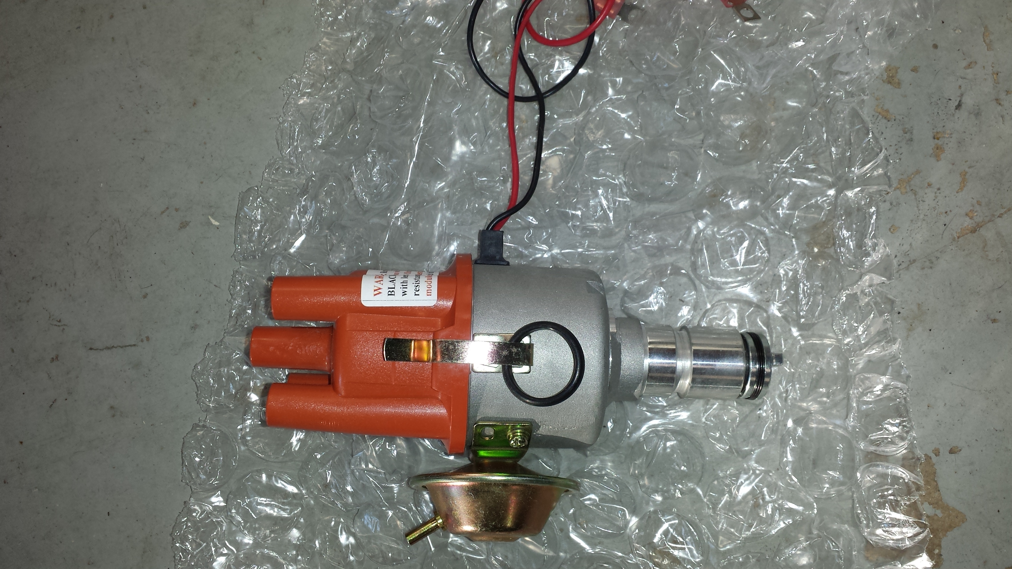

New distributor.
Can I use this over ? I think when the pulled it out it was ruined, I may need to source a new one, do they make new column parts?

Fender/door gap and cowl gap

Andyrew
post Nov 6 2015, 09:18 AM
Spooling.... Please wait
Posts: 13,381
Joined: 20-January 03
From: Riverbank, Ca
Member No.: 172
QUOTE(Philip W. @ Oct 27 2015, 05:04 AM) *
New distributor.
The split you mean? Thats normal, it actually pieces back together. The question is if everything works..
