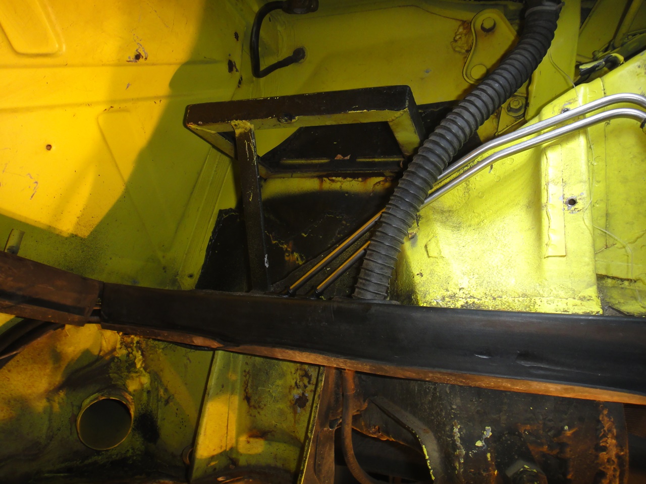

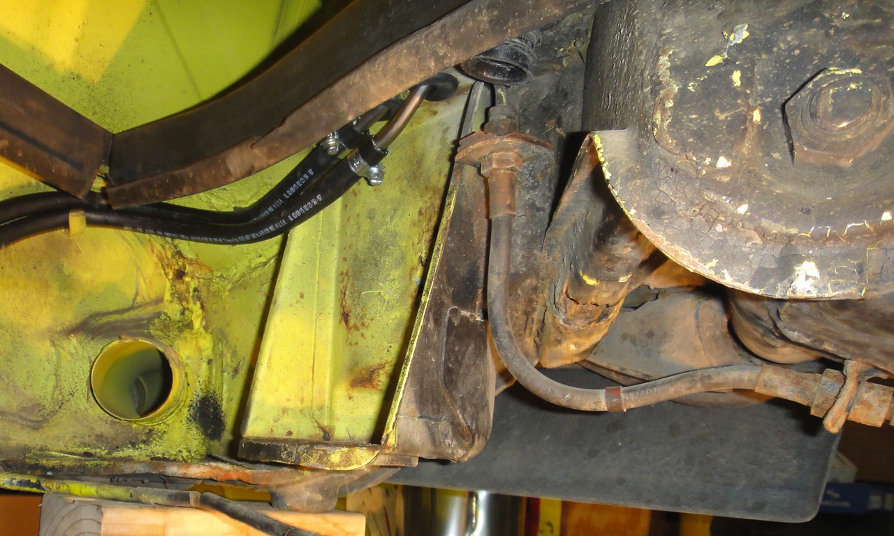

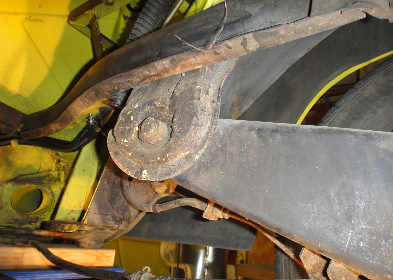

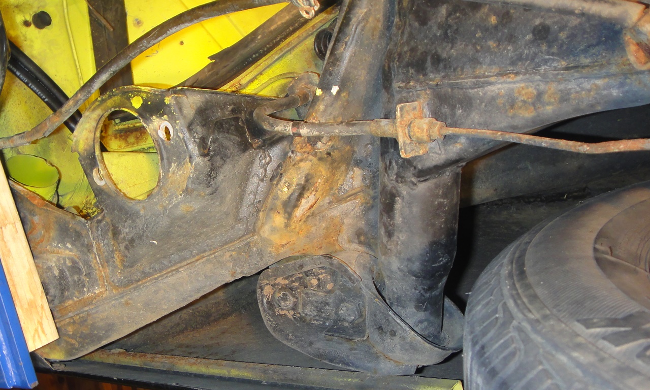

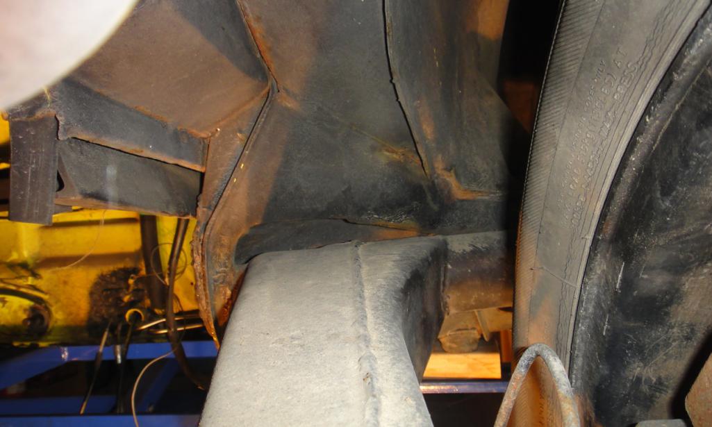

Here is what I am looking at
Looks like the previous "restoration" addressed the hell hole from above and the battery shelf, but with a somewhat crude approach. I do not want to step onto the slippery slope of rust repair, but I would like to get at least 10 years before I have to worry about this again. Not racing or tracking the car. It is just a weekend fun car/old man project. Has mild 1911 with stock FI going back into it with stock wheel widths.
Attached Image Attached ImageAttached ImageAttached Image
and the battery tray as it sits

As is normally the case you have more issues lurking.
Check out the inside of the chassis motor bar mount.
It also looks like the bottom of that area has been patched. (IMG:style_emoticons/default/sad.gif)

QUOTE(914werke @ Nov 23 2015, 07:50 AM) *
It appears that the last restoration did the repair and replace on the top, but thought that a little surface rust on the inside of the suspension console was not an issue. Now many years later, we know what happened.

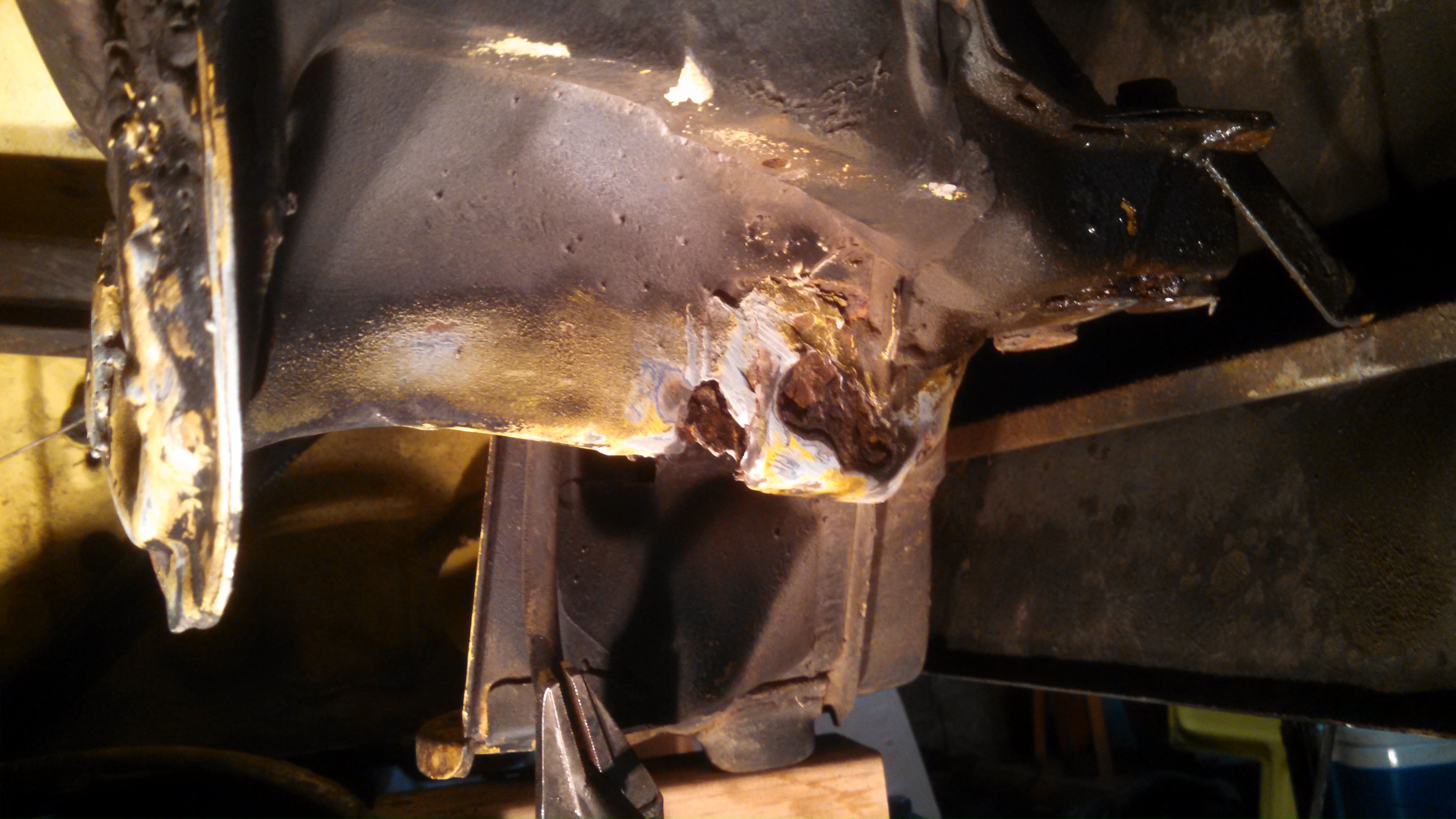

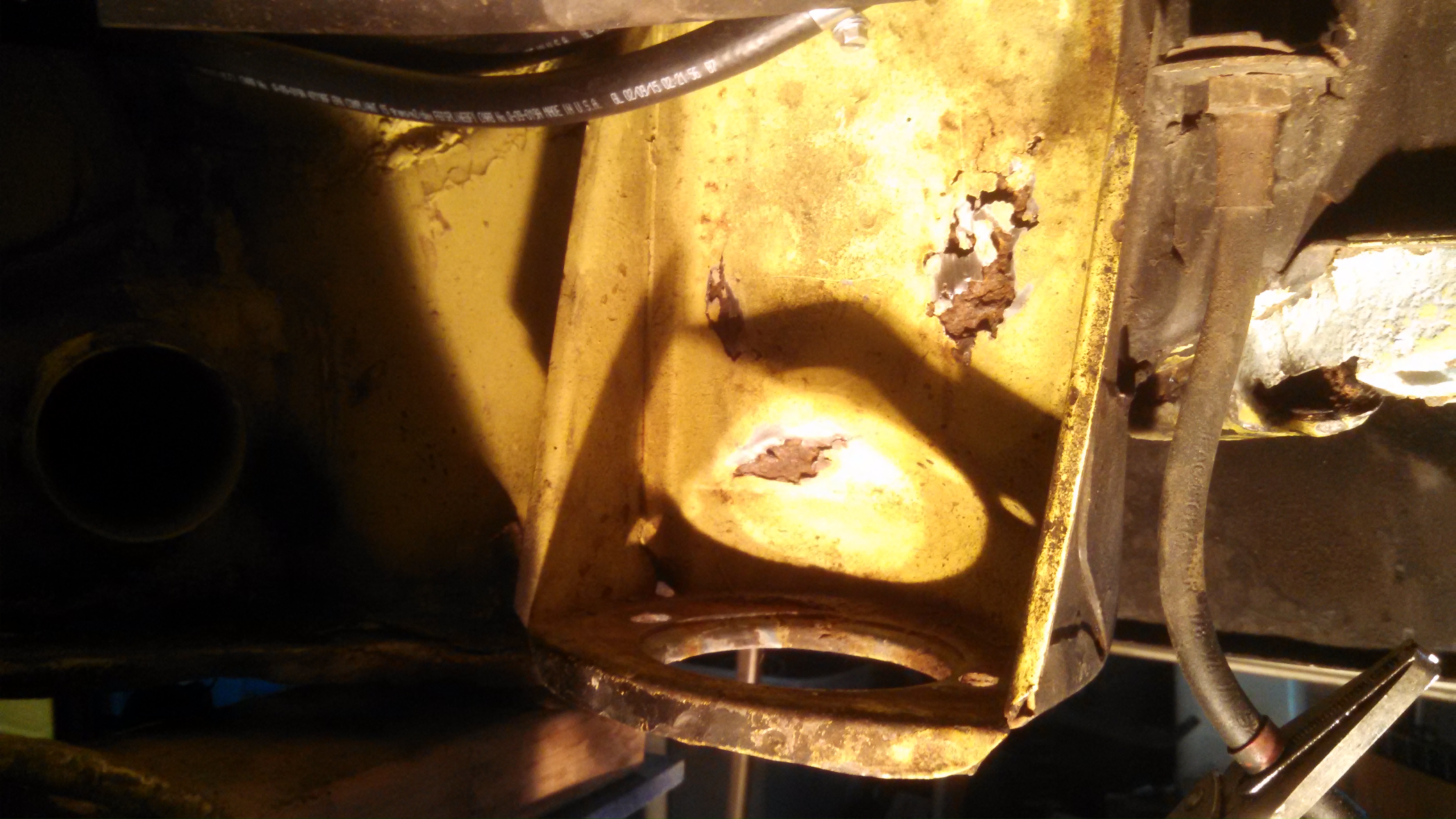

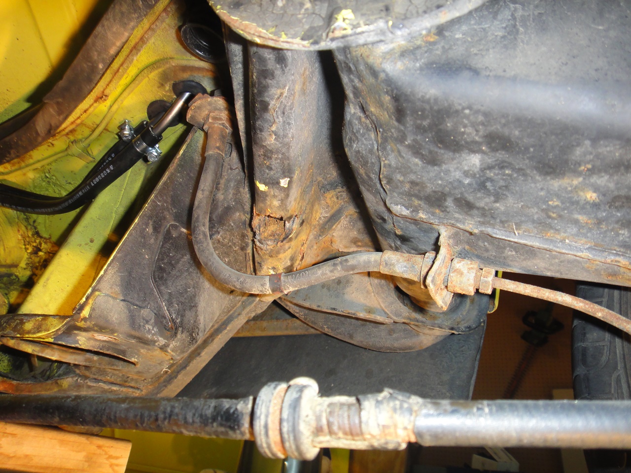

Cleaned up the rust area to reveal the extent of the damage.
That is a pretty big hole.
This seems less critical
Is it a bad idea to try to patch this rather then replace the panel? I am juts looking to make the car safe to drive and enjoy. You can see that if I want to do restoration, there is a lot of work to be done (no jack channels on sides, home made battery box etc).
My fear is that if I cut this apart and try to weld in a new piece, I will find that the panel behind the console is too rusty to weld in my new piece(fairly likely) or that I will not get things lined up correctly as they go back together and have repaired the rust but ruined my car (less likely but more embarrassing).
914werke
post Nov 25 2015, 01:28 PM
Posts: 11,606
Joined: 22-March 03
From: USofA
Member No.: 453
sorry to say...Tip o' the ice burg.

post Nov 25 2015, 07:12 PM
Posts: 182
Joined: 9-December 07
From: Fort Worth
Member No.: 8,439
QUOTE(rdauenhauer @ Nov 25 2015, 11:28 AM) *
This is why I am interested in an option other than the iceberg. I am in no position to take on an entire iceberg at this point. It might be better for me to get this one back together and sell it at a loss and start over.
Or make a serviceable repair, put it back together and enjoy it until I am ready to tackle ripping of that whole passenger side engine bay area to deal with my concealed iceberg.
