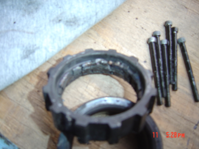

I laeft the house this morning to drop of a load of scrap metal and pic up some new stuff for some jobs. On the way home I hear this gnarly growl coming from the drivers front. Pull over sounds goes away. Get back up to speed (65) sounds gone, 2 miles later it's BACK and worse. Get off at the next exit, as I am approaching the intersection I find that I have NO, ZIP, ZERO, NADA, ZILCH, brakes (IMG:http://www.914world.com/bbs2/html/emoticons/ohmy.gif) Drop the truck into neutral, swing wide and coast to a stop.Look around,look under and find........nothing (IMG:http://www.914world.com/bbs2/html/emoticons/confused24.gif) Put it in drive and coast up the road to a school, stopping via e-brake. Call AAA,cal my dad to bring his truck for the trailer and check the brake resevior........FULL?? Then I notice my pass wheel isn't straight,must be the damn wheel bearing! But out of the blue?? Got home rain starts two hours later I pull the wheel off and find over an inch of lateral play in the wheel?? Took 2 hours to get the wheel off because of an exploded Warn hub (IMG:http://www.914world.com/bbs2/html/emoticons/headbang.gif) Inside of hub "now with metal chips"MMmmm MMmmmm good!

The two pieces on the ground are errrr were one of the bearings

These are the larger pieces that I found (IMG:http://www.914world.com/bbs2/html/emoticons/sad.gif) the black mass is about 3/4 of the chunks and chips that were in there

Last one. The inner teeth are actualy filled up with fused metal. (IMG:http://www.914world.com/bbs2/html/emoticons/finger.gif) Warn. The hubs are only two years old and have maybe 6 months worth of drive time on them (IMG:http://www.914world.com/bbs2/html/emoticons/sad.gif)

I havn't gotten that far yet. It got dark by the time I was done inspecting the hub and spindle. It actually would get a little (very very little) pressure if I pumped it. Right now I'm assuming the two are coincidental, (IMG:http://www.914world.com/bbs2/html/emoticons/confused24.gif) because I can't see how they could be connected. I'm guessing either the master cylinder is bad or something has obstructed the inlet side of the proportioning valve.I used to plow snow with this thing and it has caught HELL between that and towing. I'm going to replace the whole braking system... I think (IMG:http://www.914world.com/bbs2/html/emoticons/sad.gif)

When the bearings failed the brake rotor tilted and pushed the piston in to the calliper.
When you pushed on the brakes it tryed to take up that extra space and went to the floor.

your caliper blew up when the rotor hit it. overheated, blew out the seals and drained all the brake fluid.
i had that happen to the 914 once. not fun ...

(IMG:http://www.914world.com/bbs2/html/emoticons/dry.gif) Wrongo, reread my original post, I lost NO brake fluid and my rears went out also. I also checked all lines front to back and none are cracked busted or leaking.I could understand if only the fronts went, but the rears being on a seperate circuit indicates something wrong between the master cylinder and the prop. valve. I'm going to fix the wheel first and then attack the brakes. I also had a revelation last night on the reason for the hub/bearing issue. I think the c.v. joint in the axle (2piece, full floater) was wearing causing the outer axle to run around,thus eating the hub and bearing simutaniously (IMG:http://www.914world.com/bbs2/html/emoticons/confused24.gif) Thoughts on that?

Just for anyone interested (curious) Autopsy #1 is complete and the culprit for the hub explosion was the universal joint in the axle. (inside the steering knuckle) I had thought it was worn and wqas running wide...quite the opposite. One side had actually frozen so it was only moving in one direction instead of circular thus eating away at the bearing and hub. Sorry Warn for blaming you (IMG:http://www.914world.com/bbs2/html/emoticons/sad.gif) Part 2 of the autopsy will be perfomed on the braking system once the axle is fixed.(spindle,hub,outer axle, bearings)
