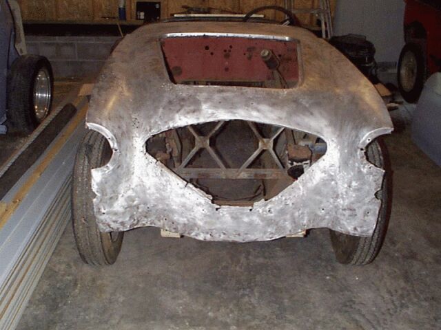

CptTripps
post Mar 14 2005, 07:50 AM
:: Punch and Pie ::
Posts: 3,585
Joined: 26-December 04
Member No.: 3,342
Found the part to upload pics!
Here's a shot of a half-naked teen...from the rear. (I crack myself up)
(IMG:http://www.hardman.org/pix/914_progress/914_progress-Images/90.jpg)
