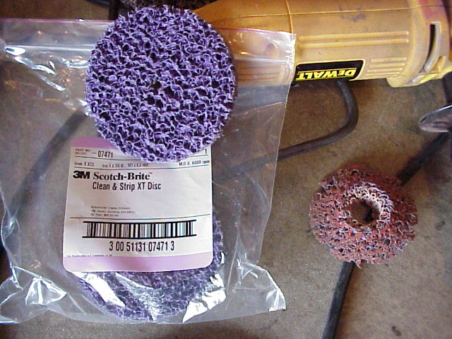

I should have posted this before. It's in my "rusto" thread.
There is nothing, and I mean NOTHING, that removes paint better than these things. And without tearing up the metal or overheating and warping the panels. Eastwood sells a 6" version also which would work so quickly, you won't believe it.

I edited my post above yours Scott. The 3M pads don't warp panels either.
I'm tellin ya, NOTHING works better. You can spend 5 times longer sanding.

Hey Gint, did you hook those 3m pads on a grinder or drill? I have not found an arbor for an angle grinder. Drill sucks, works good with the tiny rol-lock pads in tight spaces.

Where can I buy a bunch of those? Looks like Gint is getting them in bulk.

You can get those 3m disks from an auto paint supply house.

Those 3M disks leave a fairly fine finish as compared to how aggresive they *look*. Much less aggressive than 80 grit. It will suprise you.
You want to run them at a slow speed like on a slow electric grinder or sander/polisher. Less than 3K rpm.

Yup. That's where I get 'em. The next time (if there is a next time) I'll order some 6" units from Eastwood. I could not find 6" disks any where else.

So the 3M Pads I bought with the drill attachment SUCK. Yeah, they'll get the paint off...but it takes FOREVER!
WHile at Lowes yesterday, I found the grinding-disk pads you were all talking about. BIG F$%KING DIFFERENCE! These things ROCK! BE SURE to buy the 'adaptor plate' before you just go buying disks!
For good measure, I did 2 doors, and 1/2 the hood with one disk. 5 should let you do the whole car. You'll have about $60 into everything, but it's WELL worth it. (Some Lowes have the adapter 'free' in a piggy-back package.)
I hooked mine up to my Milwaukee 10000rpm 4" grinder and it took 10min to do each door, and I was about 10min into the hood when my pad gave out. It DOES NOT grind into the metal any more than...say...300 grit sandpaper. It also leaves a real nice finish. Didn't heat up the metal any more than sanding would have. Dust was a bit heavy in areas that had filler in them, but that's to be expected.
I *WISH* I'd done the whole car this way. Would have made things MUCH easier. I'll have the whole car ready to go in about another hour of 'touch up' with these.
Pics to come...I'm being lazy right now.

So the 3M Pads I bought with the drill attachment SUCK. Yeah, they'll get the paint off...but it takes FOREVER! |
You got the wrong ones then. And a drill doesn't have the torque to get the job done anyway. You need to put the ones I was referring to on a electric grinder/sander/polisher and run them at a reasonably slow speed.

Gint
Mar 20 2005, 07:30 PM
I can't get anything but audio out of that .avi clip.
How about a pic of the 3m disks you bought and whatever it was you ended up using.
