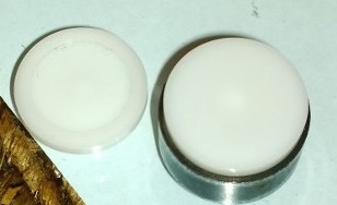

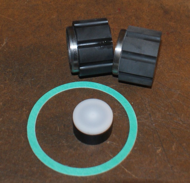

Dude, what do you need?
I make the pucks for Stoddard right now. You can buy them there no problem.
I would like to put together a seal kit for these, as I'm currently also working on the bellows too.

Well I have the #7 cap, I'll look at the #19
I assume these have the same threading, not a left and right. Same part for both?

No threading, just held in by a clip.
That is what the notch is for.
I made mine from bronze, nothing was available at the time.
They get loose and worn out, white plastic.
The seal breaks down, then dirt gets in there.
Now, if you were to manufacture a new pinion gear to reduce the throw of the whole unit, you would sell more than a few.
A good kit should include all the seals and boots, along with the two bushings at the end, and the two little bearings for the pinion gear.
I recall that the pinion gear housing changed between early and late, so if you pick late to fabricate, you will pick up the 911 market also....it's the same rack.

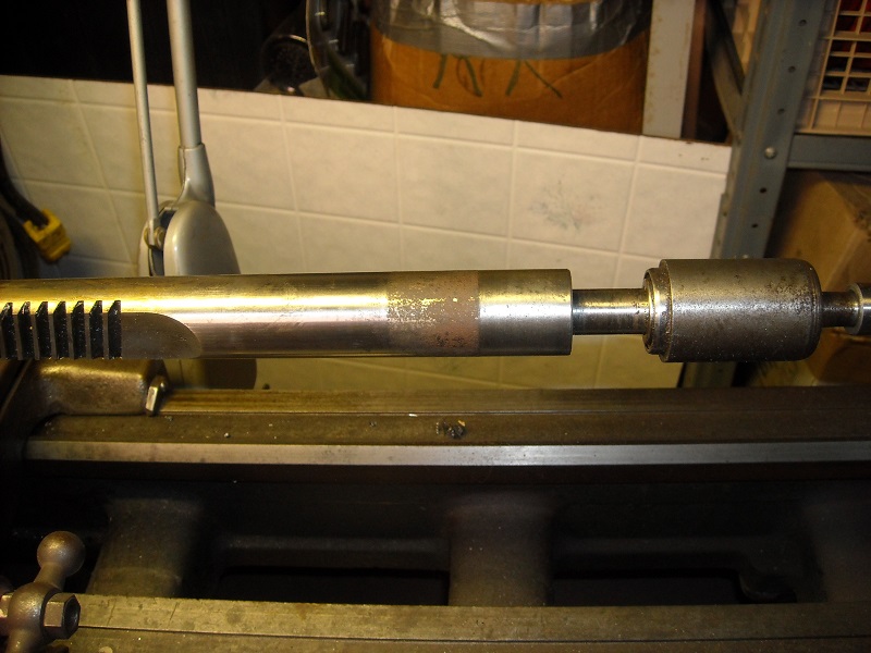

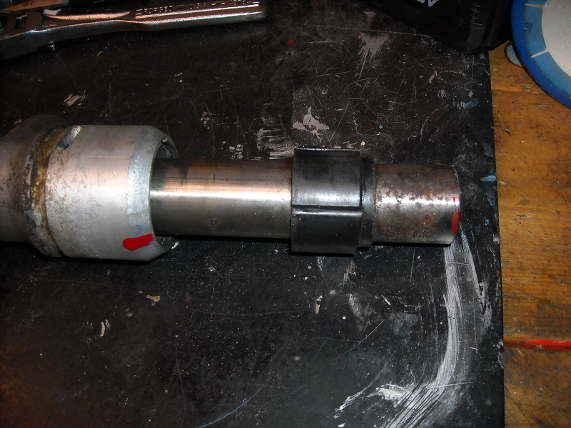

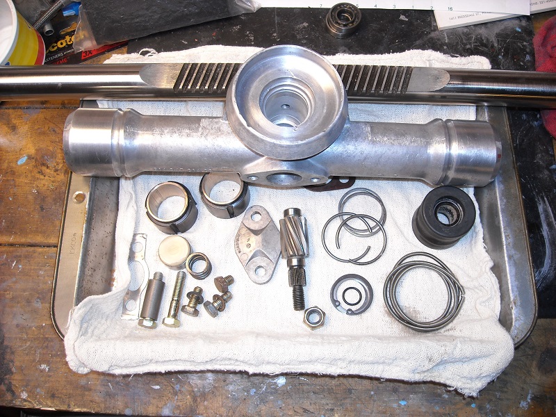

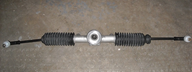

Well finished up the steering rack.
Turns out the end bushings are really NLA...
managed to save mine. put a little heat on the rack and with some more PB blaster I got them to move. then shined the rack up with some fine emery cloth on the lathe.

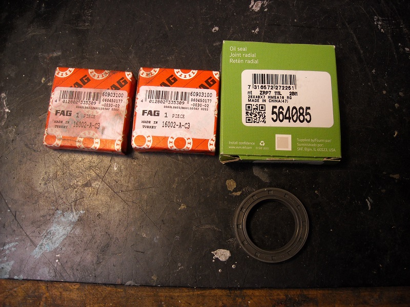

Ready for the new bearings..
and these are the bearings that are used .
FAG 16002
and the seal is a 40x28x7 single lip
SKF 564085
if any one is thinking about doing this, it really is not a hard job. little trick getting out the lower bearing but other than that its a straight forward job.
good idea to mark the rack and housing with a dot of paint so they go back together the same way.
Done.
