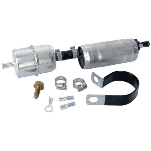

Do yourself a favor and get a rotary pump. The facet pumps are noisy as hell.
I used this one on my 2056:
http://www.cbperformance.com/ProductDetail...roductCode=3193
(IMG:http://www.914world.com/bbs2/uploads_offsite/www.cbperformance.com-179-1416176797.1.jpg)

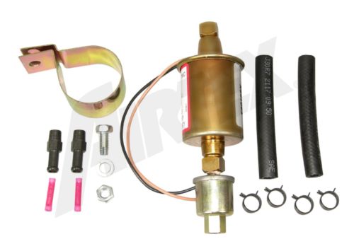

I've used an Airtex E8016S fuel pump (2.5-4 psi) in my 911 for over 20 years. Never missed a beat. Available most anywhere ($15-$51). Price disparity seems to be the result of licensing manufacture to other sources.
E.g.: http://www.ebay.com/sch/i.html?_from=R40&a...6S&_sacat=0
When mounted near the gas tank, normal system pressure drop results in 3-3.5psi at the carbs.
Careful, Airtex makes several versions of this pump type with different pressure specs.

The fuel pump from CB performance is just a Carter fuel pump. You can save some money...
http://www.summitracing.com/parts/crt-p60504/overview/

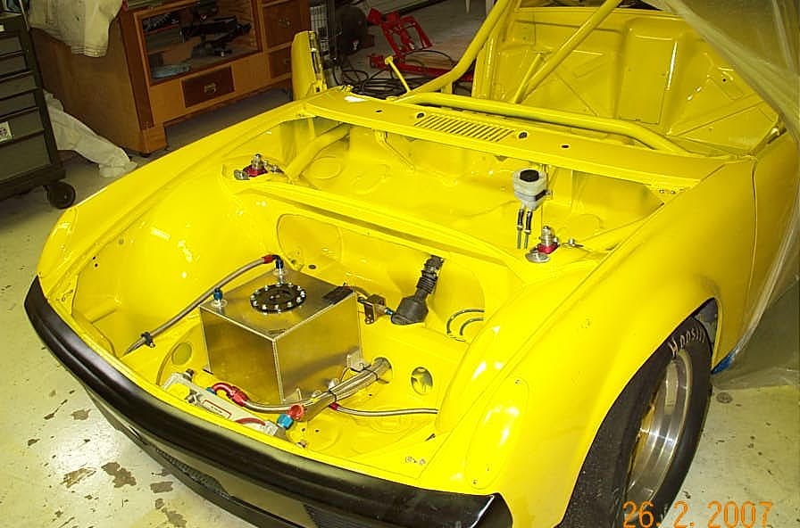

I have had this same pump on my car for 12 years. It has ALWAYS been mounted where you see it in the bottom of this picture. Never had a problem with low head pressure. Never had a vapor lock problem with this 3psi pump. It feeds a 2.2 liter type IV with 44idf Webers. YMMV (IMG:style_emoticons/default/biggrin.gif)

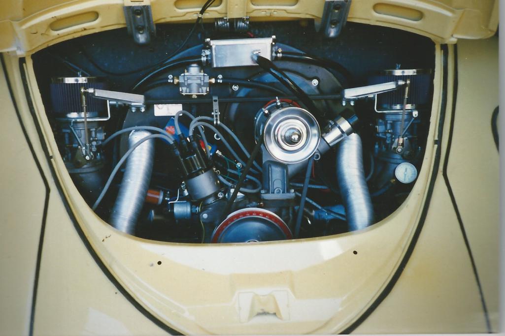

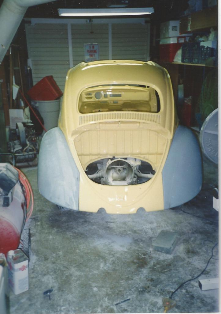

Sat there & pumped away for 12-15 years.Attached Image

QUOTE(J P Stein @ Jan 11 2016, 10:51 AM) *

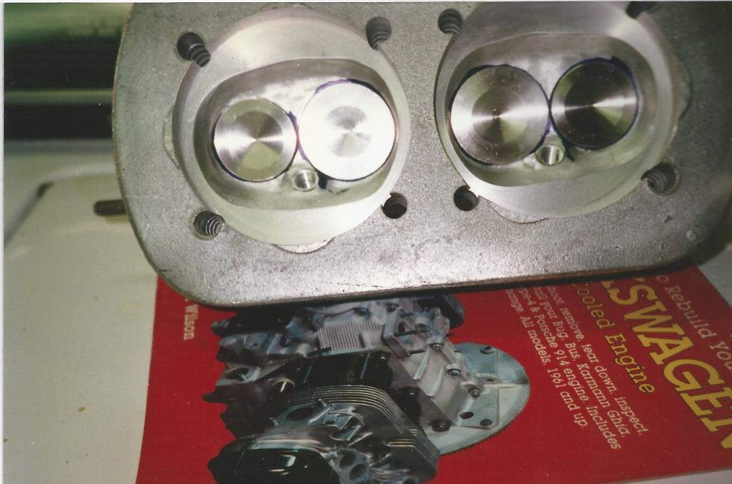

Nobody said they didn't work. I just don't like sitting inside an MRI machine. Somewhat surprised that it worked for you. I had a stroked TI engine that suffered fuel starvation with one.

QUOTE(jmill @ Jan 11 2016, 09:09 AM) *
Ayup, worked fine as frog hair. No regulator, just a straight shot to the carbs. Noisy till you lit off the engine, then it just kinda blender in with the racket.....no shortage of fuel....ever.
The T-4 short, eh?....right. They are such a high demand engine (IMG:style_emoticons/default/rolleyes.gif)
Conventional internet wisdom. me thinks. Ya better get something trick

Actually it was a Type I. Big difference between drags and autocross. You lift. Doubt you had Chevy 2.02 intake valves either.
