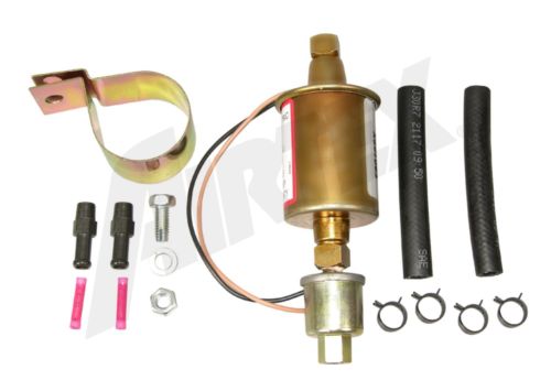

I've used an Airtex E8016S fuel pump (2.5-4 psi) in my 911 for over 20 years. Never missed a beat. Available most anywhere ($15-$51). Price disparity seems to be the result of licensing manufacture to other sources.
E.g.:
http://www.ebay.com/sch/i.html?_from=R40&a...6S&_sacat=0Click to view attachment When mounted near the gas tank, normal system pressure drop results in 3-3.5psi at the carbs.
Careful, Airtex makes several versions of this pump type with different pressure specs.

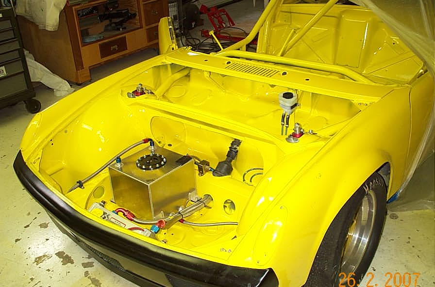

I bought a Bosch 69133 2-port pump for my 74 2.0L. I'll be running this pump when she gets rebuit to a 2270L. I'm putting my pump on the firewall in the engine bay as a few others have done here. I have the SS lines in the tunnel.
The pump up front under the tank is a real PITA if you ask me.
