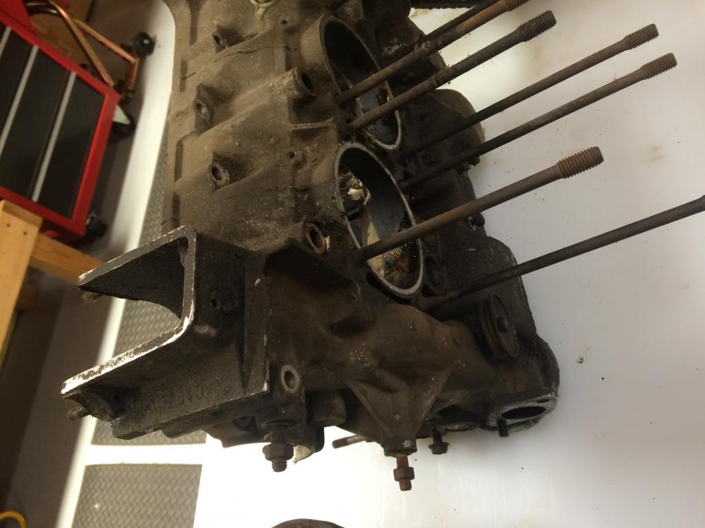

Valy - thanks for the info. The case I am hoping to use does not have a hole for a dipstick. I suppose I can drill one?
See pic...

Why not source a 914 case?

Good question. I had this laying around and hoped to use it (free and all). I may have to buy cases...

Check to make sure it's straight, the crank journals are straight and the deck (where the cylinders sit) is one flat plane.
Most machine shops will tell you to line bore the case without bothering to measure it.
You can measure everything I said above on your own with a good set of tools.

Yup, check condition of the case before you put more work into it. You can drill a new dipstick hole if the case is good.
sdoolin,
Here is a link to the quick and easy dipstick tube fix. It's super easy and very good quality. I've done several. Best part is you can do it locally.
Good luck on your build. It is post #18 down at the bottom of the thread.
http://www.914world.com/bbs2/index.php?sho...stick+tube+fix#
