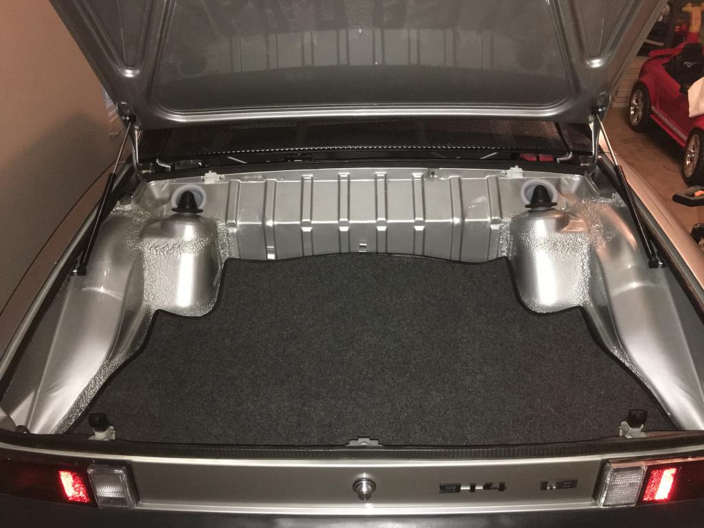

I've seen a pic of the holders attached to a hinge. And the hinge was attached to the trunk. Less risk of snapping the holder when you insert or pull out the roof under an angle.
Can't find the pic though.
Menno

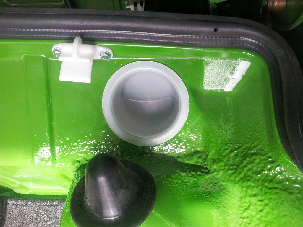

QUOTE(The Cabinetmaker @ Feb 10 2016, 09:09 AM) *
Never seen one riveted. M6 bolt.

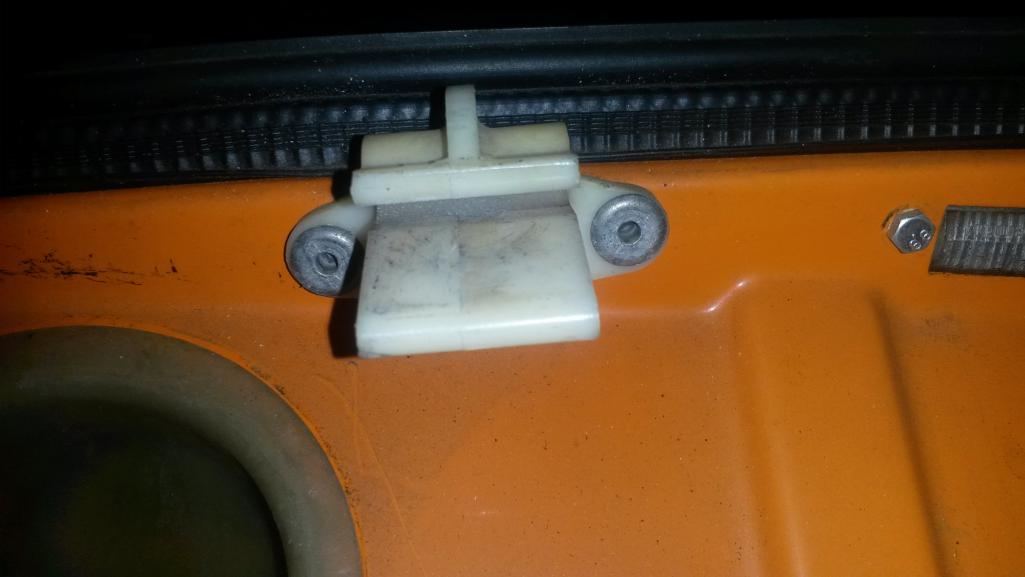

My 76 had rivets. If you want to use rivets get some canopy rivets at Aircraft Spruce. If they aren't made for plastic the pull will squash and split the plastic. If you can't find them on their site PM me.

Ok I just hobbled my butt out to the garage
One side has bolts, the other has these
The side that broke has bolts, so I'll assume that the holes were reamed out to accept them. In that case, rivets are out (IMG:style_emoticons/default/dry.gif)
I kinda do remember a hinged setup for the holders, might anyone have a link?

Kansas 914
post Feb 10 2016, 04:42 PM
Posts: 3,006
Joined: 1-March 03
From: Durango, Colorado
Member No.: 373
Must be an early versus late model year change. My picture above is from my car which is an early '72.
Thanks for the replies.
That was me, but nobody liked it so it seems to have disapeared. Here is the link.
http://www.914world.com/bbs2/index.php?sho...=255071&hl=
