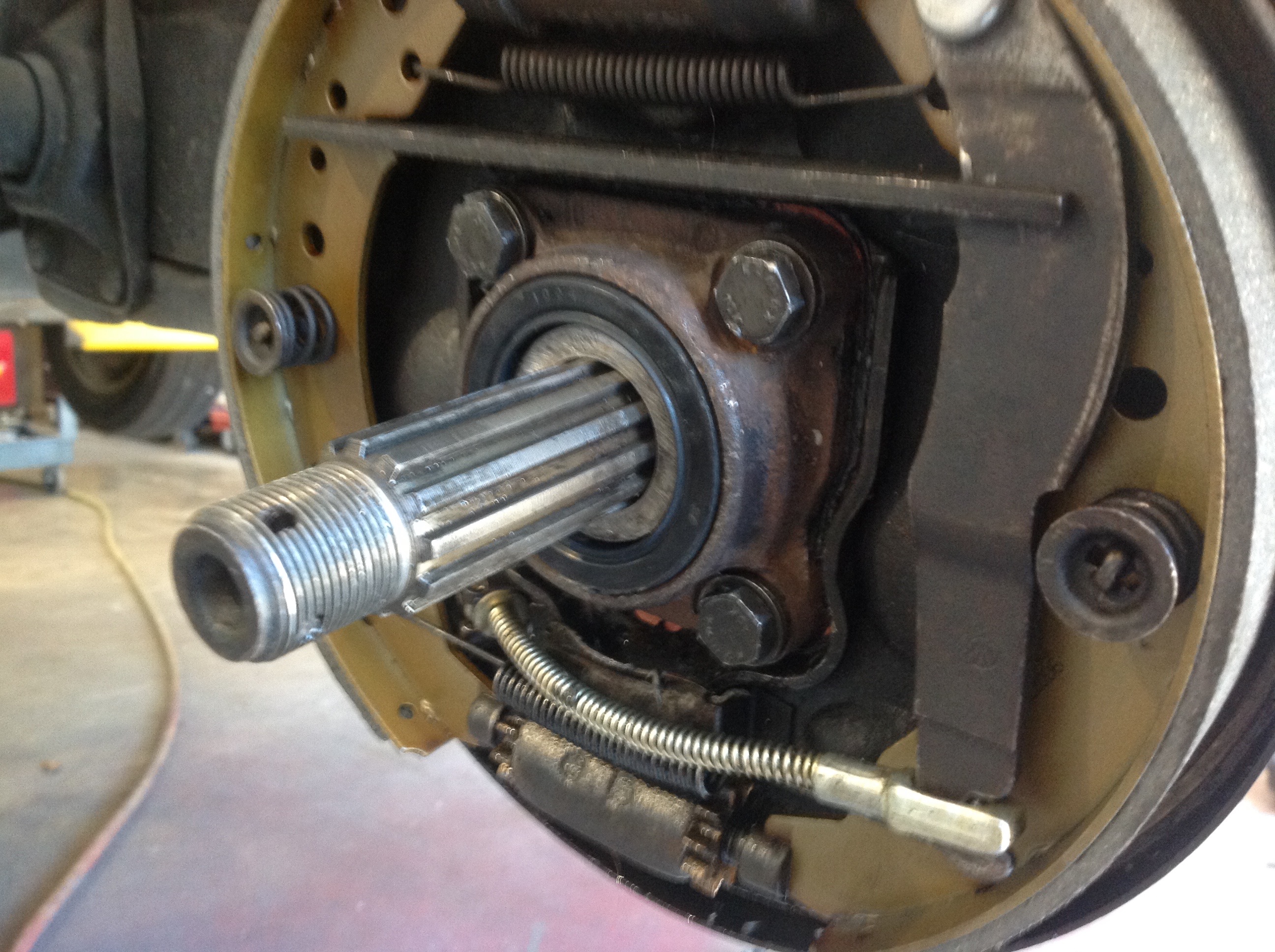

As a VW/Porsche professional, there are always a few things you think about. You know, common things you haven't done yet.
Go ahead and laugh: I'm changing my first swing-axle transmission today. 1965 T-34.
First, here are my thoughts on the swing-axle design: (IMG:style_emoticons/default/dry.gif)

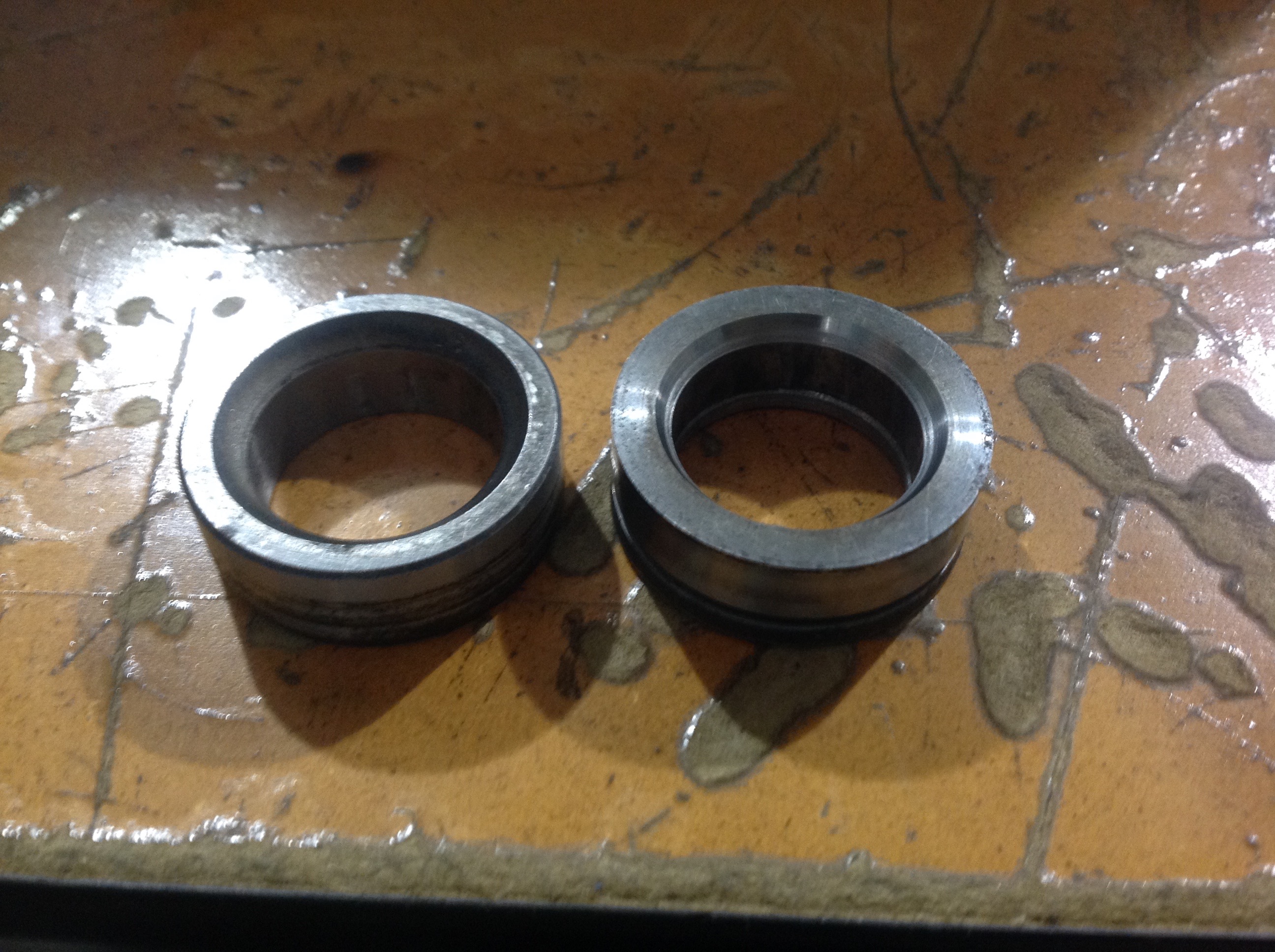

Here's where I need help: The left and right sides had different spacers between the wheel bearing and the hub.
Which one is correct? They are very different thicknesses, and one has an inside chamfer while the other has an outside.
I took them both off before I noticed the difference, so I can't tell you which was where. What I can tell you it the LR brakes were totally covered in gear oil.
Help, please.

You need 2 of the left, the bevel goes against the axle.
The swing hardware changed over the years, there is also 3 different lengths of axles and tubes.
Just for shits and giggles check to see if both sides are the same length. (IMG:style_emoticons/default/smile.gif)

Yes, the thicker one is exactly that. Inner chamfer on one end and outer chamfer on the other.

I was really hoping the shorter one was correct.
I would have already been standing at the lathe... (IMG:style_emoticons/default/smile.gif)
Series9
post Feb 10 2016, 04:50 PM
Lesbians taste like chicken.
Posts: 5,459
Joined: 22-August 04
From: DeLand, FL
Member No.: 2,602
Nothing to see here.....
I went to the lathe anyway.
Chamfer added, spacer created.
