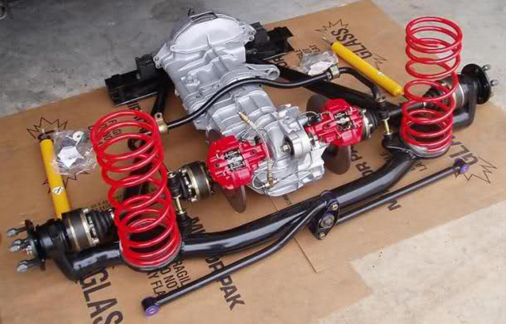

Alfetta transaxle and de Dion rear axle.

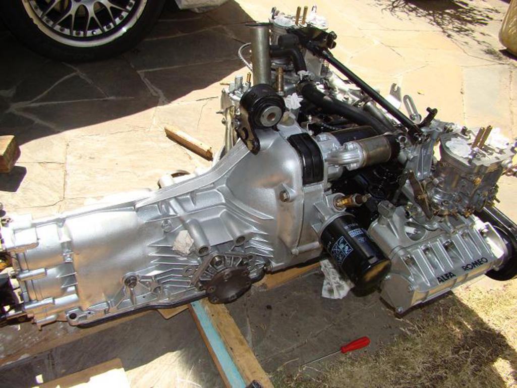

4 speeds
