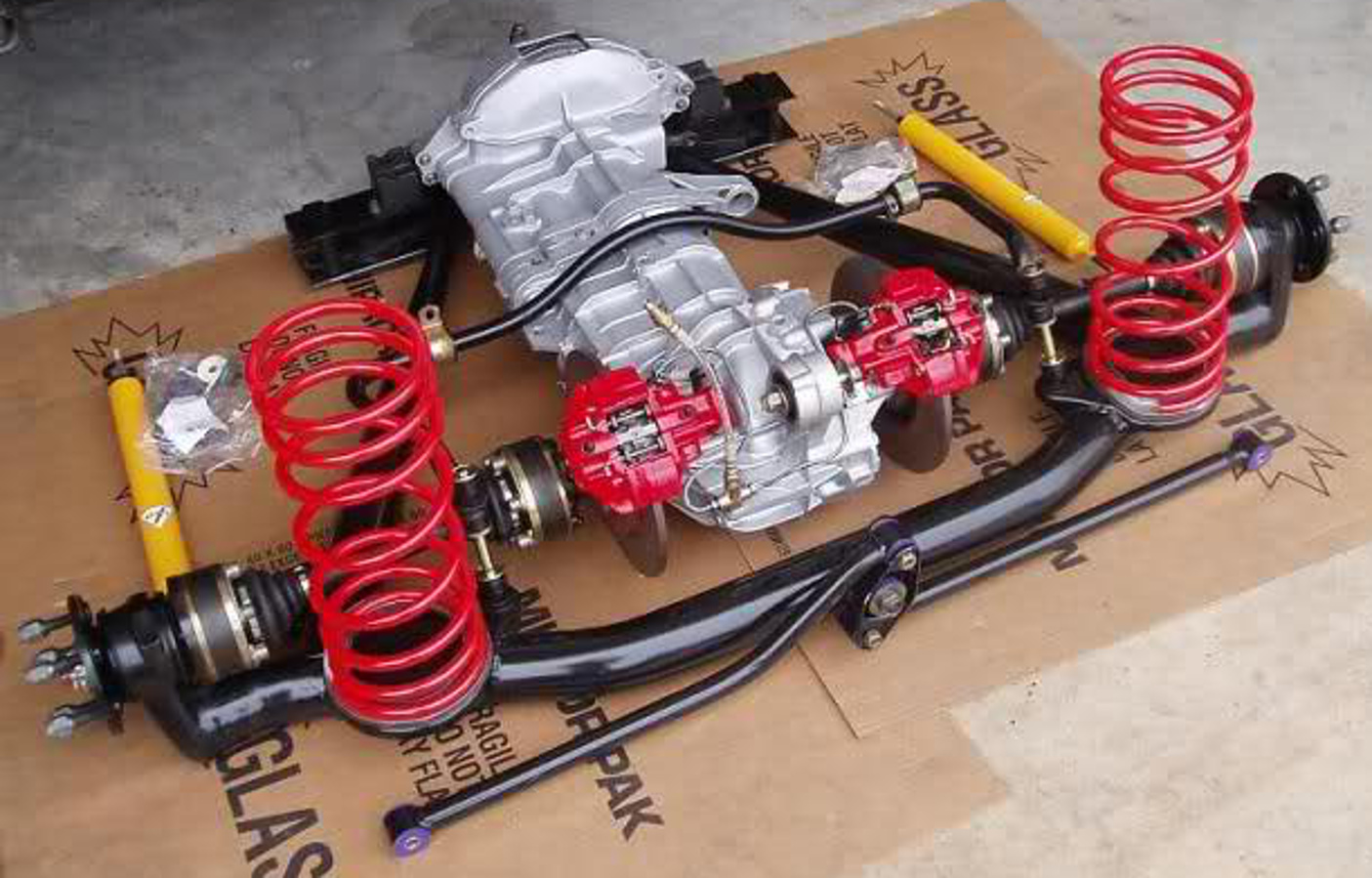

veekry9
Alfetta transaxle and de Dion rear axle.
Dave_Darling
That is one funky suspension!!
Not a big fan of any DeDion setup, personally. Looks like they could have gone to a nice full-independent setup with just a little more work. Less unsprung weight, better compliance over bumps...
--DD
r_towle
Yes, not a fan of the suspension.
Wonder what could be done with that tranny?
How much power could it handle?
steuspeed
The whole package may be too long. Rear mounting point is high. Brake pads are a pain to change. My stock Alfetta brakes are great however. Typical 1st and 2nd gear sycros are usually gone.

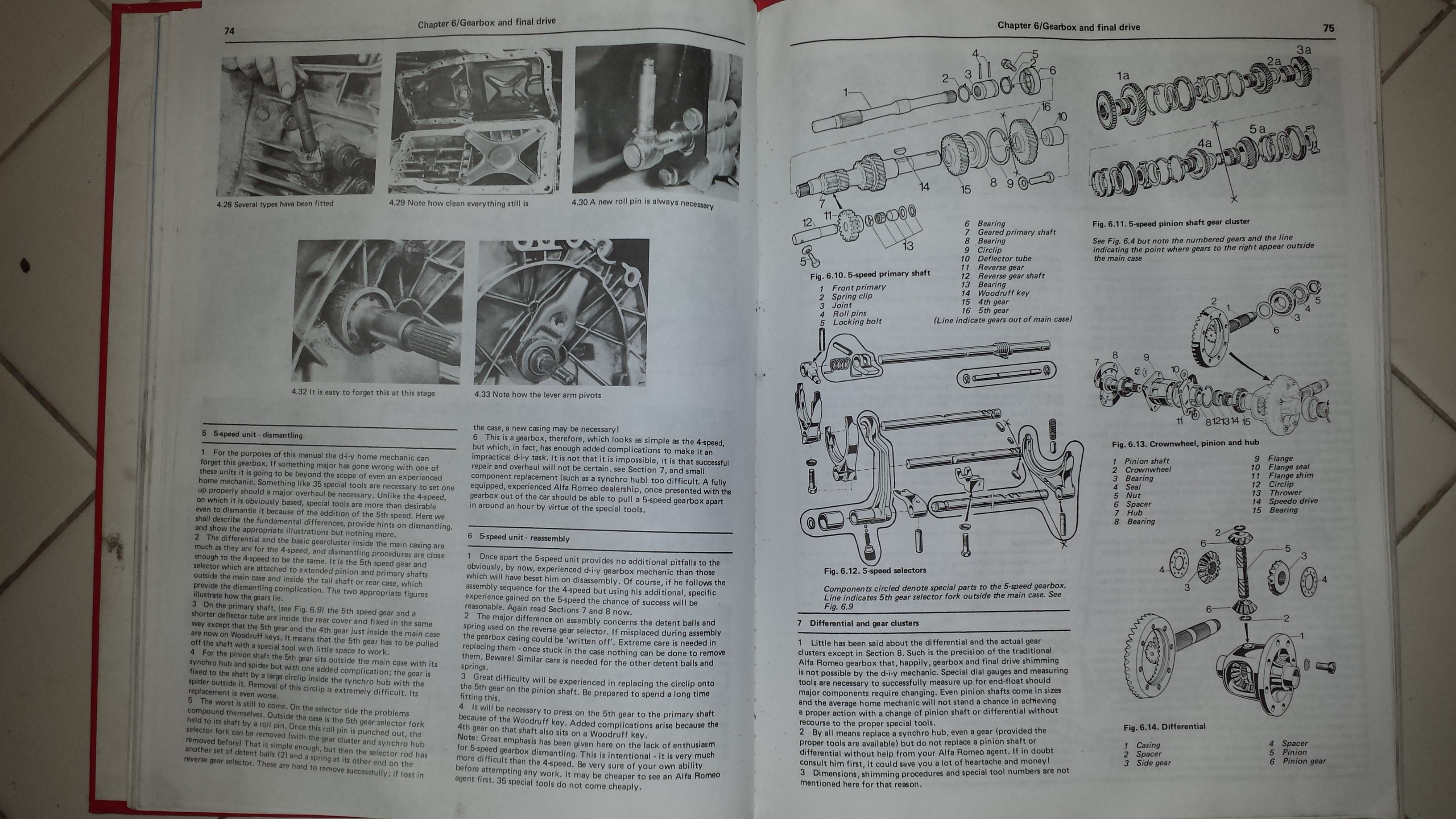

If you want, I have the repair manual. There might be some good info in there.

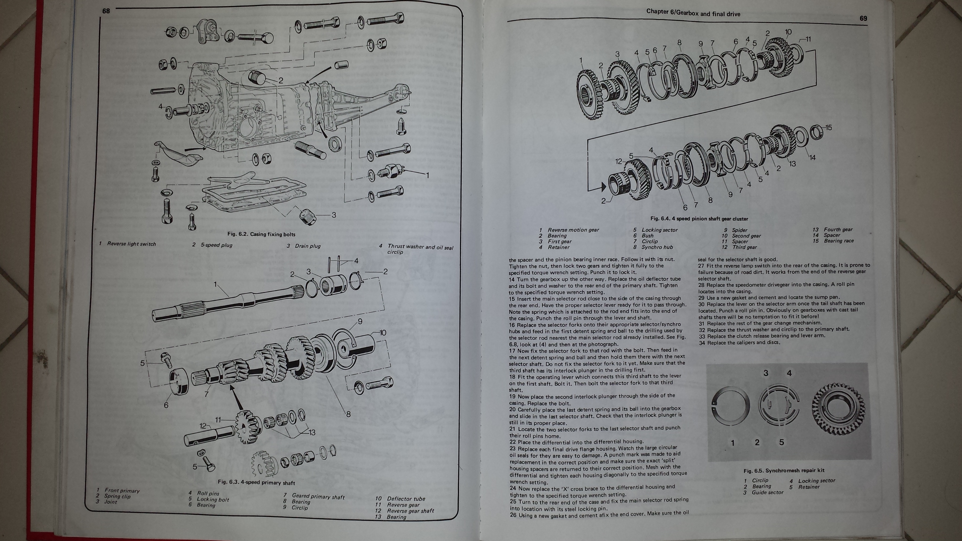

Valy
4 speeds
Valy
5 speeds

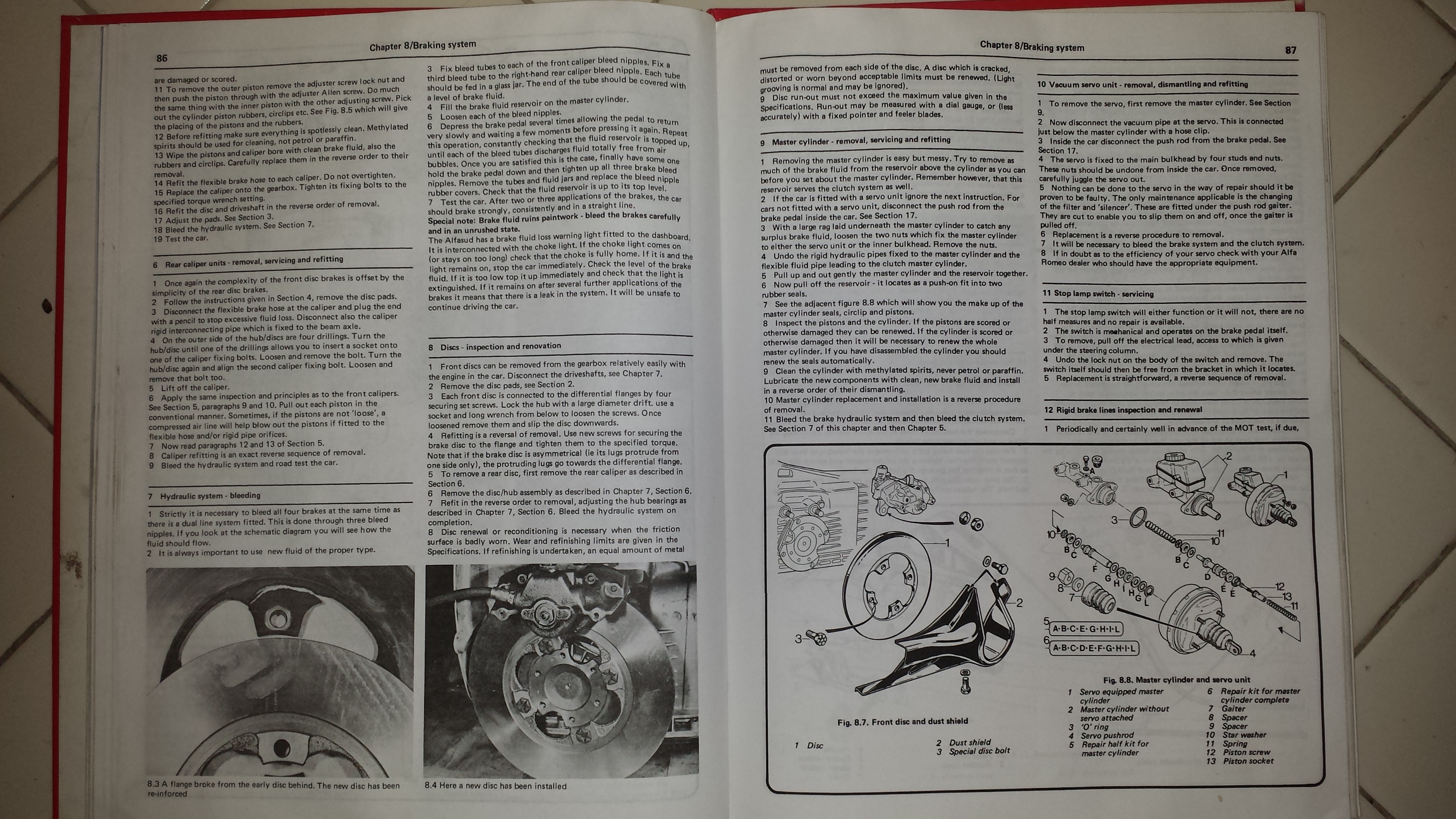

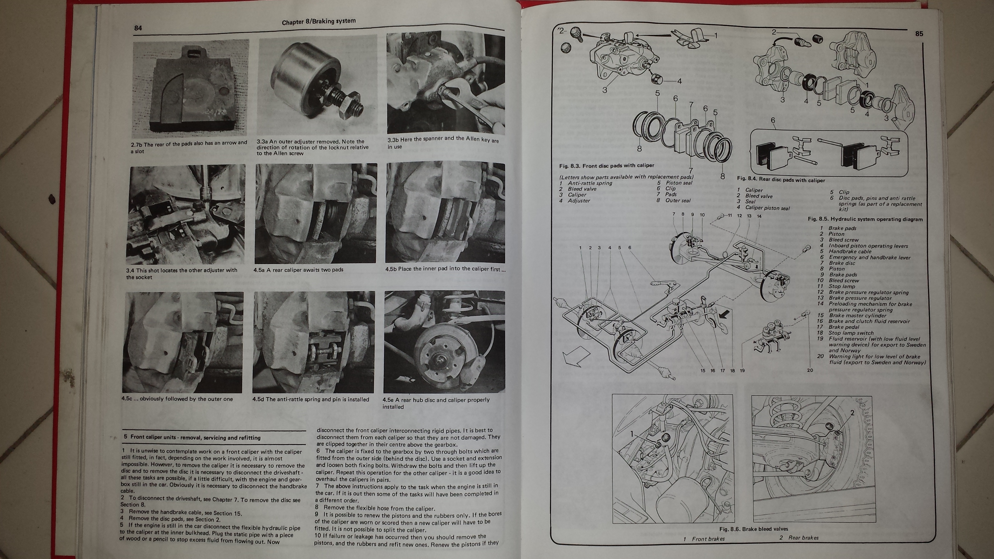

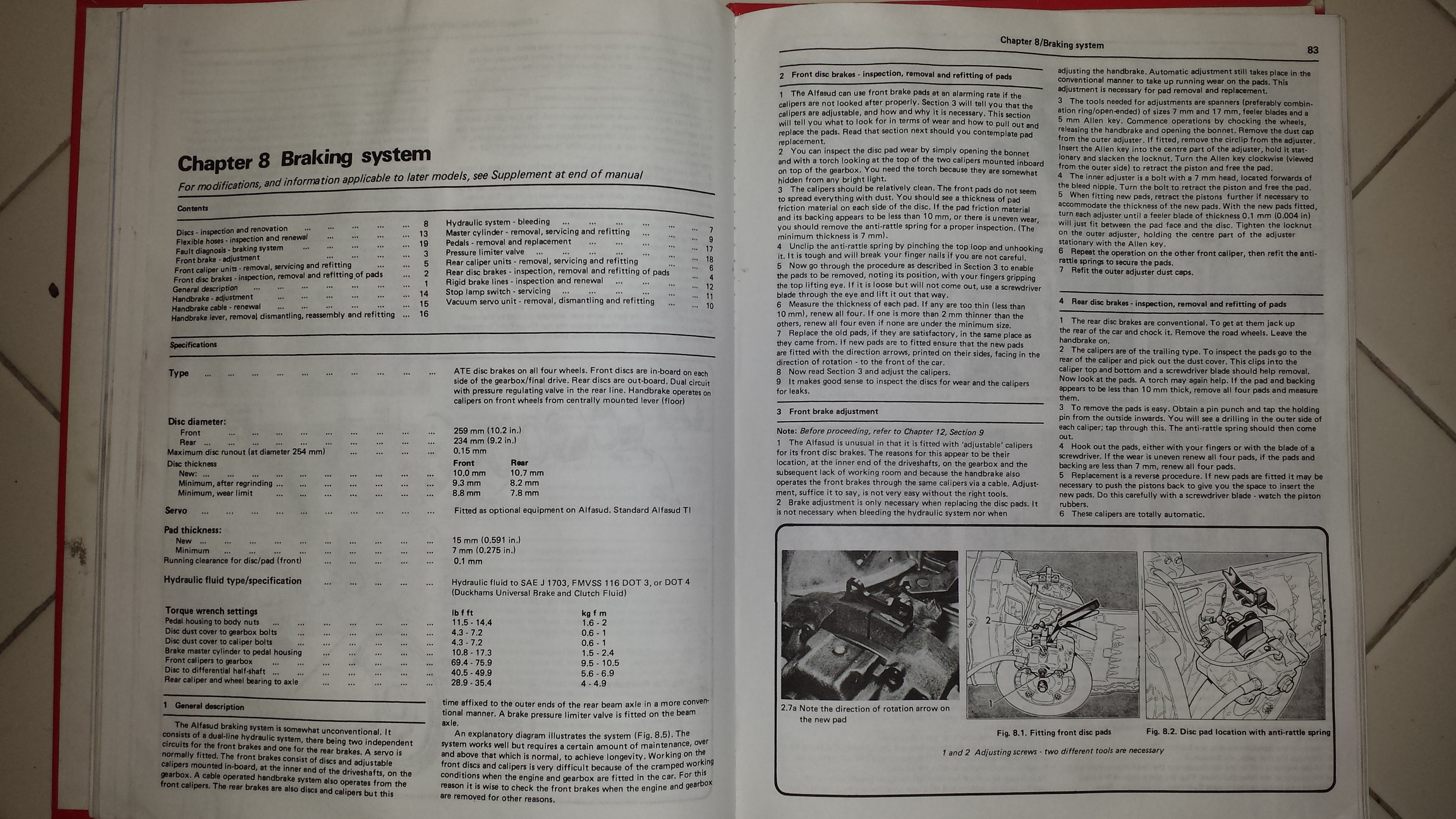

Valy
Brakes 1
Valy
Brakes 2
Valy
Brakes 3

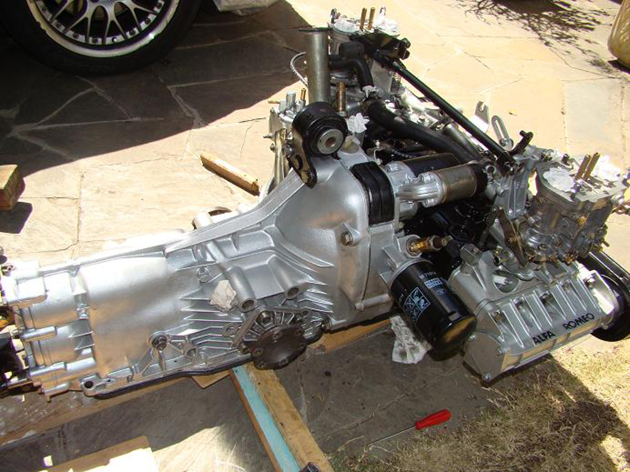

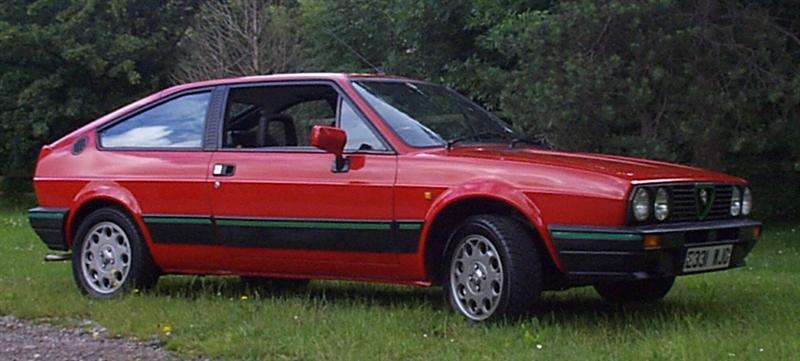

Valy

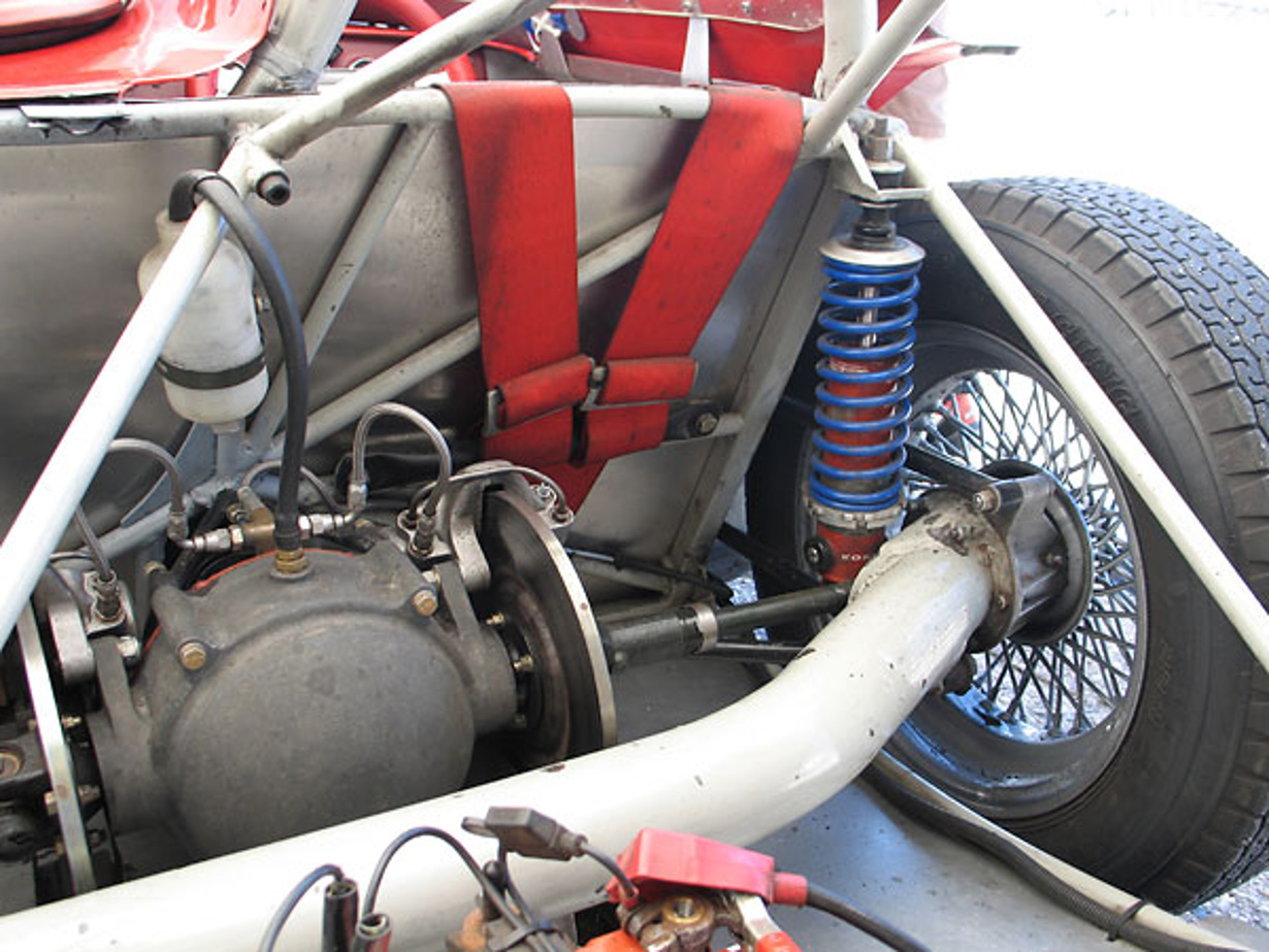

veekry9
Alfa Romeo Flat-4,ZF-transaxle-5 spd.
An attribute of the de Dion is the stability of the toe settings and the roll centers.
The design has been around a long time.
Might be the last time a de Dion won LeMan.
https://en.wikipedia.org/wiki/Aston_Martin_DB3
https://en.wikipedia.org/wiki/Aston_Martin_DBR1

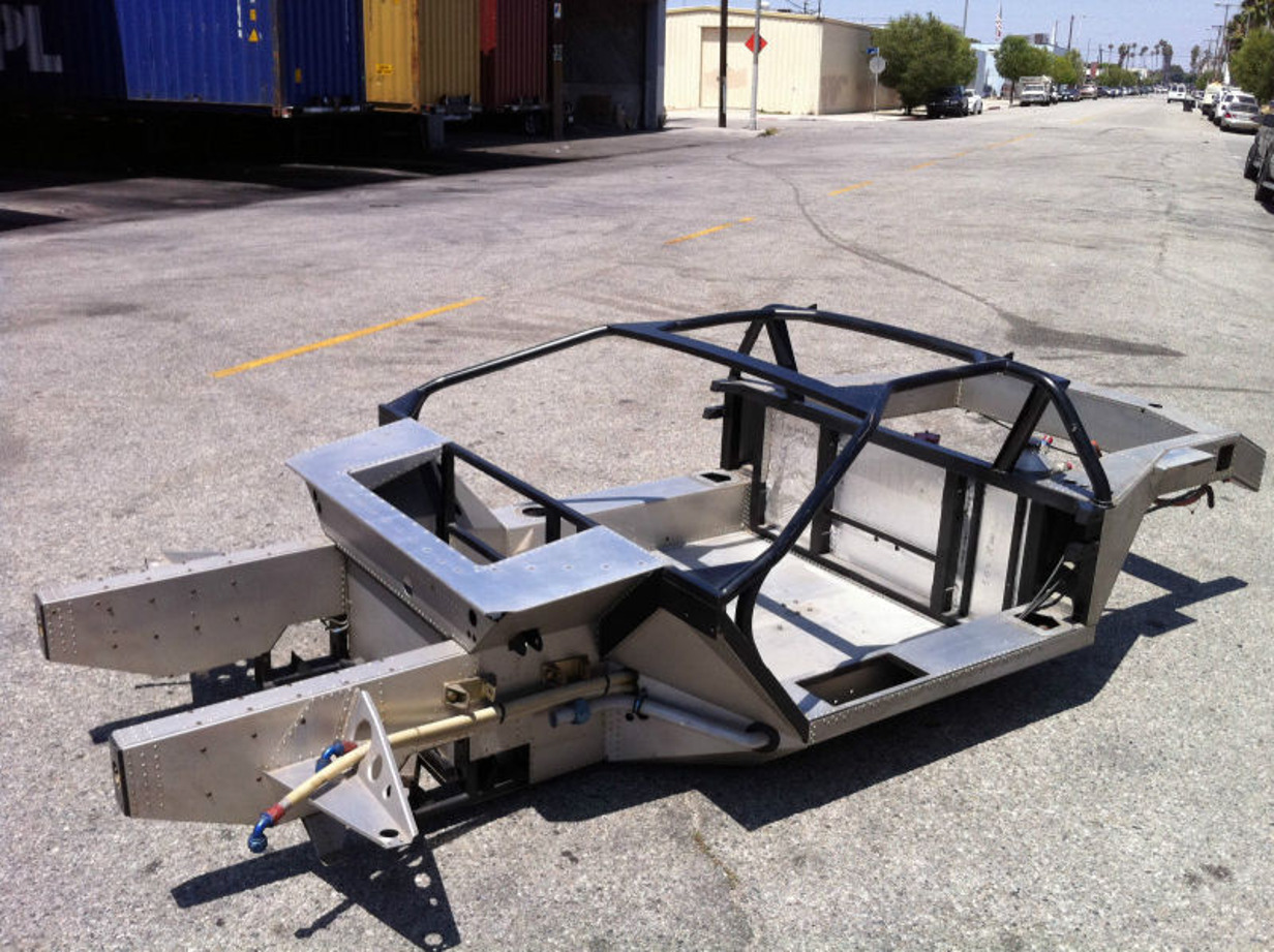

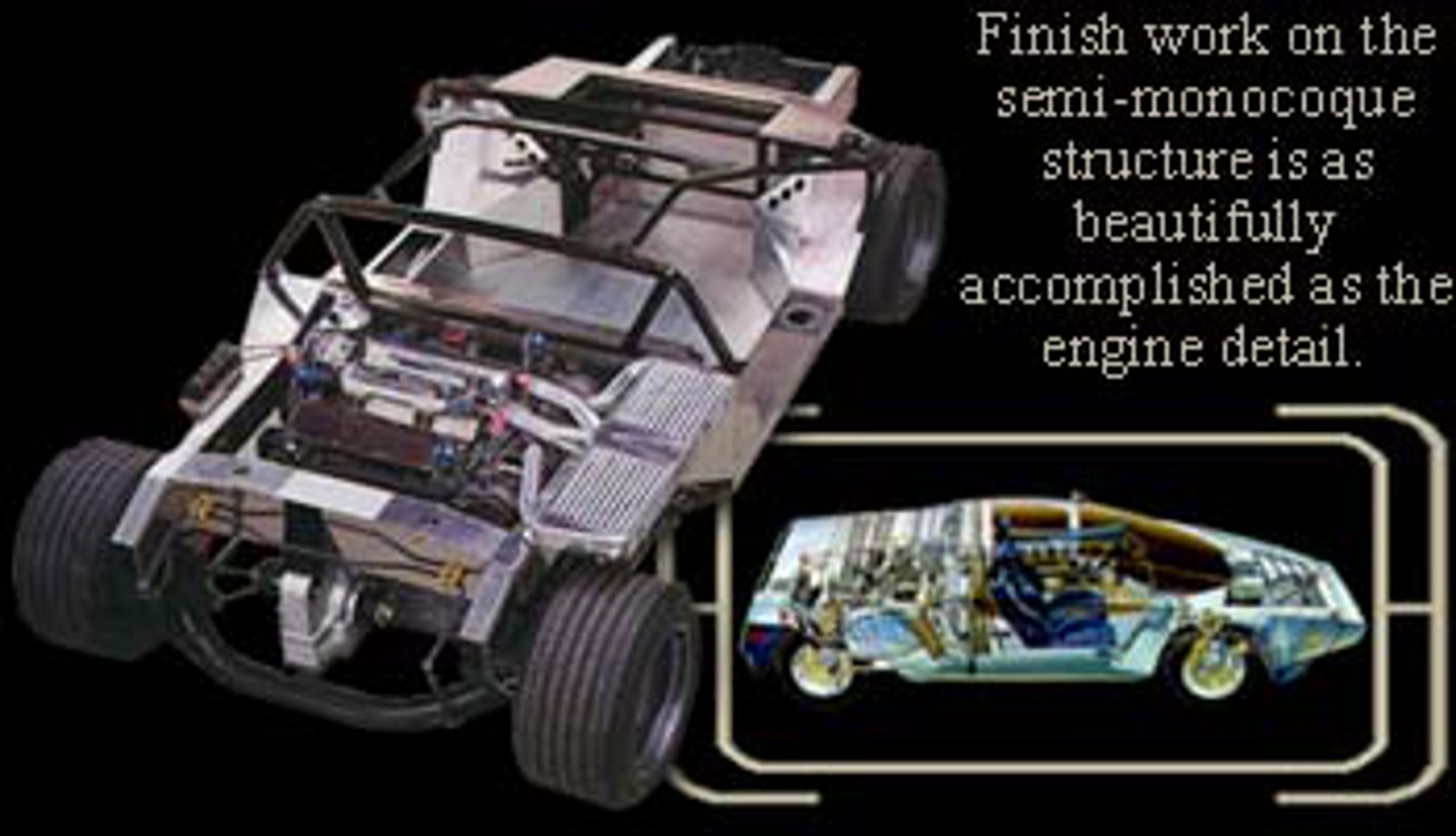

W2 chassis,honeycomb,de Dion.1978.
Lotus Eleven
http://jalopnik.com/turn-this-brand-new-ve...rcar-1677726756
