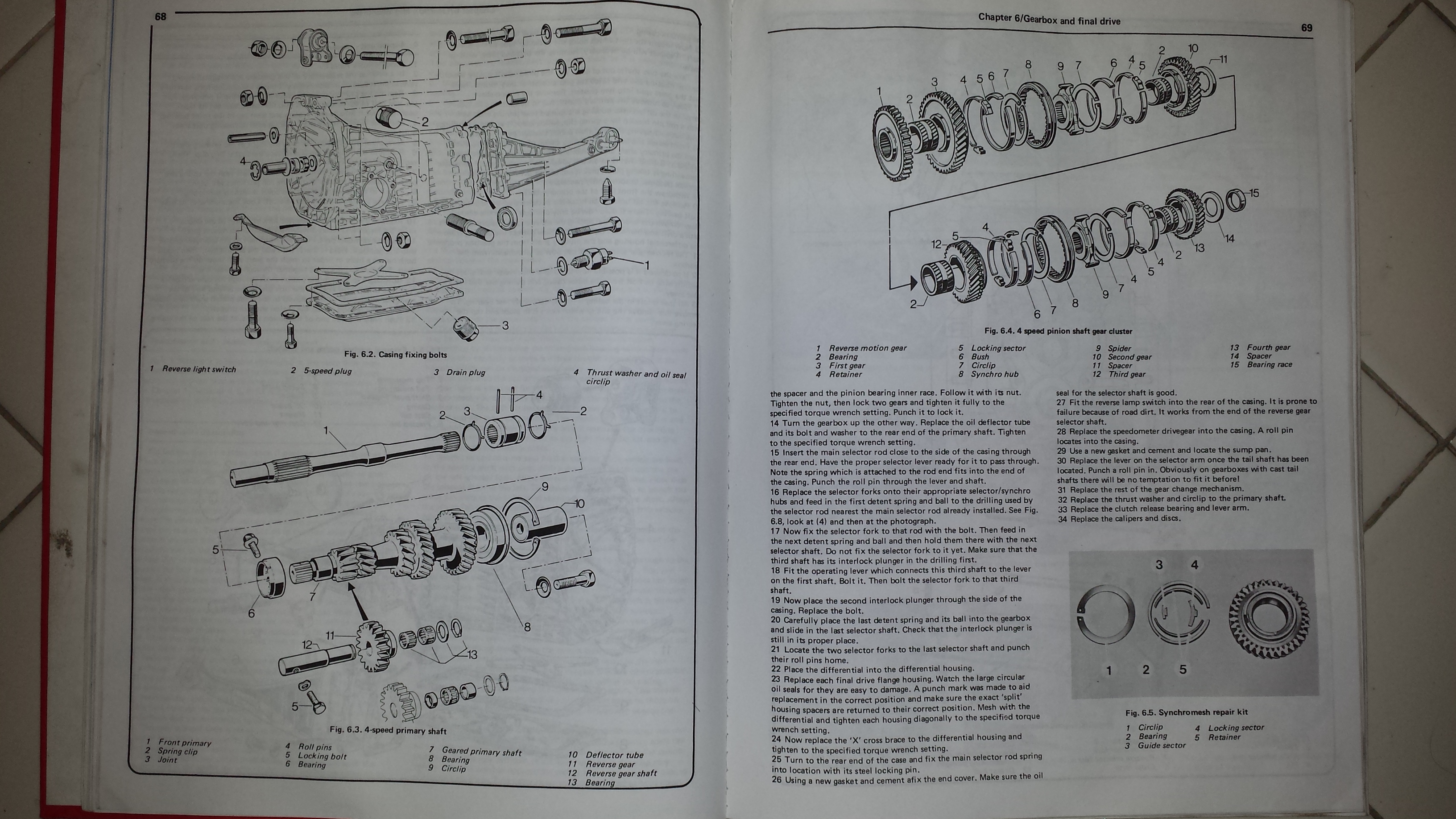

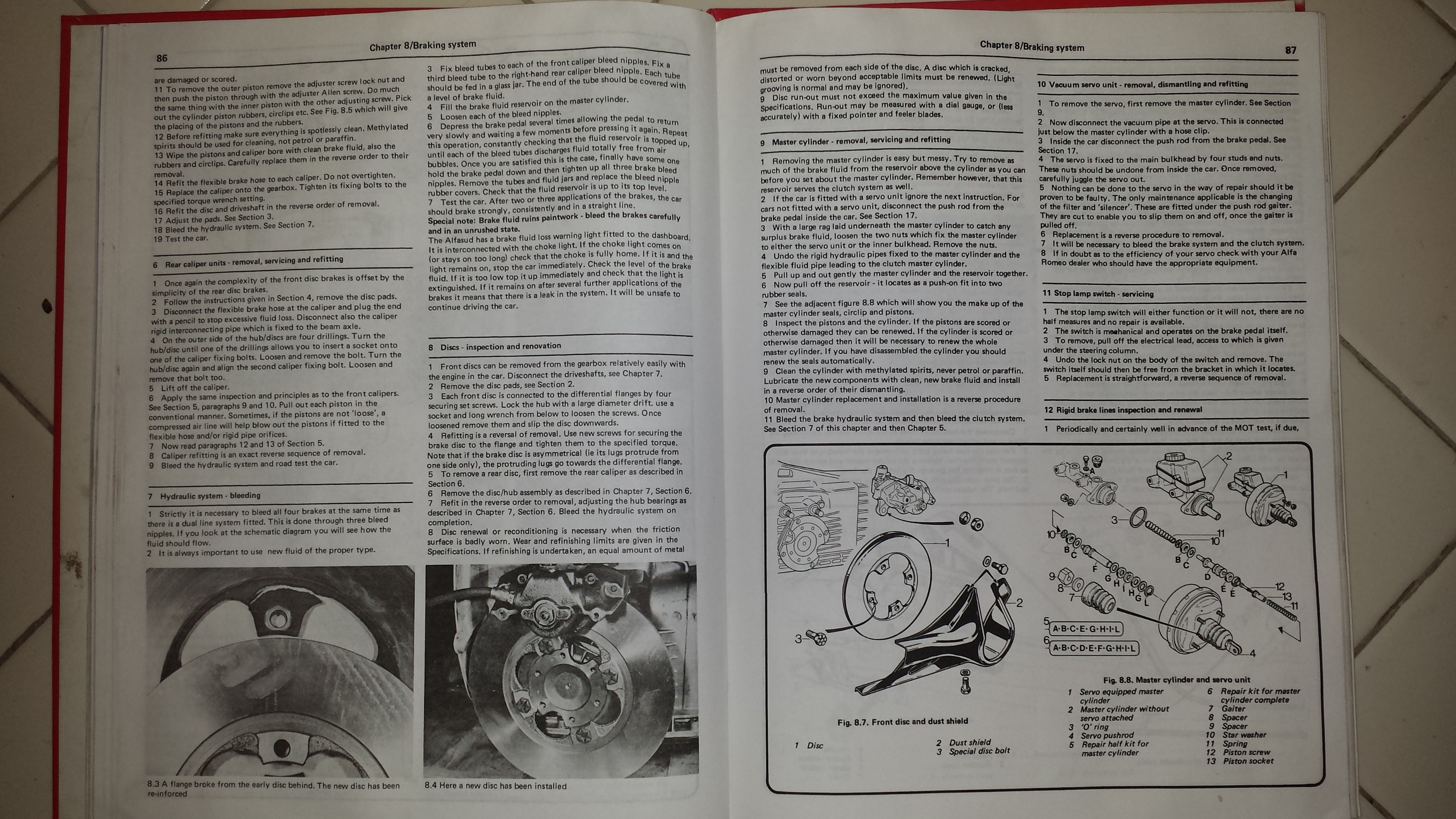

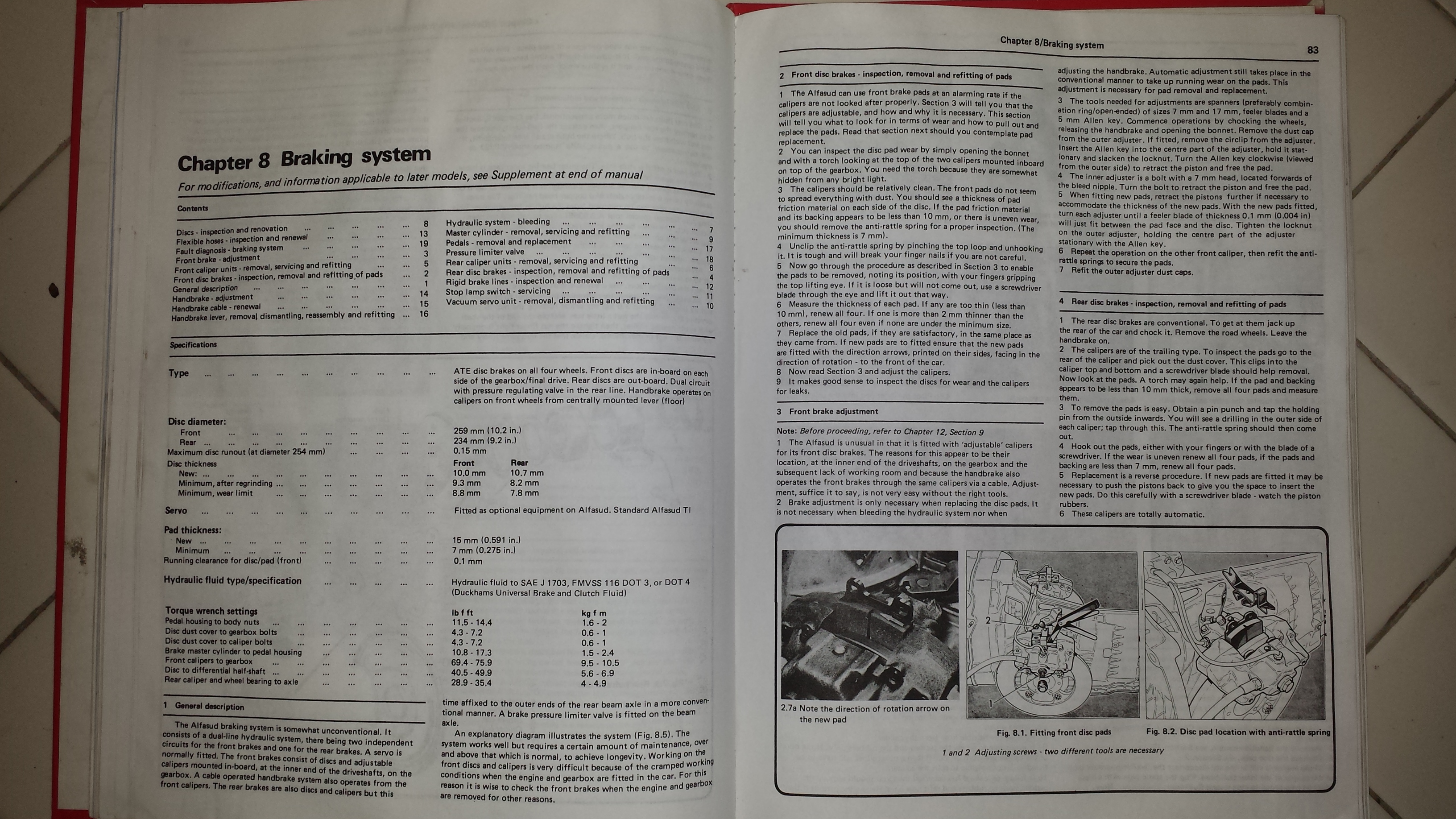

If you want, I have the repair manual. There might be some good info in there.
Valy
post Feb 11 2016, 06:30 PM
Posts: 1,677
Joined: 6-April 10
From: Sunnyvale, CA
Member No.: 11,573
4 speeds
Valy
post Feb 11 2016, 06:31 PM
Posts: 1,677
Joined: 6-April 10
From: Sunnyvale, CA
Member No.: 11,573
5 speeds

Brakes 1
Valy
post Feb 11 2016, 06:36 PM
Posts: 1,677
Joined: 6-April 10
From: Sunnyvale, CA
Member No.: 11,573
Brakes 2
Valy
post Feb 11 2016, 06:37 PM
Posts: 1,677
Joined: 6-April 10
From: Sunnyvale, CA
Member No.: 11,573
Brakes 3

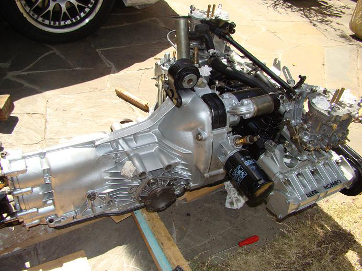

Alfa Romeo Flat-4,ZF-transaxle-5 spd.
