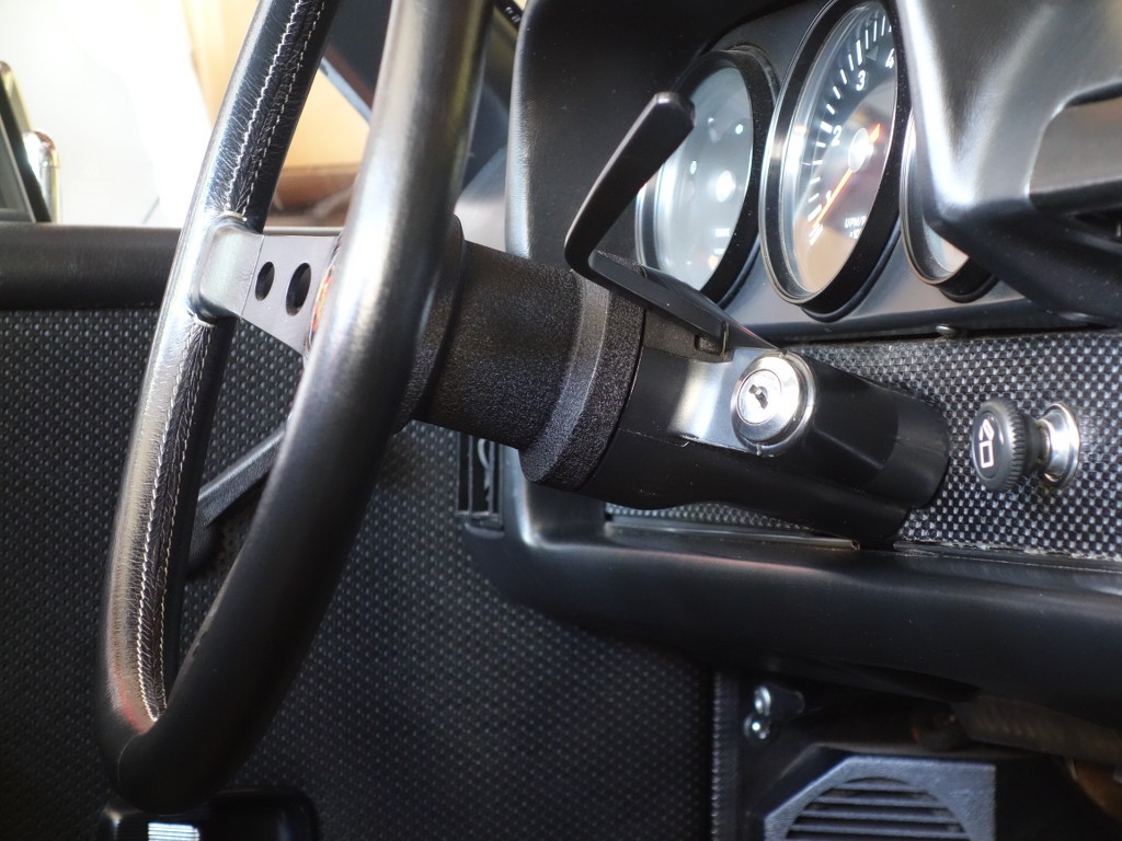

Late '73 column ...
(IMG:http://www.914world.com/bbs2/uploads/post-12234-1397330186.jpg)

QUOTE(dlkawashima @ Feb 13 2016, 02:40 AM) *
Thanks Guys,
Yes, this is the one I have.
So it looks like I was ordering the accordion style , but was sent to older style.
At least I know whats going on.
Will keep what I have, from the pics the fit looks like it will be good.
Just need to work out how to get the horn working.
Cheers
Dale

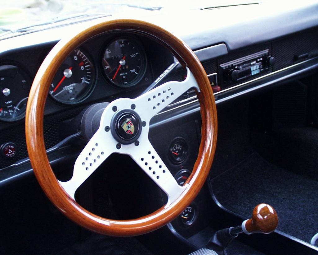

steuspeed
post Feb 15 2016, 04:40 PM
Posts: 1,011
Joined: 12-July 11
From: Portland, Oregon
Member No.: 13,308
I have the smooth hub too. I like it better. It's a real clean look. I think I used a modified brass tab to connect the horn button without cutting the harness. The ground should flow though hub. The momo horn button should be a snug fit.
