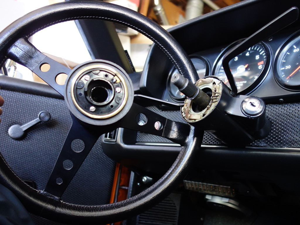

dlkawashima
Late '73 column ...
IPB Image

dale73914
QUOTE(dlkawashima @ Feb 13 2016, 02:40 AM) *
Late '73 column ...
IPB Image
Thanks Guys,
Yes, this is the one I have.
So it looks like I was ordering the accordion style , but was sent to older style.
At least I know whats going on.
Will keep what I have, from the pics the fit looks like it will be good.
Just need to work out how to get the horn working.
Cheers
Dale

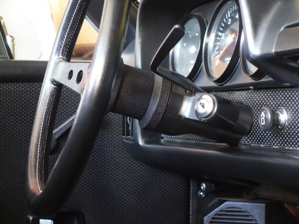

steuspeed
I have the smooth hub too. I like it better. It's a real clean look. I think I used a modified brass tab to connect the horn button without cutting the harness. The ground should flow though hub. The momo horn button should be a snug fit.
