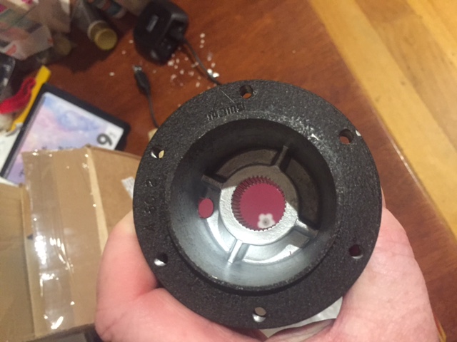

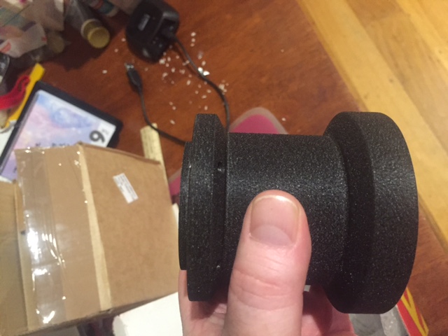

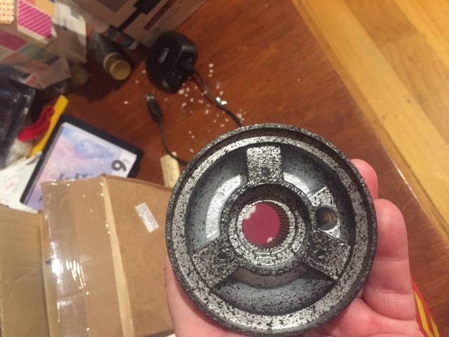

I recently purchased a Momo Prototipo and fitted it using a boss i bought ages ago.
I didnt realise until i unpacked it that the boss was very basic, had no signal cancel / horn components ( expecting me to disassemble and reuse the parts from my current wheel ), and was a bad fit around the column ( it left a 1/2 inch gap ).
Oh, and the horn button didnt fit as the boss nor wheel came with a horn trim ring.
So what to do, i jumped on ebay and bought myself a MOMO MC8002 boss, and going by the photo in the ad, i was expecting it to look like the one in the ad, trim ring, wider boss body ( even if it was just plastic around a metal frame ) , and going by photo's on the web, the cancel extension was cast in, and a trim ring supplied.
It turned up today, and im not sure if i have what i should have.
The boss that arrived is an MOMO A8002 and is very basic like my original one, expecting me to disassemble my existing wheel for parts... Not what i really wanted to do.
If all that is available is what they sent me , and the model numbers mean nothing, then fine, im not really happy, but what is...is....
If they have sent me a different ( older maybe ) version, then i would like to know, so i can email them and see what can be done.
The Momo one i have does have one plus over the crappy Isotta one i bought ages ago, the Momo horn button fits in the hole properly.

8002 is the part number listed for the 914. I do believe just looking at your pics that it is an older version however.

I was wondering the same, the pictures advertised are differnt then what 8002 version was shipped to me also. So which is the old model, the accordion looking one or the solid one ??
gms
post Feb 12 2016, 08:55 AM
Posts: 2,761
Joined: 12-March 04
From: Chicagoland
Member No.: 1,785
QUOTE(Coondog @ Feb 12 2016, 08:39 AM) *
accordion is the new version

(IMG:style_emoticons/default/agree.gif) The accordion style is the newer style, it is designed to collapse in an impact. Not sure how much better the fit or adaptability is.

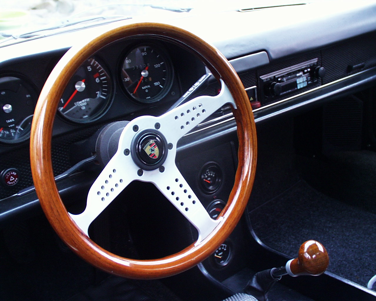

I have the smooth hub too. I like it better. It's a real clean look. I think I used a modified brass tab to connect the horn button without cutting the harness. The ground should flow though hub. The momo horn button should be a snug fit.

Steuseed- That is a beautiful steering wheel you have there.
