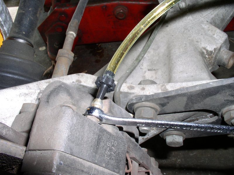

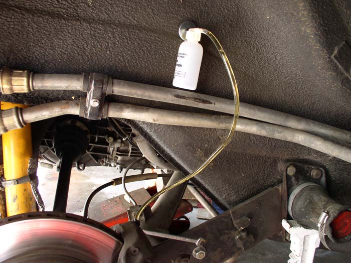

Bartlett 914
post Feb 18 2016, 12:11 PM
Posts: 2,218
Joined: 30-August 05
From: South Elgin IL
Member No.: 4,707
I like to bleed the brakes as shown in your picture. having the tube run vertical is very helpful. It keeps air from coming back into the system and allows better viewing of bubbles
