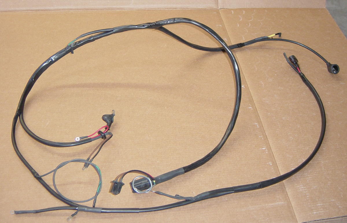

I have a 914/6 and I need some wiring help. The attached photo shows the engine compartment wiring harness (behind the engine) with a green wire that I do not know what it should attach to. I don’t have a wiring diagram. The photo is of the portion of the harness branching off from behind the engine to the alternator.

I don't have any green in that area. Can't tell from the pic, but if it's actually
green with black stripe, then that goes to the oil temp sender at the front.

[quote name='gereed75' date='Feb 24 2016, 07:06 PM' post='2307494']
[quote name='puffinator' post='2307448' date='Feb 24 2016, 05:57 PM']
What color wire is attached to your oil temperature sensor and where does that wire go?
Here is a pic from another world thread ( I knew I would find something - can you tell I am bored) of a repo harness but it is accurate and clear enough for these purposes. The temp sensor wire is a single very long green black striped wire that runs out of the harness on its own just after the big split of wires that go to the alternator.
Again, if you have a solid green it was spliced into your harness so no telling where it came from

#11 is Oil Temp, should be green with black stripe
