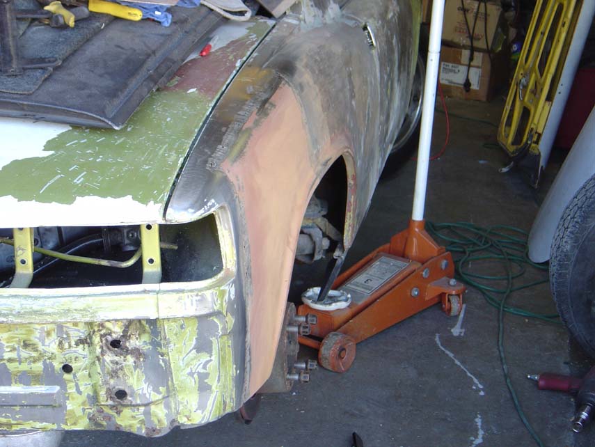

Well, despite what everyone said I cut out the badly damaged panel and welded in a new piece. I had the piece laying around and it seemed the right thing to use it for. Here are the results. Not too bad for my first time. Here is the spot cut out.

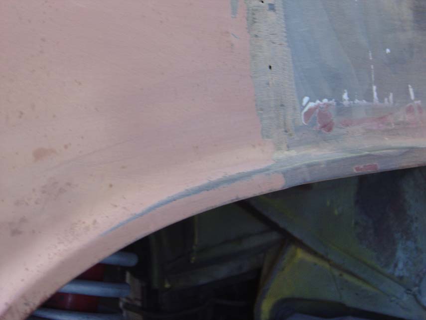

Here is the panel welded in. One low spot on the very rear top part of the panel. I will try hammer and dolly to get it closer.

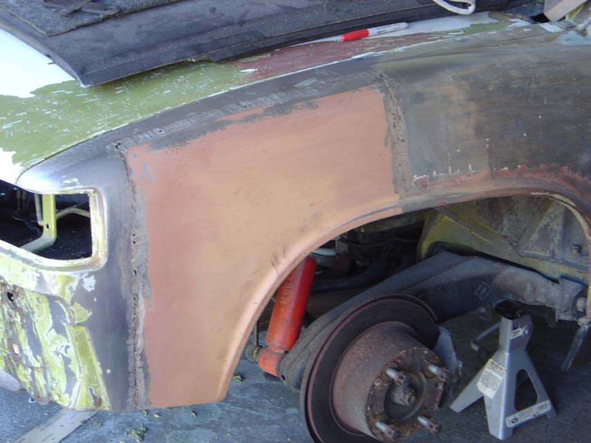

From the rear looking forward.

The part I was worried wouldnt come out right. Very nice. (IMG:http://www.914world.com/bbs2/html/emoticons/smilie_pokal.gif)
