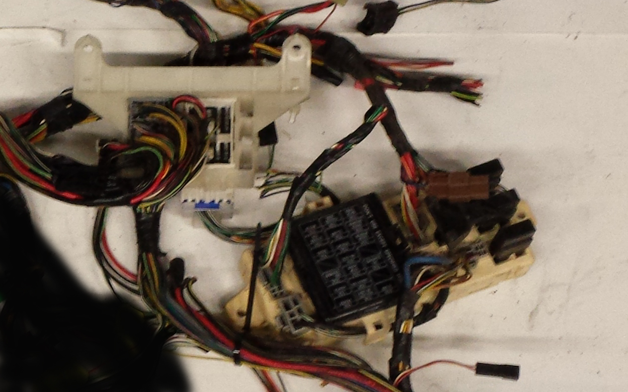

i cut plugs, 1,2 4. they are for abs, cruise control and ac. i believe. pic at bottom showing all 3 male side connectors on car.
my biggest question is all the wires that go thru these two big junction boxes and which ones i can cut. especially the one with 2 smj's on it. i could use a pin out for these 2 smj's.
looks like i can cut all wires to the smaller one as it is labeled - power windows. ??
it is hard to parse loose wires when they are running thru an smj. i may cut all and tape them together, parse loose ones, and the solder the remaining needed ones.

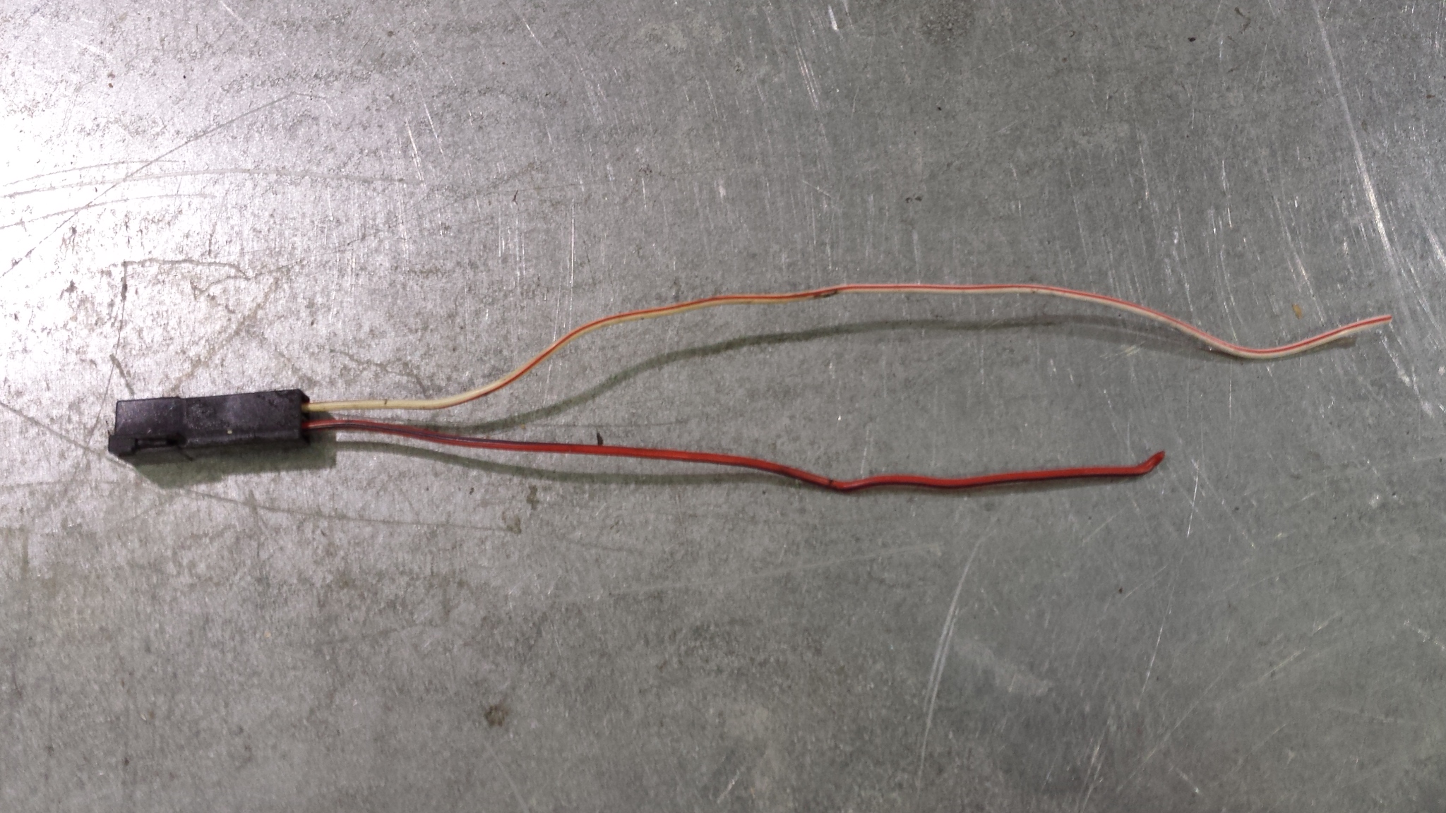

You need this to understand how everything works. One CRITICAL thing you can't remove is the diode. The car won't start without it. You end up cutting most of the harness the way I did it. You do use the fuel pump relay, starter relay from the Subaru. And of course the whole engine wiring harness.

Best thing for the early 22ej is the keneddy wire diagram. It's hard to point out on the pic but basically track the wire from the computer to the plugs that conect to engine or tac,started,ect. Do not take out any diodes in the harness!! If posable have the diodes some ware you can pull it. The car should not start without the diode, one more layer of theaf proof. (19 I think?)
The subaru relays for the fuel pump and the one next to it are keepers as well.(the metal bracket between 3-5 holds them) The dash plugs (10)- (12)can go. There are a couple wires to splice together from that plug.
(22) is also not used.

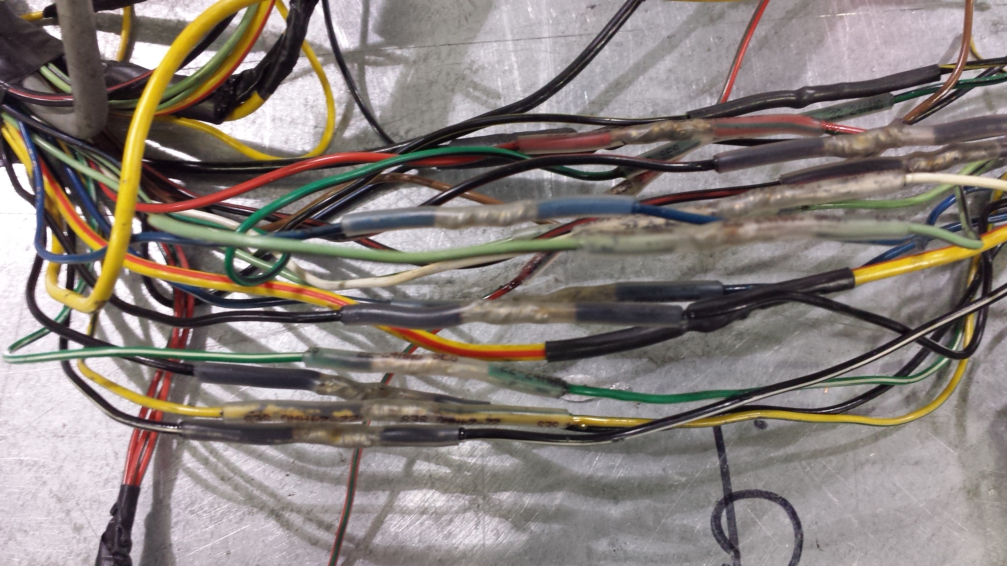

1990 legacy 5spd
here is some progress, lots of wires removed, and some identified. i also botched up a few things, hope all are repairable.
>>> my worst botch was cutting or disconnecting one of the engine plugs nearish to the ecu plug. these wires have one unsheathed wire (IMG:style_emoticons/default/blink.gif) and one seems to missing a red wire.
>>> such as where to wire in diode, i tried to keep it attached but then somehow it was gone and in my loose wires box. (IMG:style_emoticons/default/dry.gif)
i cut thru fat alt wires (IMG:style_emoticons/default/sad.gif) (* will just run a stand alone wire from alt to battery & wire up dummy light and guage later)
i also have a lot of soldering due to the bigger smj, and its wires i cut assuming most would be trash BUT most seem to be staying (IMG:style_emoticons/default/idea.gif) (* soldering done at this location for these many wires)
there is more but i think i made some good progress regardless.
jim

Yep, you HAVE to find where that diode goes and put it back where it was or the car will not start. You can actually wire the alternator directly to the battery using a new fatter wire. Check my thread and see how I did it.

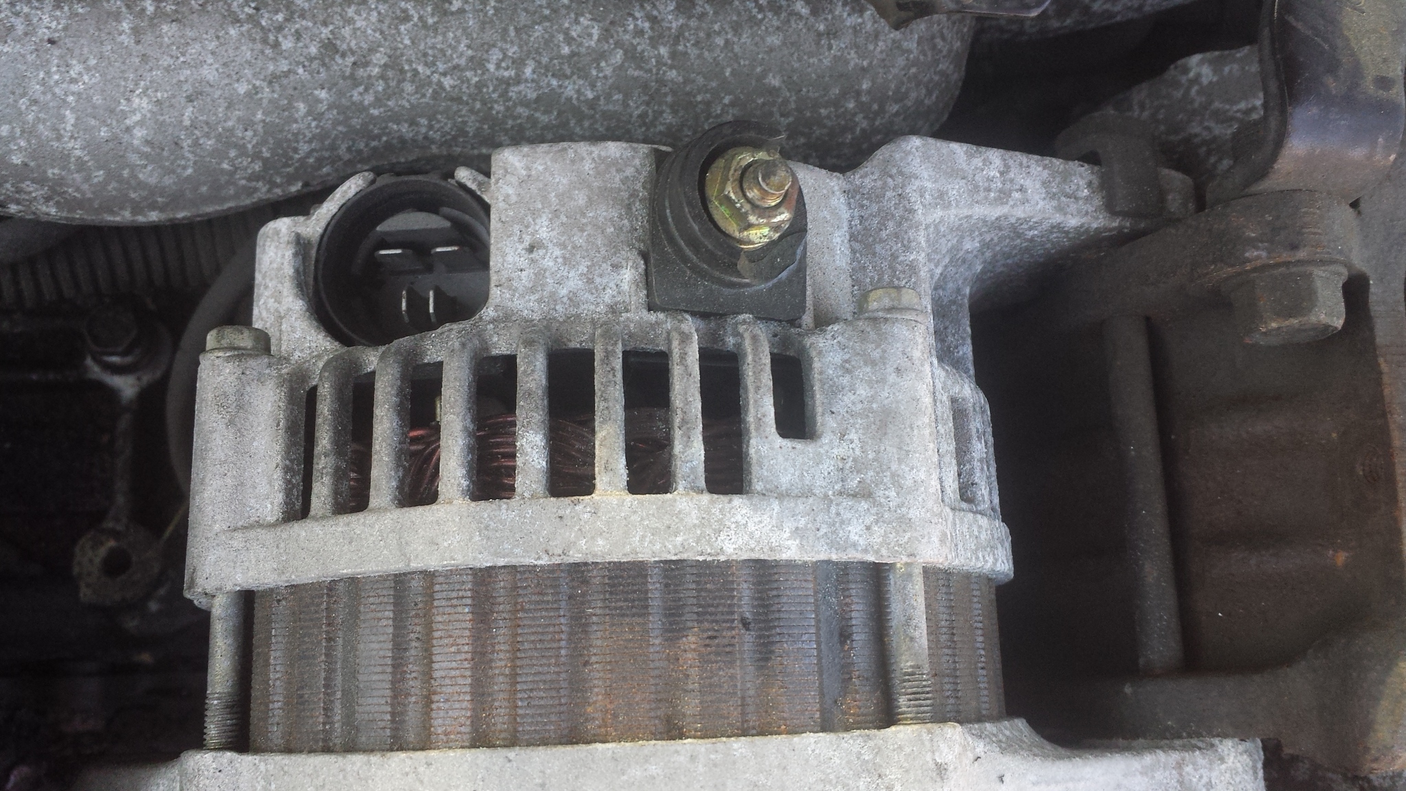

chris,
thanks and i see your alt wire pic. are you not using the other wire bundle (red connector) that connects to alt, that gives ecu, alt power info?
jim
(IMG:http://www.914world.com/bbs2/uploads/post-73-1444878381.jpg)
jimkelly
post Apr 14 2016, 08:34 AM
Delaware USA
Posts: 4,969
Joined: 5-August 04
From: Delaware, USA
Member No.: 2,460
so one fat wire from alt to battery.
the other plug on alt is for dummy light and guage.
one problem conprehended (IMG:style_emoticons/default/biggrin.gif)
thanks jeff

Member No.: 2,460
if this is a pic of diode on precut harness, its wires seems to run to one of the engine bay engine connectors. i should be able to verify tonight.

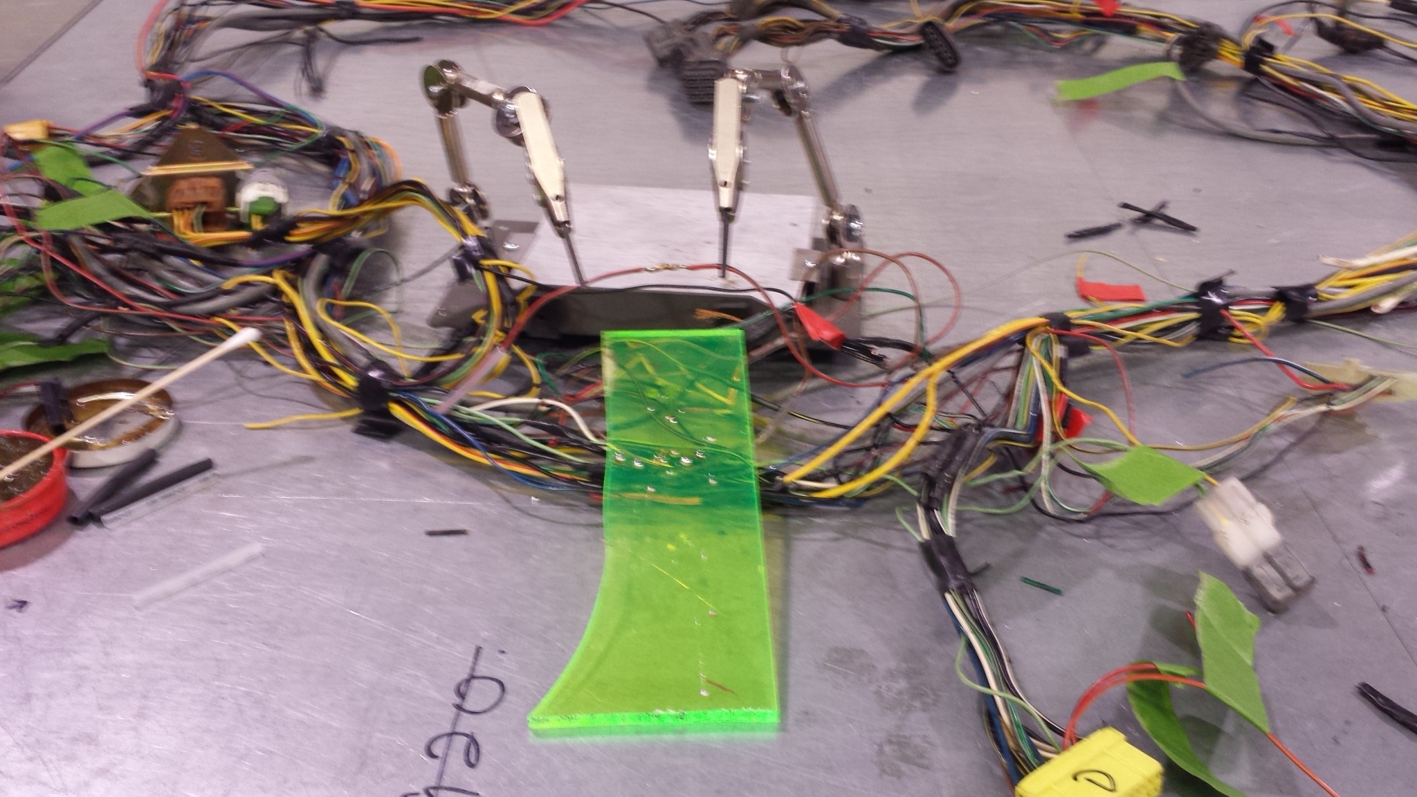

a little video on how to solder 2 wires together. i got a bunch to do tonight. no mention of flux?
https://www.youtube.com/watch?v=Q9G9gaokqvM
76-914
post Apr 14 2016, 09:17 AM
Posts: 13,968
Joined: 23-January 09
From: Temecula, CA
Member No.: 9,964
Resin core solder doesn't use any other flux. Jim, your going to be soldering alot and I would highly recommend that you get one of these. http://www.harborfreight.com/helping-hands-60501.html . Not so much for the magnifier but to hold your solder joint steady as it cools. If your solder joint moves before it is cooled you will have a "cold joint". Not good. A good solder joint will be shiny. A cold joint will have dull finish.

most wires i cut at smj soldered back up. gonna sit back down with harness to find the two wires for diode to connect to.
